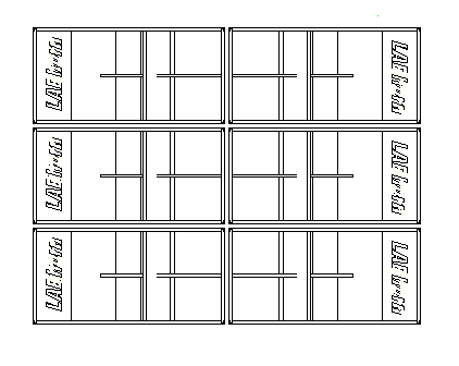

I did the math ... the back chamber is 21 liters less the driver volume. I would guess the driver volume to be 2 liters.
Closing the 7 inch baffle spacing to 6 inches and replacing the two piece baffles with one piece .75 inch thick baffles, would increase the compression
ratio from 2:1 to 2.35:1 and increase the back chamber by 2.7 liters. This would require a redesign of the horizontal flare panel, but that's elementary.
Would anyone be interested in building this mod?

I might be interested in that mod as long as there's still enough space to do my mods too - flipping one of the drivers around and connecting the back chambers. I'll have to do some more modelling but I suspect we can probably take great liberties with the first few inches of the horn with little consequence.
I wouldn't attempt this mod unless someone else was going to redesign the flare though, since I can't design a complex flare like this one.

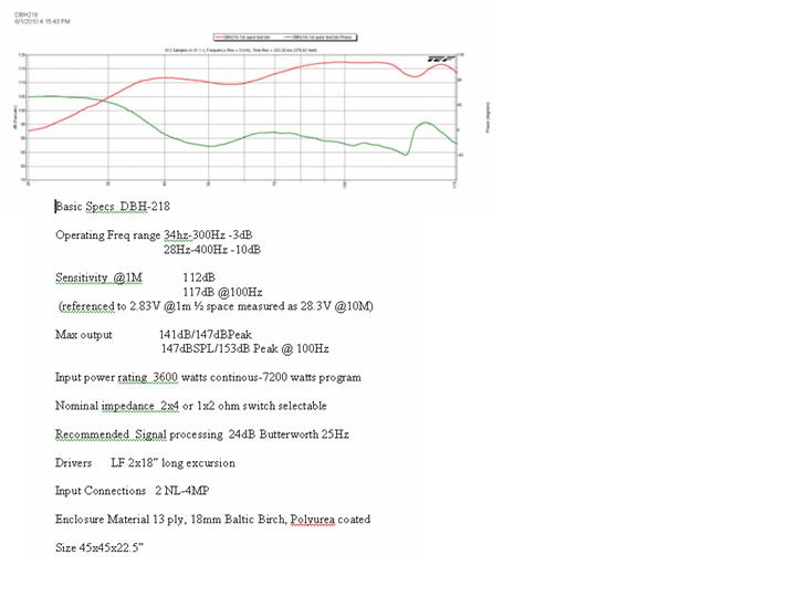

I've never heard of it but I'd like to. A quick search didn't reveal much, probably since I don't know exactly what to look for. If it's significantly larger than the Labhorn I'm not interested in building it but I'd still like details.
Here ya go, DBH-218
It is a "regular" bass horn. Not a Tapped horn.
Like Art says-it is the same size as a Lab sub-but with a lot more "get up and go".
I have not listened to it a whole lot, but the target market is the kick drum slam market. It does have a bit more "punch" (here we go again with the "terms" Rolling Eyes Laughing ).
--Ivan Beaver
And it has a lower and smoother low freq output than a lab sub.
The DB218 is a "normal" bass horn-so when you add more, the extension and smoothness will get better.
--Ivan Beaver
