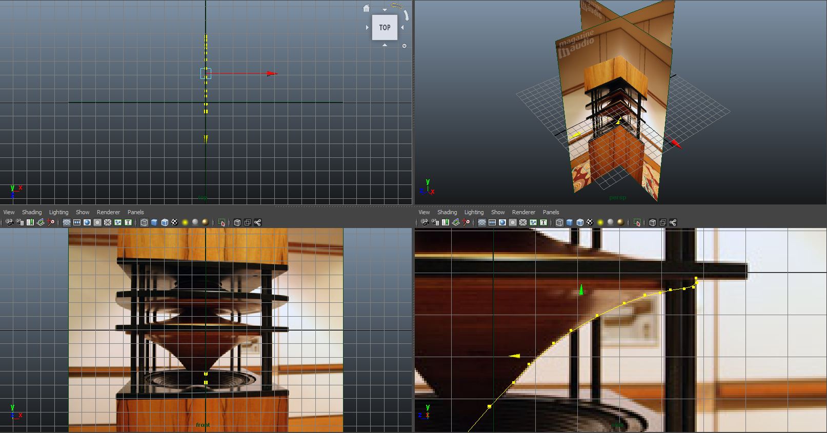

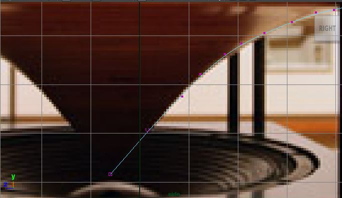

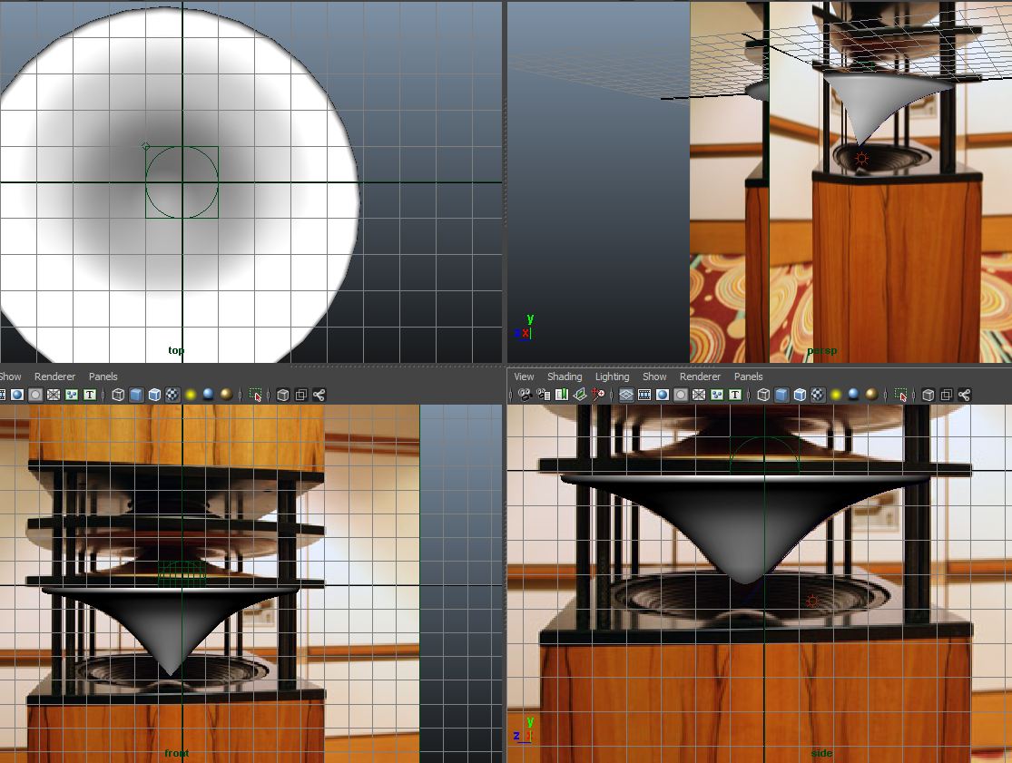

modeling the cones
I couldn't find any details for size of the cones.
In matter of fact , I couldn't even find a good picture for the cone - so i be able to take relative sizes ...
So i thought about some way to do it...
Modeling it with MAYA (3d software):
Basicaly I locate a the best picture i was able find in 2 views -fornt and from the side.
I drew lines accros the cone , made adjustment from both views using the lines vertex.
And then revolve it.
I attached some pictures .
If some1 have better picture it could be even more accurate ....

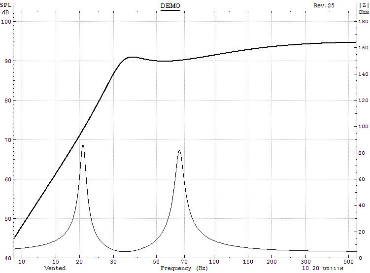

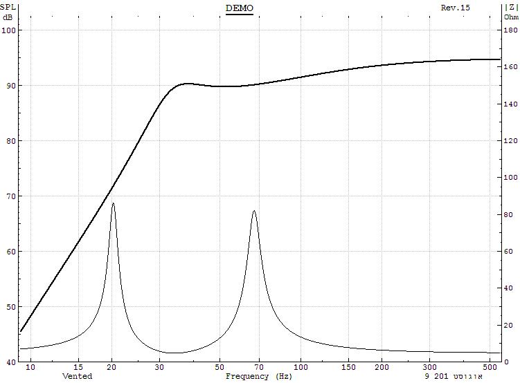

For the lower box , Im planning to do it 70-75 lit.
See attached- graphs for 70 and 60 lit design with woofer and port 40*100 mm...
What do u think?Should i go for bigger box?
Is the box calculations are the same for reuhlar box (when the driver location in the front)?
Thanks a lot!!

Hi avico78,
Just to be clear on things, I am no expert on the suitable driver. Only commented that full range speakers are not suitable, since you can't adjust the balance between mids and highs. I reckon, your tweeter is prob ok as long as it is possible to adjust the level.
Oon
