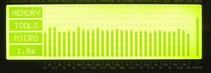

Why don't you try it. You are using random noise not a sine sweep. Here's how my 4344's look with the room effects in an RTA measurement. Really easy to set the levels using it.

When you say you have never had success by mic? What do you mean? I love running ARTA (pink noise) to get my room curve the way I like it. It correlates what I like to hear back to data.

You were looking for information regarding the forward sloping equalization curves in the Linkwitz link. About ¾ to 7/8 of the way into that page there are graphs showing his final setup. It has been several months since I set up my attempt but I recall the struggle setting up the Behringer 2496 RTA equalizer. I was ticked off at the sound when it was set flat. I went back looking at the Link and said Ah Ha I see when I saw the slope of the curves on his page. The OB’s I have set up are mounted on 2’- 0” X 4’ - 0”sheets of Baltic birch plywood, bottom is a pair of 10” Audax 10” woofers Q = 0.61 mids are Vifa’s, tweeters are also Vifa. The crossover points are 300 and 2500. There is a line level output 75Hz and down routed to a sealed sub-woofer much like a Thor.
(see THOR - subwoofer ).
Truth be told I rarely turn on the sub, bass is solid without it, thunder with it.
As far as bass loudness adjustments go I have several equalization curves saved in the Behringer digital RTA.
