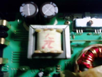

Sorry... "power supply" probably wasn't specific enough. Attached an image of the part that seems to be making the clicking... the big square thing whatever it is... heh :confused:

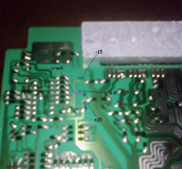

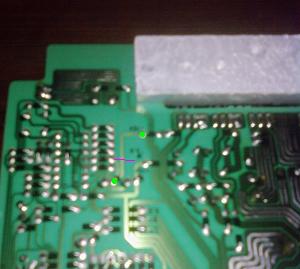

Thank you for the replies Perry. :) I was about to break apart a working MRV-T500 and start comparing things with the multimeter but first I thought I'd have another look at the one with the issue and I think I found the problem... a little crack on the board. I looked over it forever before I noticed it since most of my attention was around the inductor and this was on the opposite side. Posted some pics... sorry they kinda suck. Any suggestions on how to fix? Thanks!! :spin:

Yeah I was worried about the crack running. It's not visible from the other side though, buuut as you said it's coming close to another trace. The second pic of the crack is a more accurate representation of the actual line. I think it starts at the solder joint on the left side. I plan on using this in the home though where it shouldn't be very stressed so I'm hoping it will be fine as is... *crosses fingers* maybe I'll just drill it out... another good idea. Thanks again for the help guys! :)
Well damn, I drilled it and bridged the connection... all went smoothly... no more cutting off but it still has the clicking... :confused: grrrr heh. Seems better though... sometimes goes away completely. Also there WAS a couple other joints that looked cracked possibly. On the big round coiled thingie next to the inductor... two of them right next to each other. I dunno what I was thinking. I should have just touched them while I had the iron out and amp apart... doh... it wouldn't have hurt. I'll have to do that........
