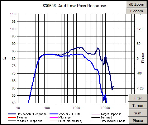

See the attached figure for the effect of the filter on the woofer response: the peak is almost flattered, and a little off-axis vanishes.
Does anyone know why you cannot just take into account the baffle step loss in the L-pad instead of making the BSC filter?
The baffle step effect is in the range 100-1000 Hz, depending on the baffle, so it alters the woofer response. You lose 6dB on the lower end because of the fact that the driver radiates in a 4pi space, whereas on higher frequencies it will radiates in a 2pi space (i.e. only in front of the baffle). Again, the attached figure shows the effect of the baffle step on the driver response (look at the infinite baffle response at the Zaph site). The main inductor of the filter here works not only as a low pass, but also reduces the baffle step effect.
