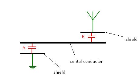

The problem that I see with this is that if the shield of the coax is not connected to ground at either end it essentially becomes an antenna that is capacitive coupled to the center conductor. With the coax shields greater cross sectional area it will pick up more RF than a wire the same size as the center conductor and transfer the RF energy to the center conductor. This I think would make you more susceptible to RF than an unshielded 22awg wire.
Oh, and two wires not touching each other is basically the description of a capacitor.
(two conductors separated by a dialectric)

I have never thought it that way, It is like having a transmitter microwave dish radiate backwards? It does not make sense to me if comparing it with a dish, but your acquisation is completely right for longer wavelength RF. The shield becomes an antenna which picks up RF and capacitivelly couples it to the internal conductor.
Although for microwave frequencies it may actually repel RF, as any metalic object acts like a mirror for microwaves either connected to ground or not. Also, this coupling capacitor behaves like a high pass filter which cutts-off completely the lower frequencies if the capacitance is too low.
Combined these two effects (cutt-off for low frequency RF, and mirror for microwaves) should give the desired result of moddest shielding, although one should use low capacitance coaxial cable to ensure higher cut-off.
Does it make sense?

The amplifier is direct coupled to the speakers and it is this design: http://www.audio-constructions.com/monstre/Hiraga-Monstre-Monster-Class-A-amplifier-schematic.png
The central conductor of one coaxial is the positive going from the amplifier to the speakers.
The central conductor of the other coaxial is the negative going from the amplifier to the speakers.
Both shields of the coaxials are left unconnected.
So we have no shunt capacitance from positive to groung (let's ignore the air dielectric etc)
But as a previous member states, the unconnected ground acts as an antenna. It collects RF and couples it to the central conductor through the dielectric of the coaxial. This is ANOTHER capacitor (not shunt)
If we use the standard coaxial way we have capacitor A
If we use the proposed coaxial way we do not have A but we have only capacitor B
But at microwave frequencies capacitor B is not formed because the shield reflects the RF even if it is not grounded, like a dish reflects microwaves.
At lower RF frequencies capacitor B couples RF energy to the cable, but It also behaves like a HPF, if the dielectric of the cable has low capacitance and the length of the cable is kept low. What is the cut off, I do not know..
