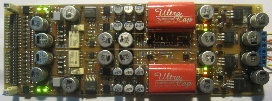

And here's probably the last in the HPS series.

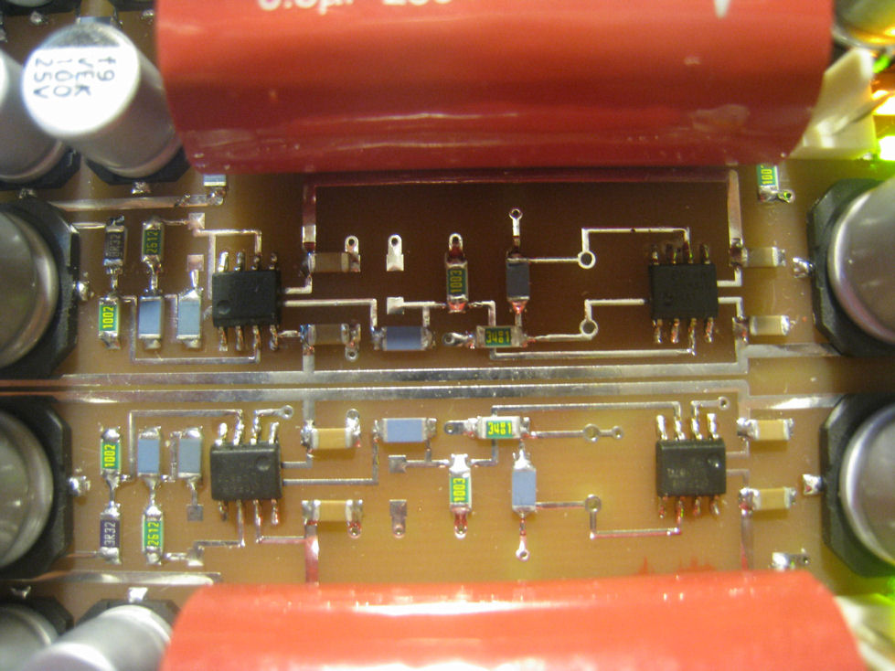

HPS 5.1 is built on the same foundation as HPS 5.0, using the same SMD technology (which, by the way, I find much easier to work and rework compared to through hole; the flip side is the rather high cost of good quality 1206 SMD passive components).

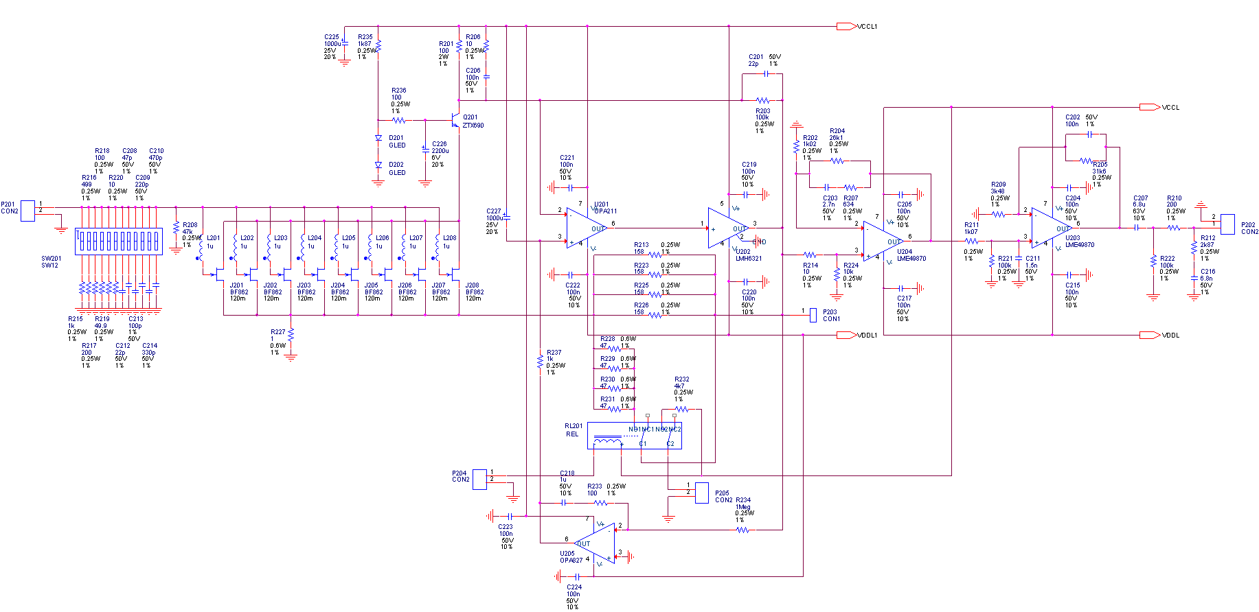

There are though some significant improvements. The head amp follows the same simple architecture, an ultra low noise transconductance stage, followed by a high gain transimpedance stage and a servo, to allow DC coupling to the output. The LF open loop gain is still gm*R203 (see HPS51.png), where gm is the tranconductance stage gain, approximately 2*Id/Vt, where Id is the total JFETs drain current (~90mA) and Vt is the BF862 pinch voltage (~0.8V). However, the low noise stage is now cascoded using a low noise ZXT690 power device. The JFETs Vds is about 3V. At this voltage, BF862 does not have any hot carrier injection noise. The cascode reference (~3.6V) is provided by two LEDs, decoupled for low noise by a large electrolytic.
To greatly improve the input stage PSRR, two changes were made. First, the lead-lag compensation network R206/C206 is now connected to the positive supply rather than to the ground. At the same time, the non inverting input of the transimpedance stage opamp is now decoupled to the same positive supply by C227. The net effect is that, for a rather large frequency range certainly well below and over the audio range), the AC voltage gain of the transimpedance stage is very low; any noise or other perturbations appear as common mode for the opamp, and therefore they are rejected. A PSRR of ~-50dB is obtained.

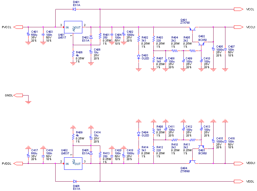

This, coupled with the same noise cancelling power buffer (using a Sziklay current feedback series regulator, that greatly reduces the equivalent Rbb of the power device, see HPS51-PS.png) leads an overall PSRR performance comparable to HPS 3.1 and HPS 4.2, but with a much simpler solution.

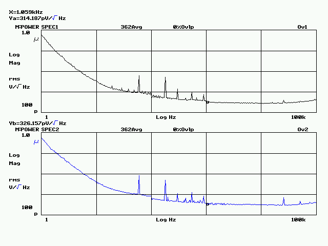

This is obvious when looking at the noise performance (see HPS51-noise.png). While HPS 5.0 had the 60Hz harmonic noise rather on the high side, HPS 5.1 has not more than 8nV equivalent input 60Hz noise, which is excellent. The 60Hz harmonic noise is actually not injected from the power supply, but from the magnetic coupling with the environment. The overall noise is around 0.3nV/rtHz and the corner frequency is typical for JFETs, some 300Hz.

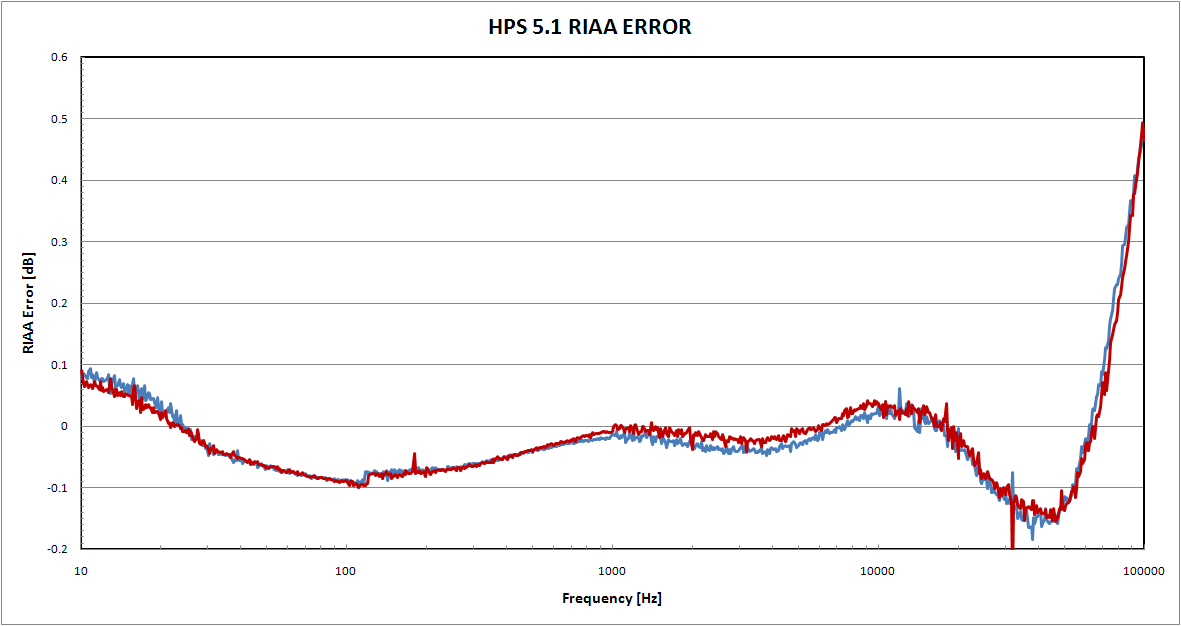

The RIAA stages are identical with HPS 5.0, and so is the power supply. The measured RIAA precision is attached, it is under 0.1dB to well over the audio range, see RIAA.png below. The opamps are the National LME49870, supporting +/-22V. As usual, the Neumann pole is implemented. I chosed to avoid implementing a high pass 20Hz rumble filter in the preamp, this can be externally attached at the output.

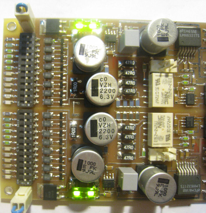

The head amp gain is switchable via a NEC low signal relay (one of the best I was able to find, actually slightly beats the Panasonic devices) for a total of 60dB (MC) and 48dB (MM). Switching the head amp gain actually preserves the dynamic range of 32dB when switching to MM.

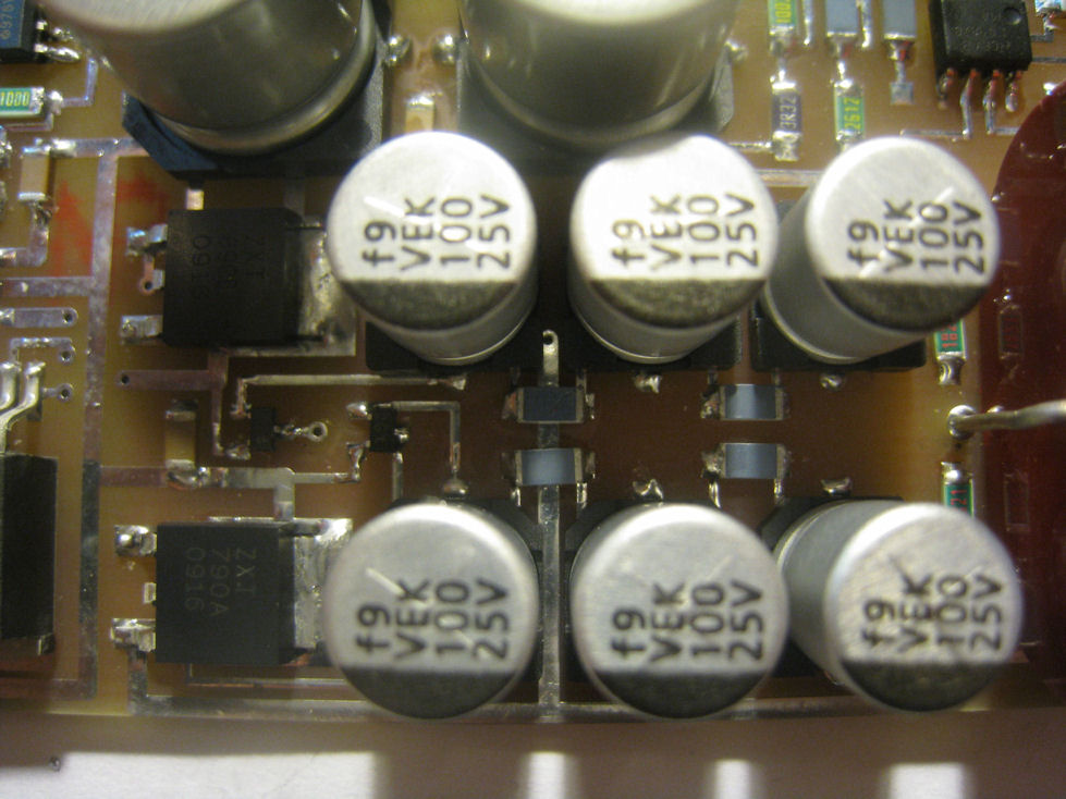

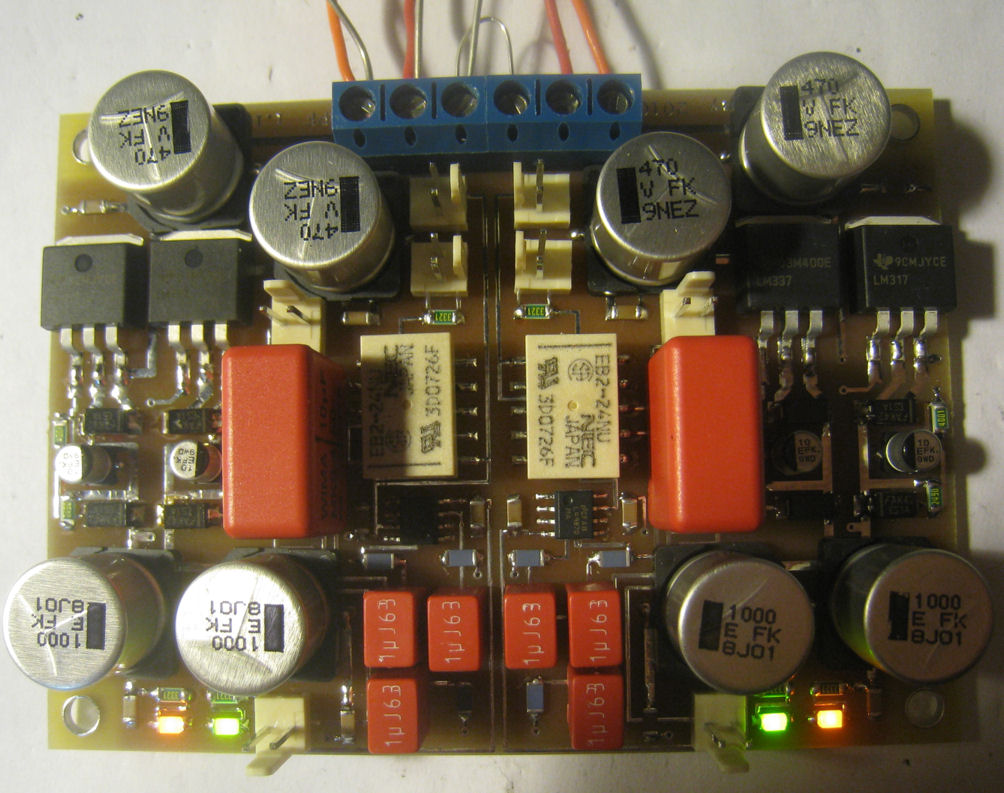

Some pictures of the construction are below (HPS51.jpg, HPS51-IS the head amp detail, HPS51-PB.jpg the power buffer detail, HPS51-RIAA.jpg the RIAA stages). The Gerbers will be available for free on my web site, as soon as I'll find the time for an update.
EDIT: if anybody is wondering, HPS5.1 and HPS 5.0 are 100% hand soldered using a Weller fine tip and 0.5mm zero residue flux 63/37 solder.

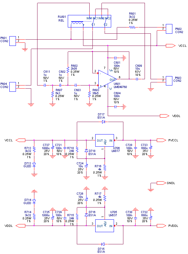

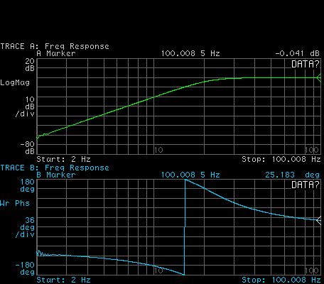

EDIT: there's one thing that I'll add soon: a rumble filter. While this can easily be integrated with the entire preamp, I prefer to build it as a separate module, that can be inserted (or bypassed) at the HPS output via low signal relays. It's essentially a 20Hz 3-pole (60dB/decade) Sallen-Key high pass filter, built around the same LME49870 high voltage opamps (to conserve the entire dynamic range).
Done, works as expected. A 3rd order Butterworth 20Hz high pass filter, provides a group delay of under 20mS, so it's not affecting the low frequency response (according to the most demanding subjective tests, see Holman et. al.), while providing a 60dB/decade attenuation. Arm resonances, DC output flickers, etc... are greatly attenuated. Schematic (filter plus power supply, one channel only) is also attached.
