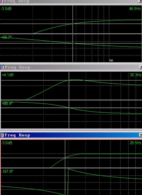

I got it like that applying the a linkwitz transform right from winISD EQ section, with the optimal parameters suggested by winISD itself, which are based on the thiele/small parameters of the simulated driver + box volume. Is it very ugly? The peak around 100 Hz is only a couple of DB above "flat" so I tought I don't care too much hehe, I'll try to get a flatter response by tweaking the parameters anyway. Thanks
The reason I like heavy cone is the voice coil is heavy also if it is wound with copper. Cone mass and voice coil assembly mass should be about the same for best coupling. Also a heavy cone is a thick cone making the cone more rigid than the thin aluminum cone. The aluminum cone has higher propagation velocity which is a benefit. As long as the Q in the box is .577 or less (I like .5) then results can be pretty good. - but this is all speaker design theory
1st graph Q box = .5 Fb= 30Hz -3dB at 46.5Hz
2nd graph Q filter = 1.6 Ff =30Hz +4dB at 30Hz
3rd graph system output -3dB at 28.5Hz
More EQ can take it as low as you wish to go until excursion limit is reached. There are other ways to EQ which do not use high Q filter. Of course electronic filter. If it is a dual voice coil there is always the watkins woofers system (watson?) like infinity.
