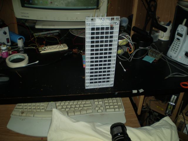

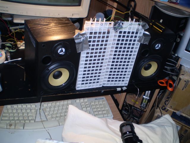

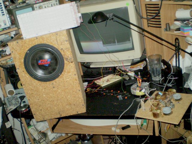

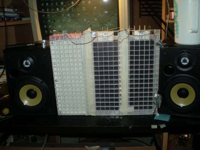

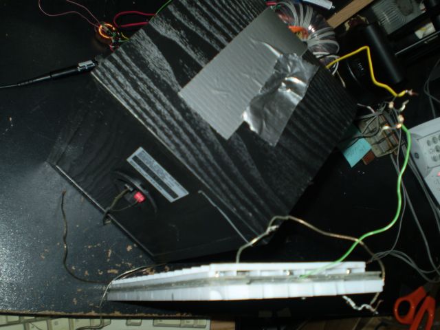

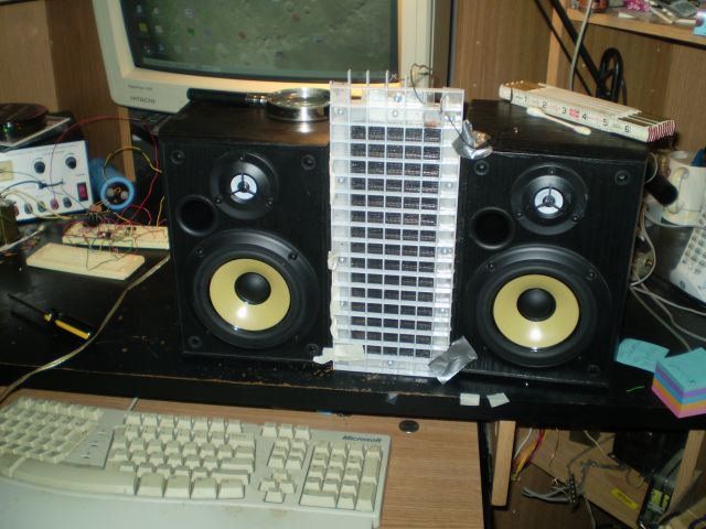

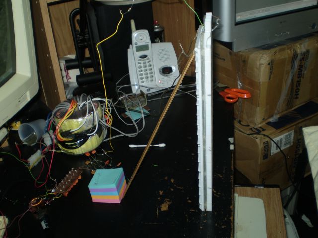

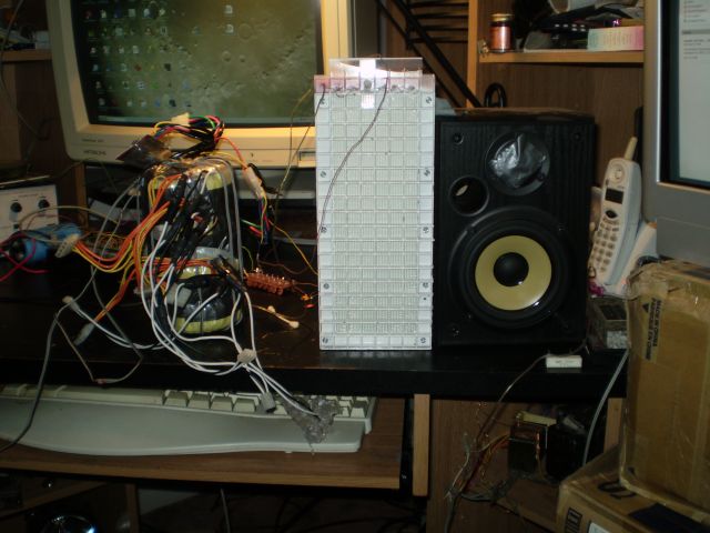

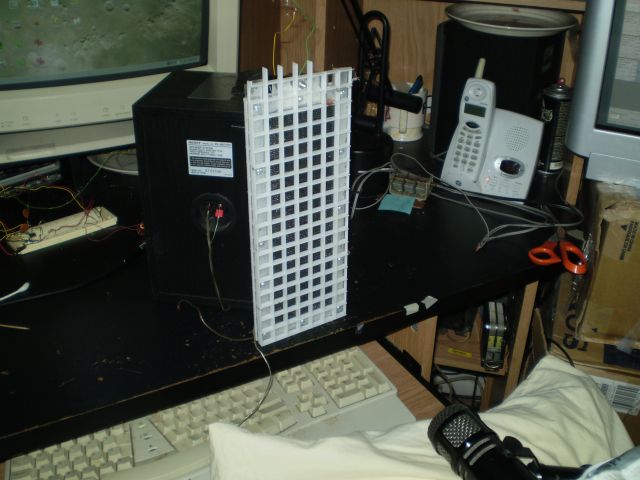

Here are some pics of different configurations.
And not a one of them sounded bad by any means at all. jer

Nice to see genius-at-work pictures!
Where-from are the white plastic ESL frames? Background and sources on other pieces would be nice to learn too.
Thanks.
Ben

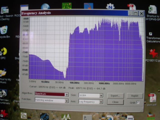

thanks,Ben,The frames where from menards a home depot and lowes type of store.
The subwoofer is a radio shack PRO-CSW800 8".
I got 8 of them for $15 a piece when they discontinued them.
It is in a .65 cu.ft ported box tuned to about 28.5hz.
The group delay is very low with this configuration.
I have measured a THD as low as 2% to %5 from 100hz to 30hz respectively and is good up to about 1000hz to 1200hz.
IMO pretty impresive for a little 8 incher.
The microphone is a Peavey PVM 520TN.
I have been using audacity software as a sweep generator and spectrum analyzer ,it's free on the net and it is simple to use and works very good aswell.
The little speakers are sony SS-MB150H I got 4 pair of these for $20 a pair at radio shack aswell.
You can see the old marantz crossover that I was using in the first picture and the transformers I got as a clearence deal for $20 a peice at parts express,I got 10 of those and wish I had gotten a whole lot more when I still had the chance.
They are 35V 5amp toriodal and are the ones that I have been Experimenting with to drive the esl's with.
As you can see the quadstacked in the second picture and the doublestacked in the fourth picture.
Behind all of that mess you can see bits and sections of my switching type variable bias supply driven from a 555 timer. jer
