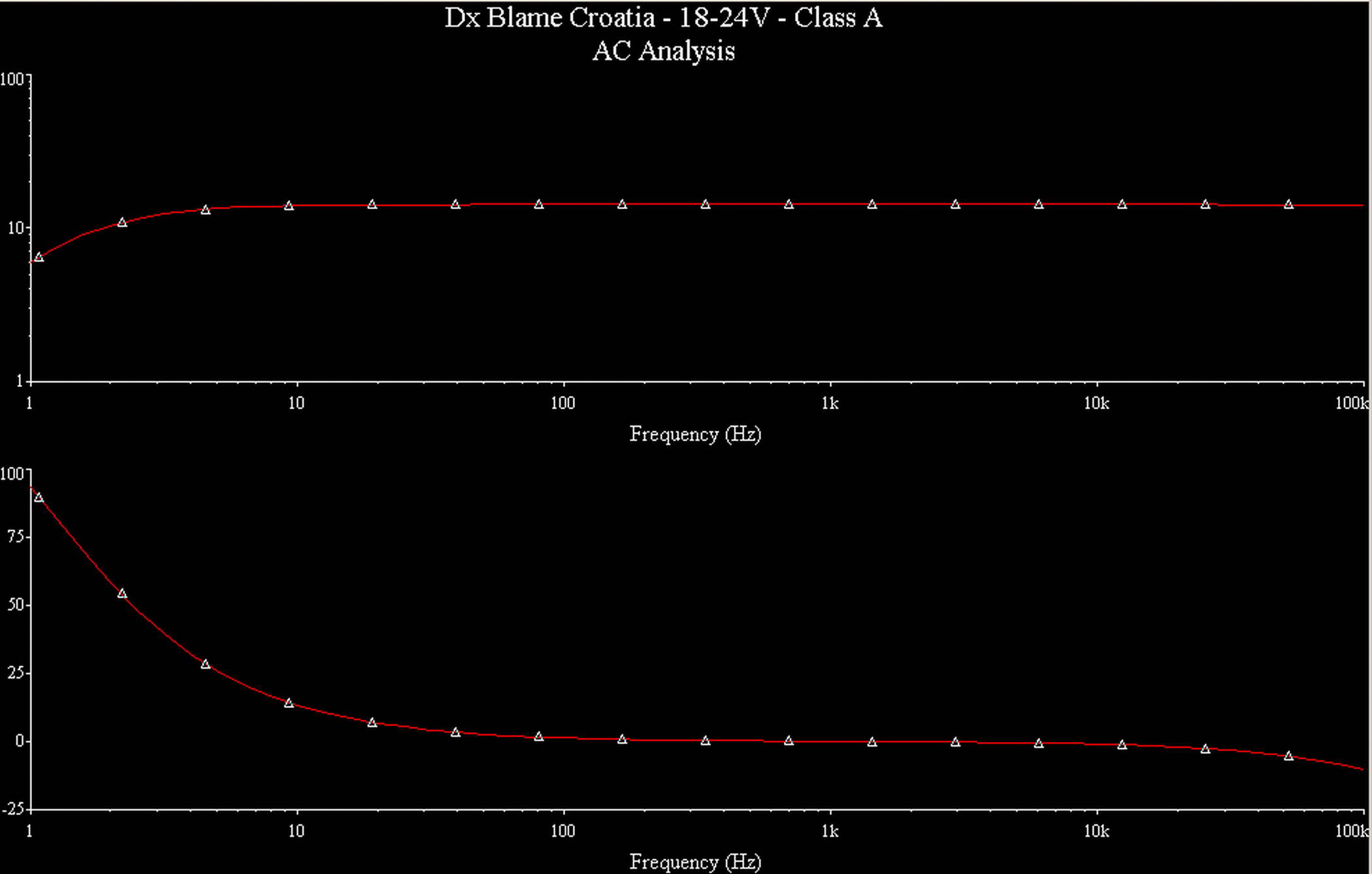

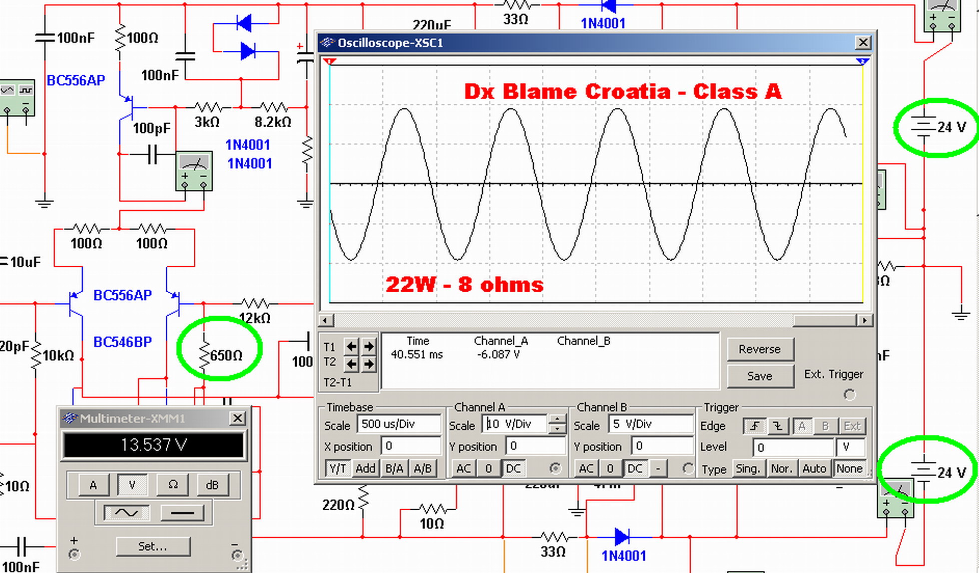

Dx Blame ST, operating from 18 to 24 Volts (unloaded) - Class A
You know, as i have commented i do not like Class A, my environement, climate, weather, temperature, is too much hot to use class a...also i already have oven to cook food.
They compress, they kill treble, they distort in a very ugly way (awfull clipping), they are very weak in power, waste a lot of energy..well...it is impossible to me to accept that...i do not feel confortable, also i do not feel myself as an inteligent man using these amplifiers.
Despite of that, i know people loves, also they do not distort, crossover
distortion is almost zero, and this turns the sound interesting.
I very good and old friend from Croatia has asked me..them i have prepared..but no way to me to build..for sure will work...as there's no reason to fail..circuit is clear, simulation shows enormous stability and very low distortion..lower than others.
It may be even better than the Dx Blame ST..for the ones loves low power and high heat.

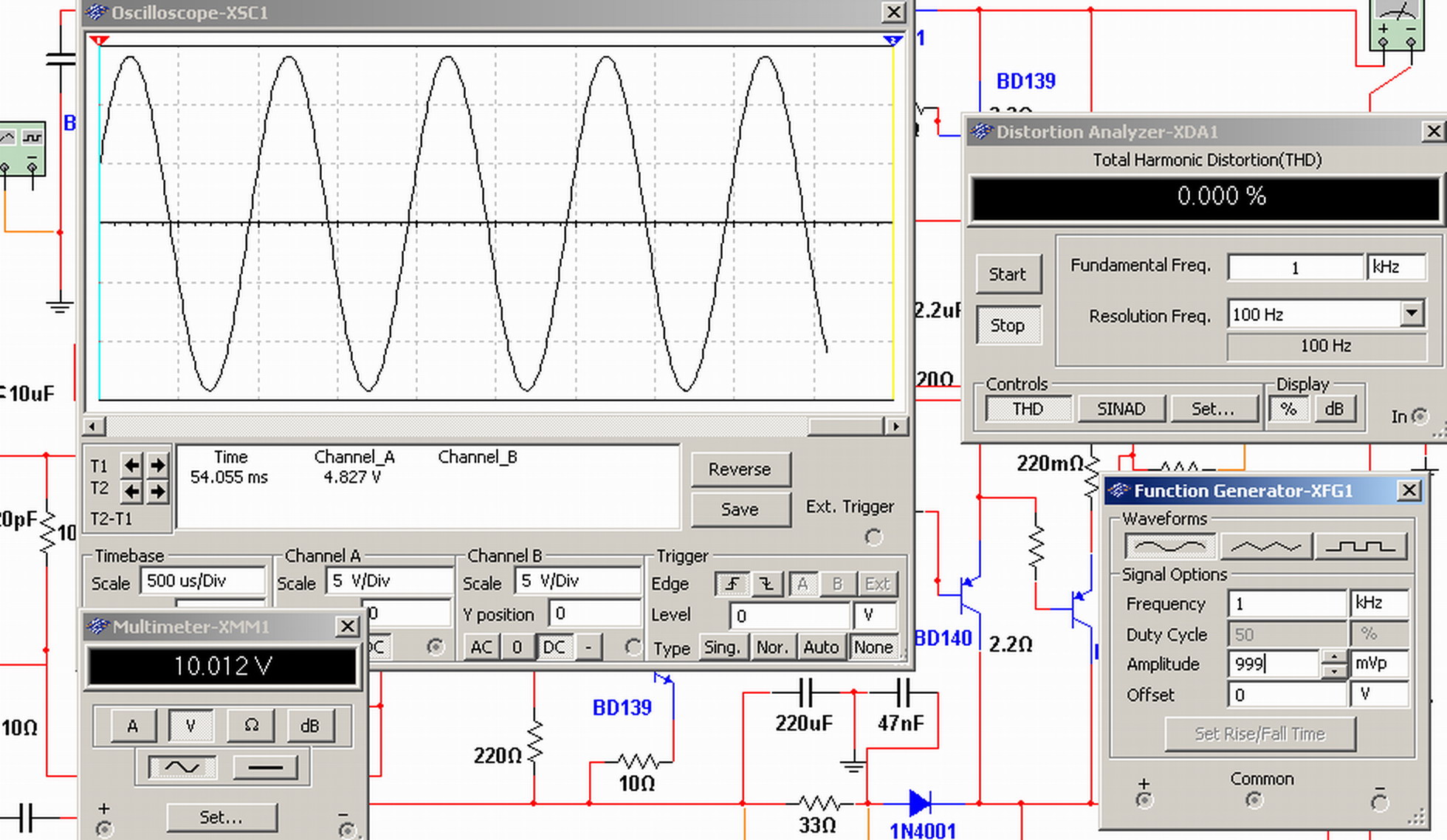

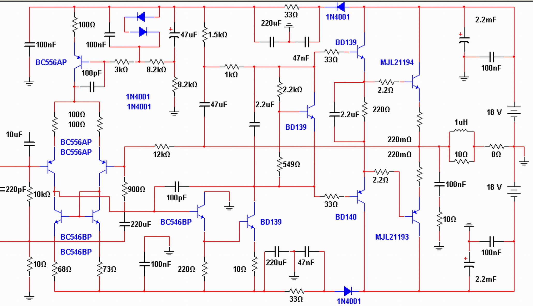

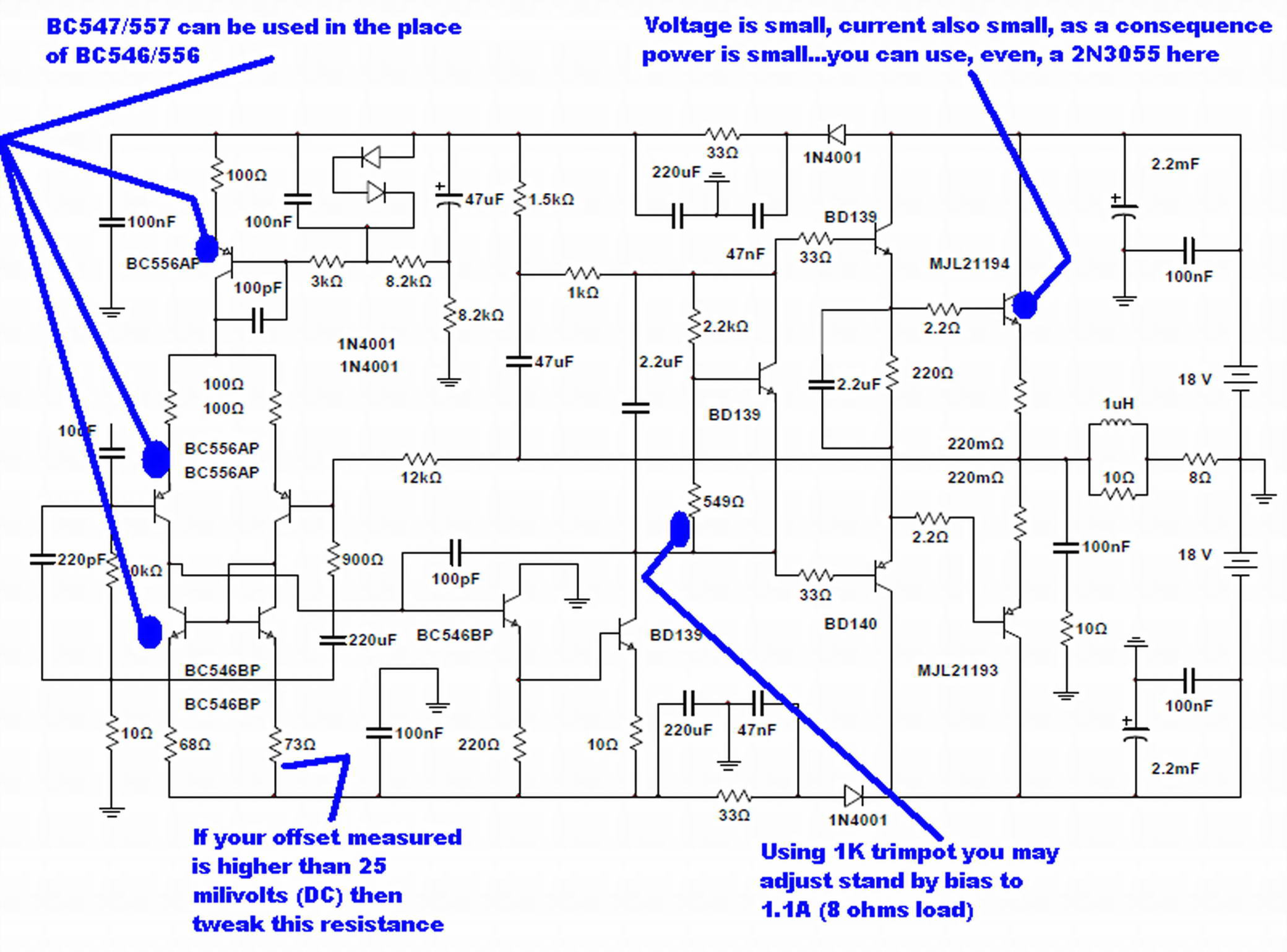

Will i build this one to test?....no way!
But it may be one of the best audio amplifiers ever made.
Board is the same board used in Dx Blame ES and Dx Blame ST.... details and layout in Greg home pages, and adjust stand by current to 1.2 A each rail:
Made for 8 ohms speaker..wanna use lower impedance?, then will have to re adjust, increasing the stand by current (my god!..heat!)

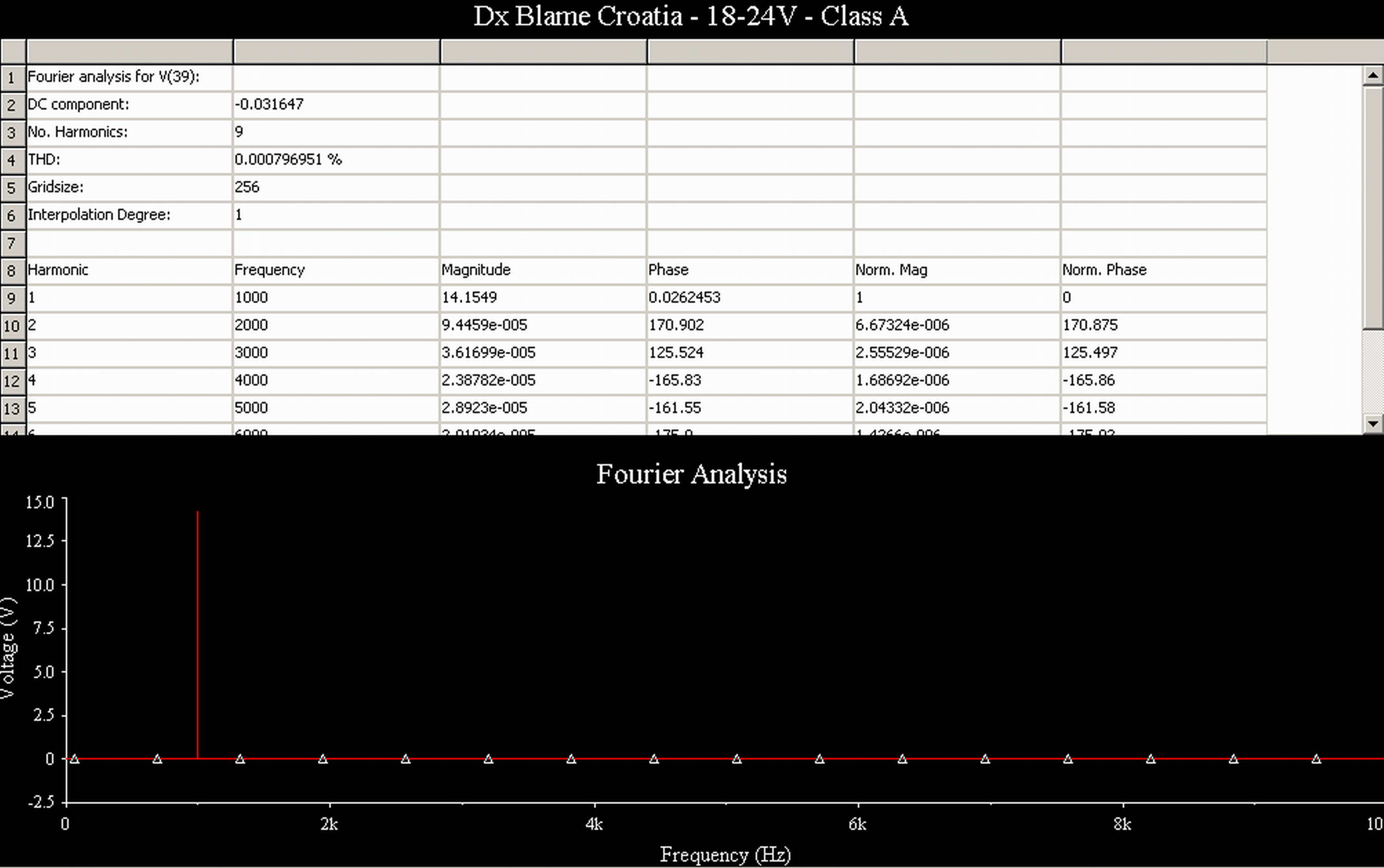

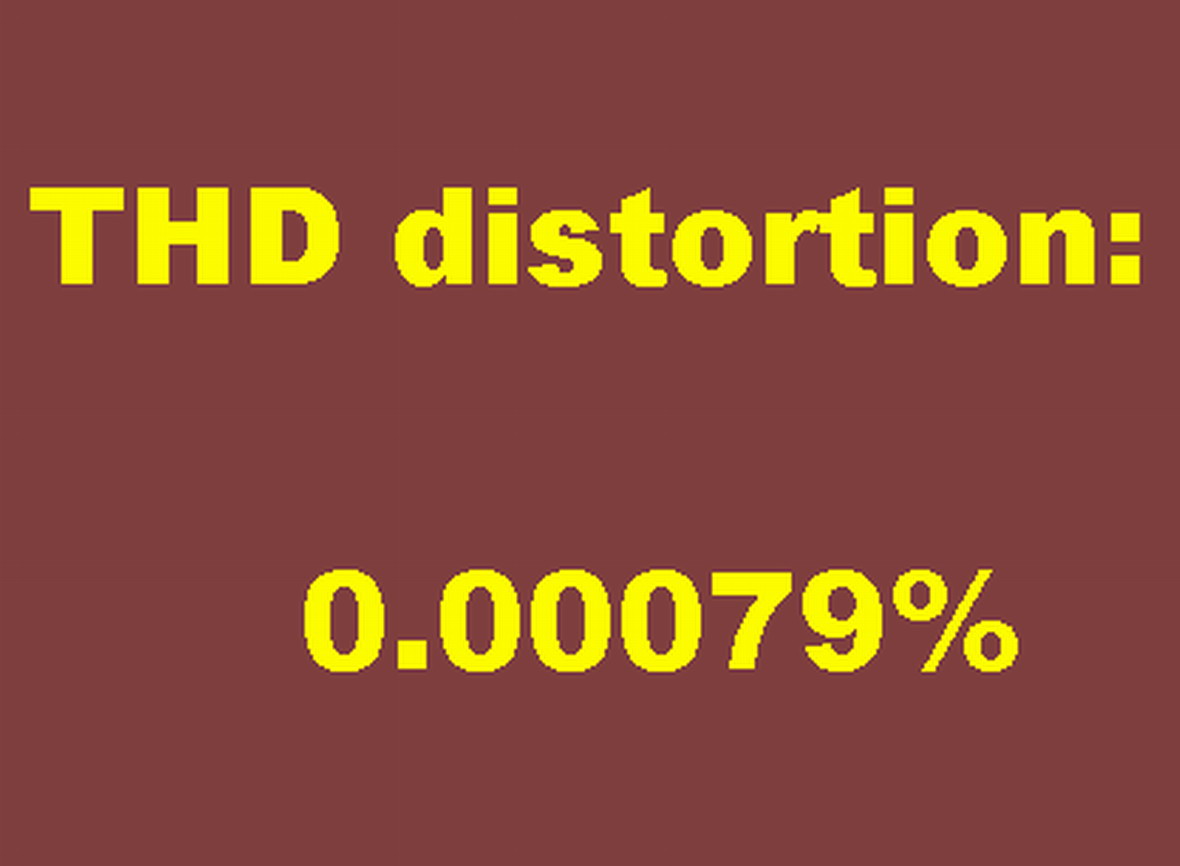

Take a good look at the distortion and harmonic distribution
compare with the best operational amplifiers and you will see the entire amplifier distorting 2.78 times less than some chips (the good ones)....also, it is 29 times less distorted compared to the Dx Amplifier, mine standard one.
Compare the specification with the competition and you gonna see this one comes to desintegrate, to vaporize the competition.

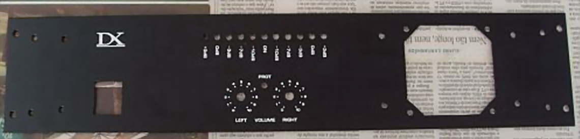

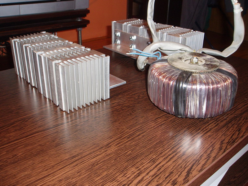

Carlos - as you know - i am building it slowly...
more pictures and details are on this page:
- Blame ST amplifier - class A version (Pulse.Audio.Team)
it will be entirely made from my junk box from what i have ... will not be preety but hopefully it will sound very very good..... :)
thanks btw. for your modification of the original amplifier that fits into what i have (transformer)...

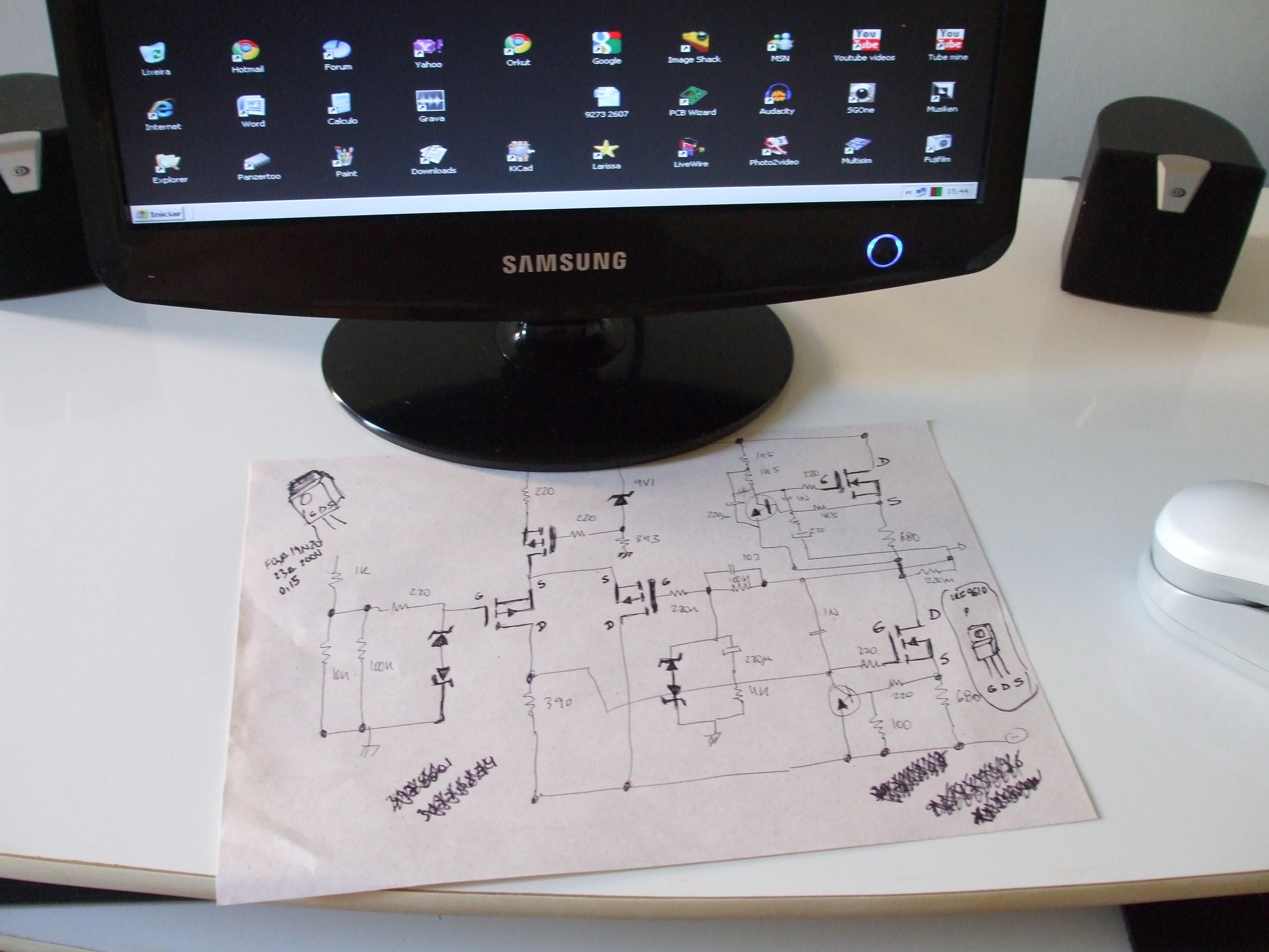

Sorry to be so short, so direct... this comment was directed to the ones use to build
Dx amplifiers, the "mufled" comment as i use to say that to them... they know what i think about class A as they have asked me to make an class A several times...i said them..increase your output bias as other transistors are already in class A.
they will not understand why i am posting something in class A as this may be an "abomination" in my life..something very strange to happens here..to publish, design, adjust, assemble or anything in class A..i hate heat...if heatsink is hotter than a human fever then it is too much and i increase heatsink or a fan blower is installed.....here is too much hot to class a amplifiers.
I used to build..thousands and thousands amplifiers Wayne...50 years doing that..addicted, sick, crazy for audio... i cannot leave without build..daily..sometimes two each day.... and because of that i have my conclusions...they are based in a very simple sittuation... a non complex analisis.
First build - result - mufled..losses in high end..sound alike below a pillow, or behing a curtain, a clothing material covering the tweeter...loss of brigth.
Second built... result....the same
Third built..... result....the same
After 100 i have concluded.... finally!...that sounded mufled...and as several where operating class A, with different schematics, different designers..then i started to think that class A sounds mufled to my ears, to my taste, in my home, with my musics, in my subjective and personnal evaluation.
I am building.... rigth now, a class A, from NP....because this one i have not build..will not post conclusions, as do not want to bother NP..but i want to know if this one is different..buiding to me, to myself, to check a different schematic never assembled.
What are my spectations?.... mufled of course!...you may say... change your speaker!.... and i did it several times.... i have not assembled yet... spectations only..things will happens near future (explaing in details to no english speaking people alike me...we use to misunderstand very easy)
I accept that others loves class A..reason why i have suggested this one to my dear friend from Croatia..he likes...so...he will enjoy.
