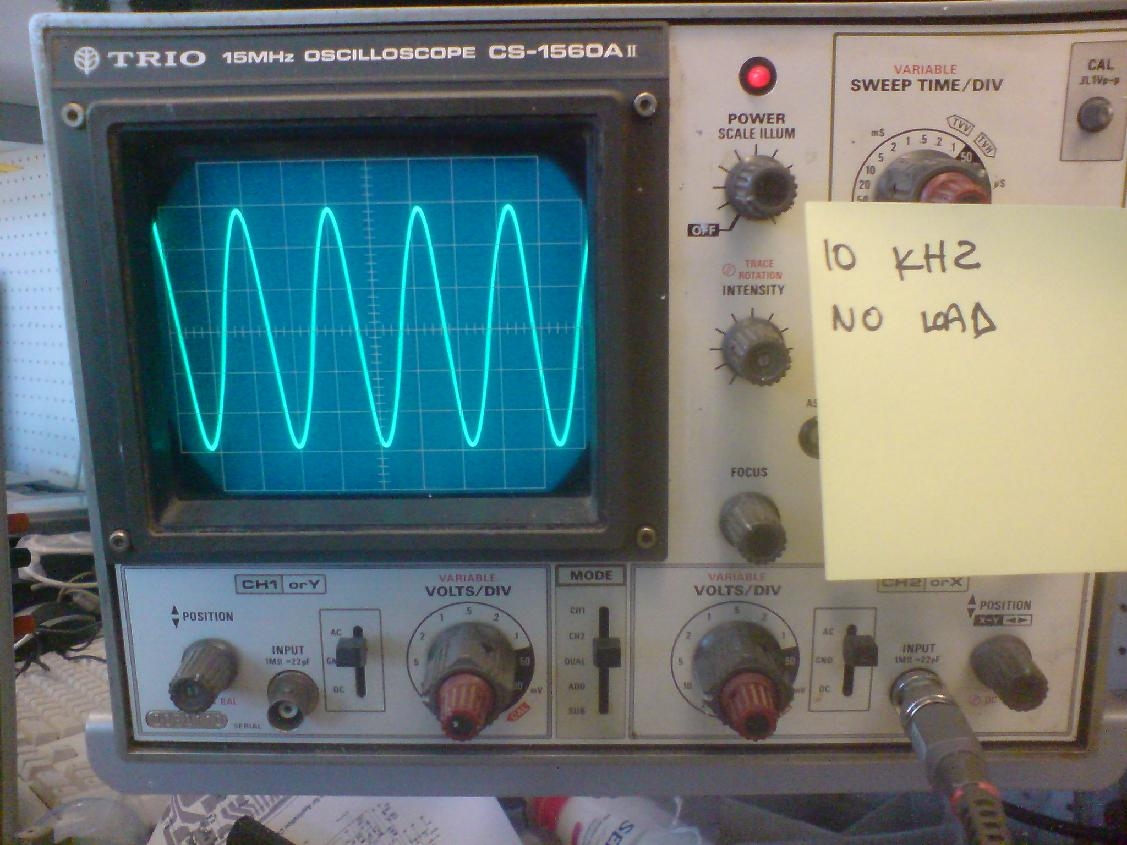

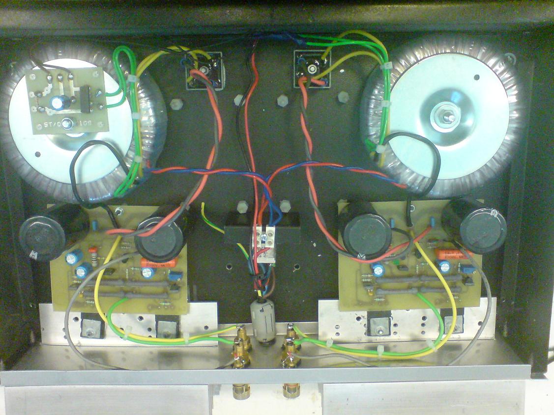

P3A construction and set up
dual mono 250W trafo per channel 2x28AC
psu caps 2x10.000 mfd on board
MKT input cap 4.7 mfd bypassed with 100nf mika
350 pf silver mica input filter
LTP matched pair +thermal junction
VBE attached in pos driver
82pf styroflex miller cap for VAS
100 PF multileyer cap on the driver
multiturn
120ma biass
BD139-140 family for drivers +VAS ( philps )
outpouts are MJL1302A 3281A motorola originall ( zeck replacement sets )

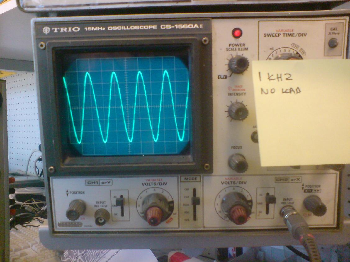

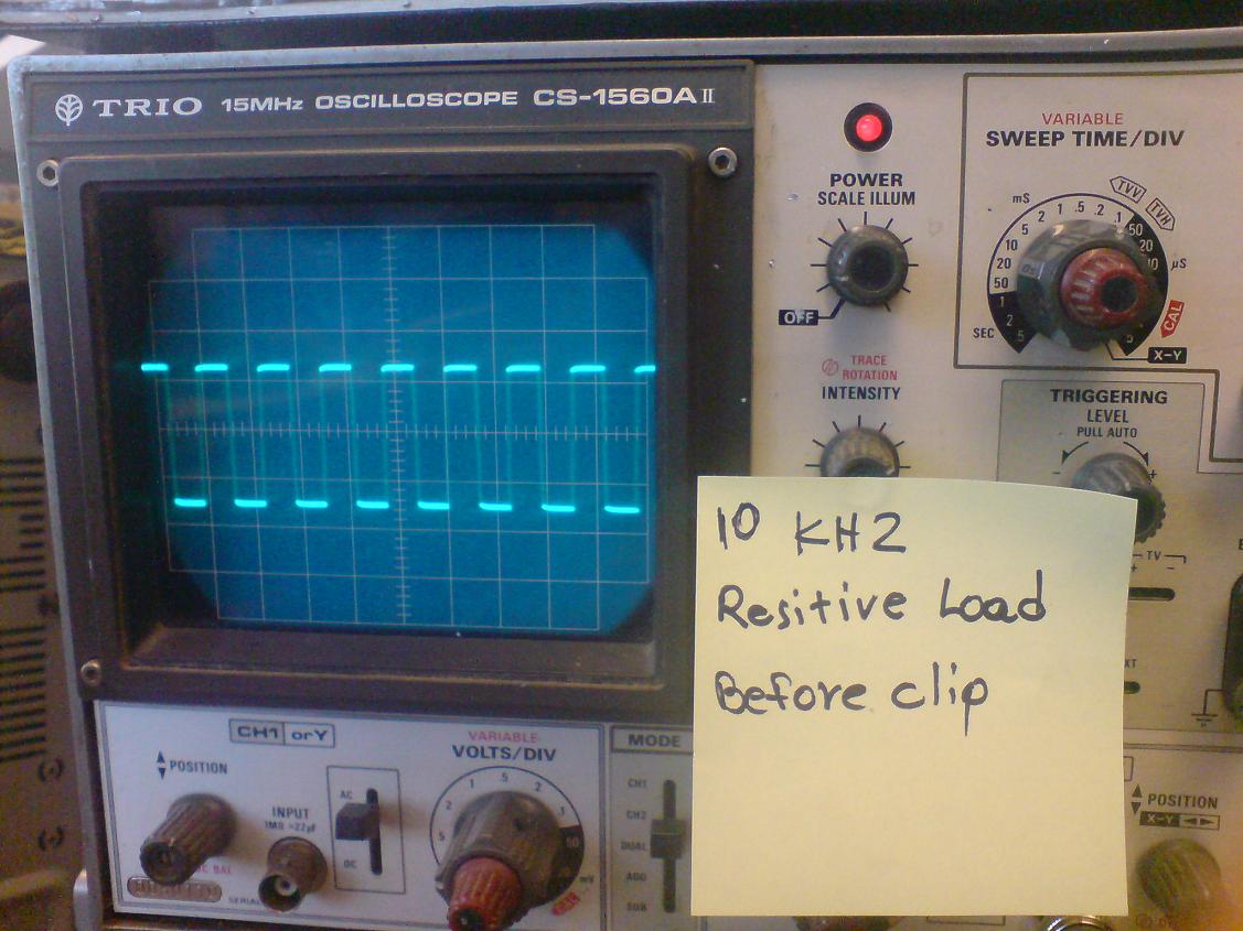

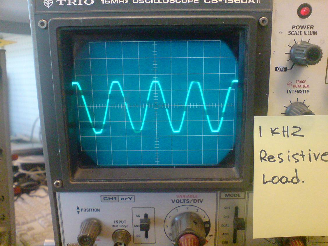

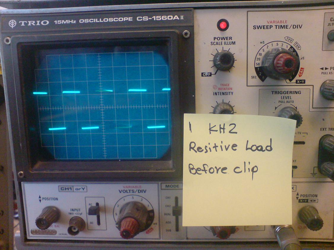

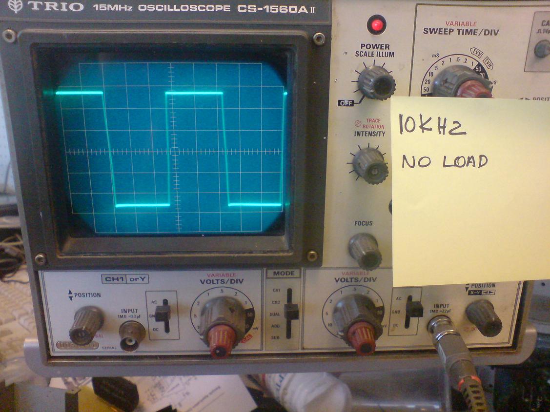

thanks for listening ...here we go ...scope readings

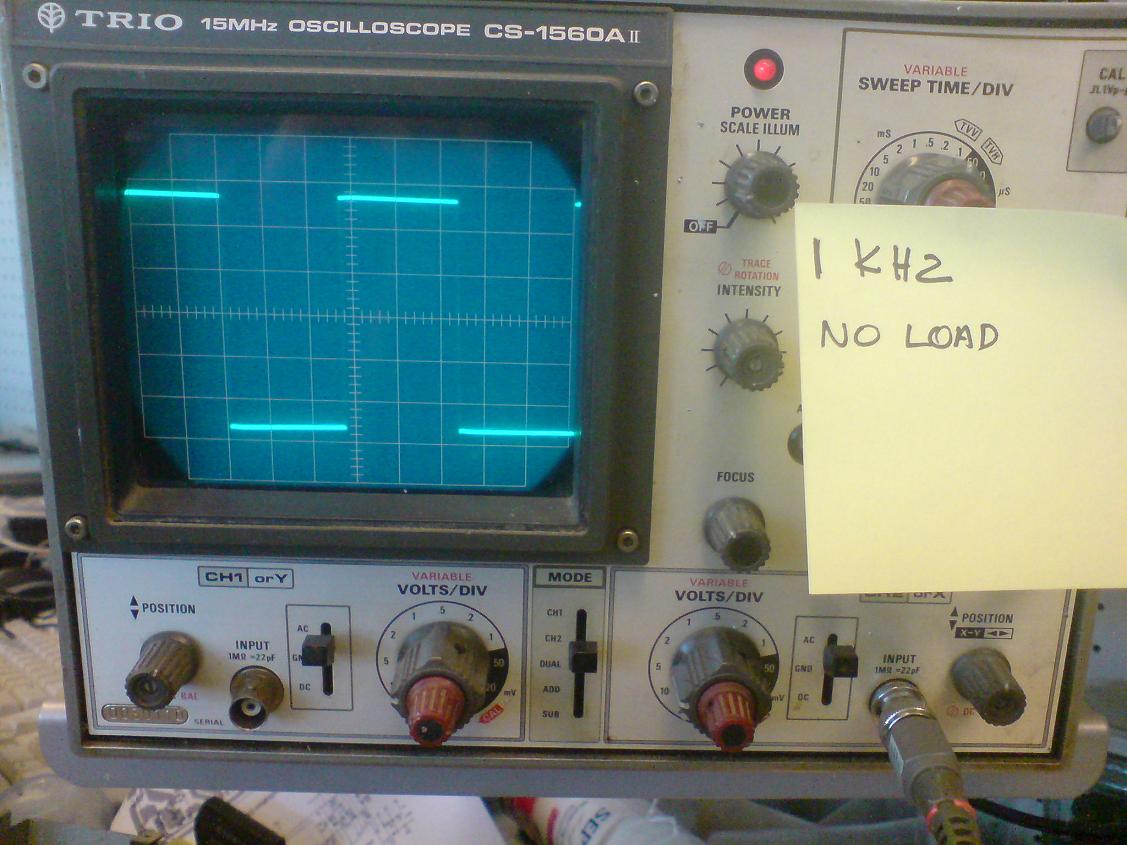

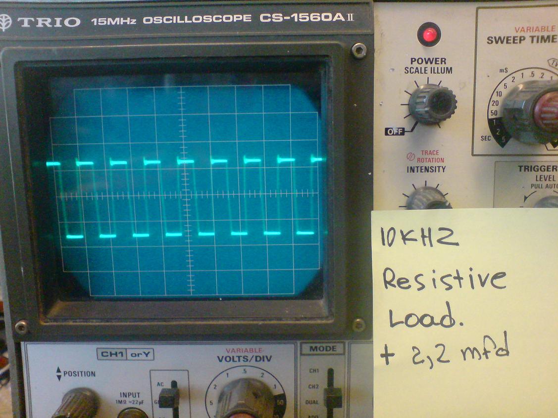

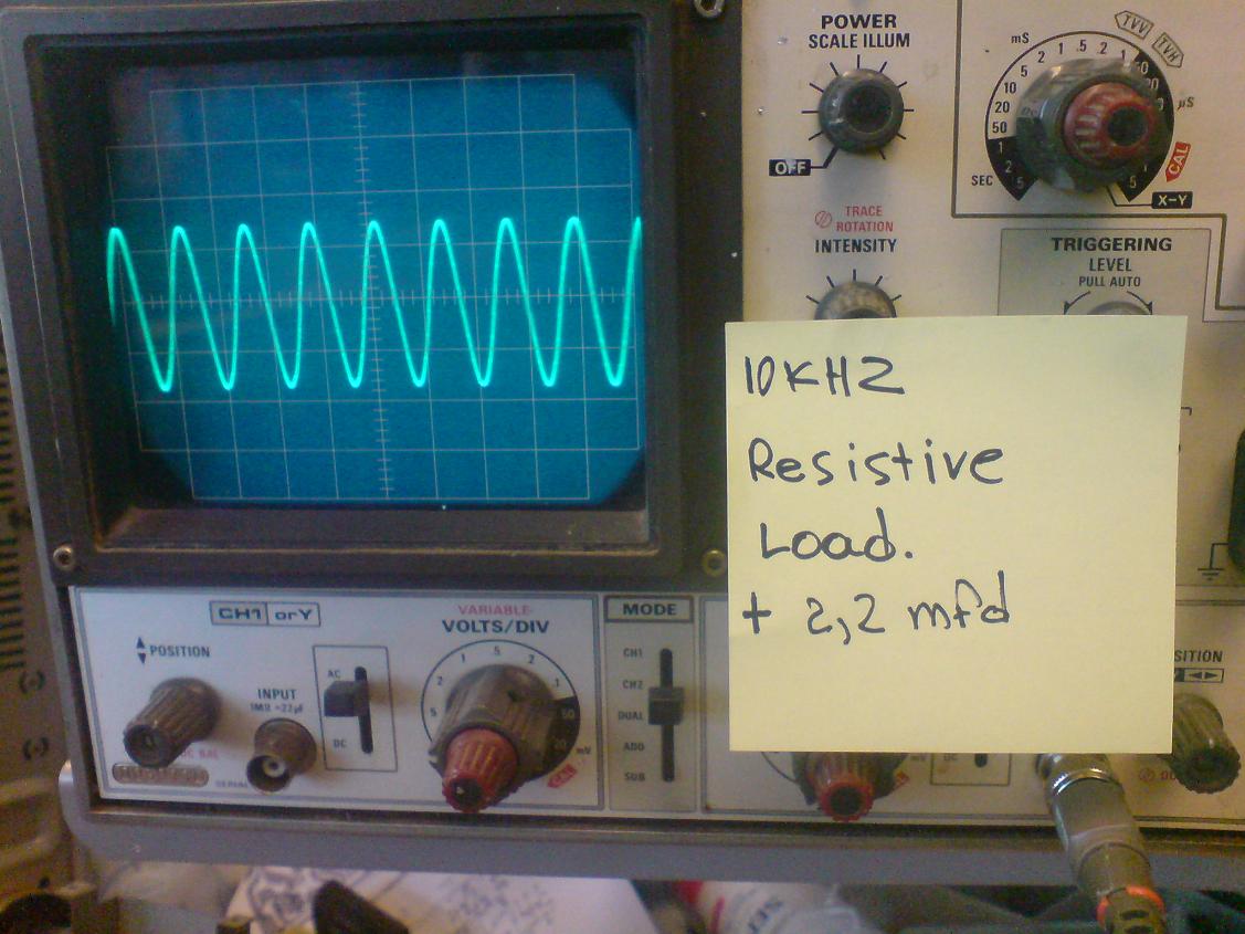

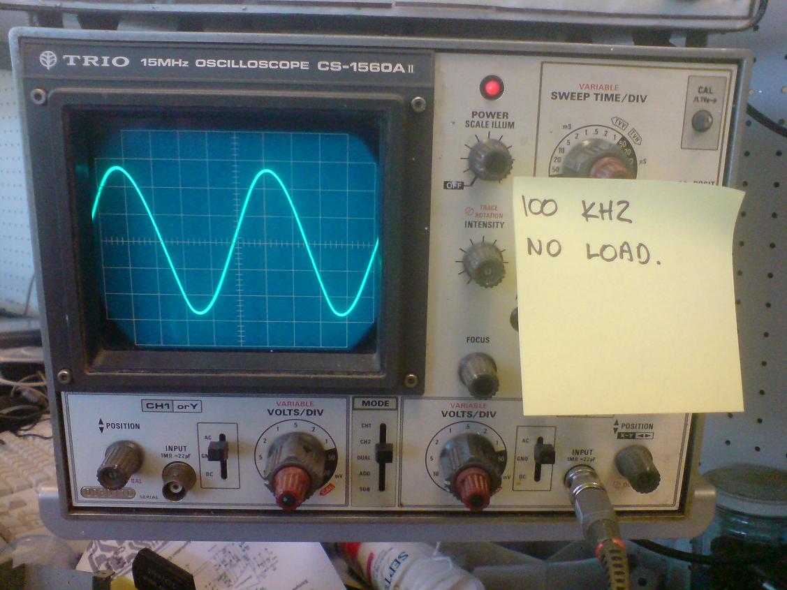

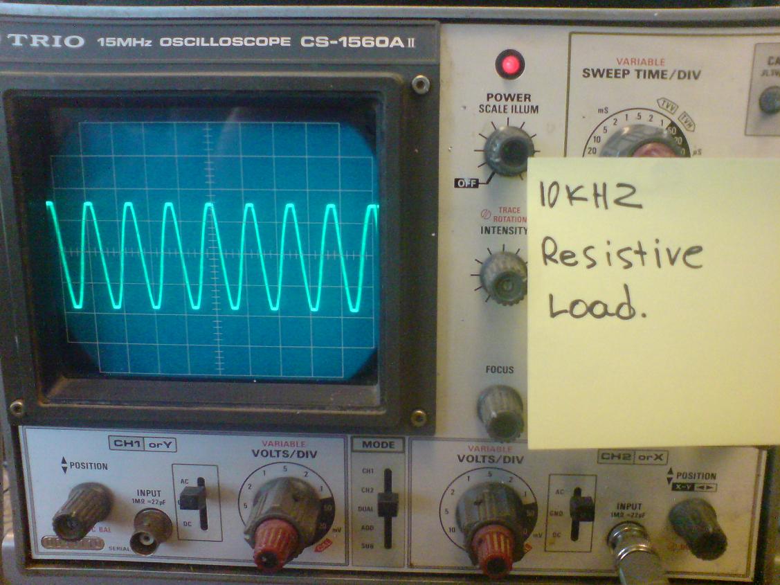

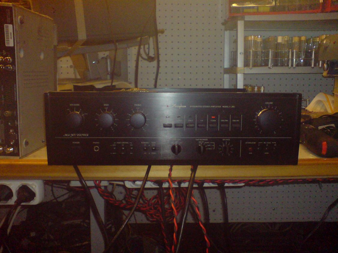

Service accuphase e 205
here is some info about ACCUPHASE E205
the particular amplifier has been repaired in the shop almost one year ago with the ony problem that had a rectifier blown ( no soft start circuit ) and the owner thinks that some kid was playing with it .
also found the output relays to be replaced and we did ...other than that seemed that no capacitor was to be replaced inside
after aworking year in a very dusty area due to house renovation selector switch needed cleaning
the particular amp doesnt use relays or shunts of any type ... just a simple selector swich ... the constructiona and quality of materials inside are so good and everything is placed so properly inside that there is no audible crosstalks
preamplifier section is perfect and tone defeat switch actually works ( its done with arelay at a proper area ) so yes if you cut the tones the machine is working perfectly and measures the same
actually its one of the very few that i can compaire to my unfair set up meaning that eventhough integraded amp its extremelly ultra quiet
better than the SANSUI AU 717 that i will recall as one of the same range
other than that a very sweet and accurate amplifier powerfull with wonderfull bandwidth and no serious colourations
here is some pictures

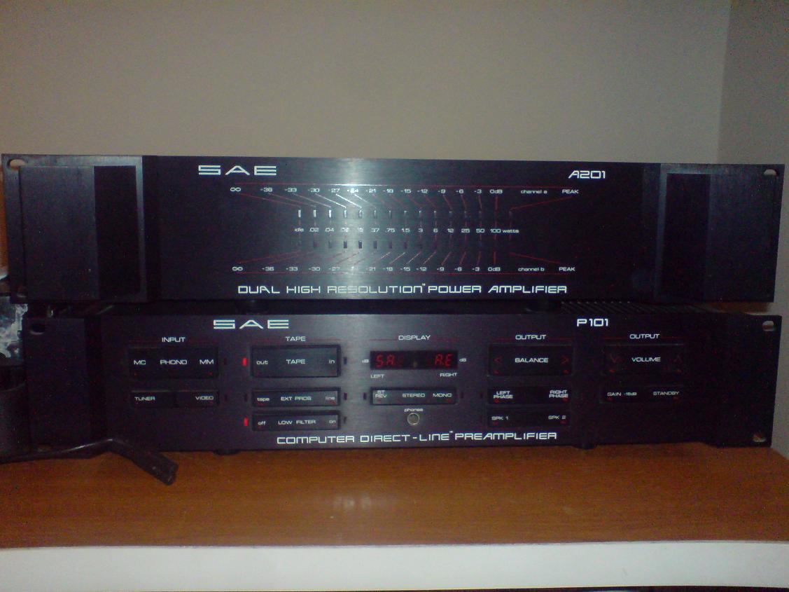

service SAE A201 and P101
here some more just finished yesterday
its the A201 and the P101 from SAE ...
the ampifier needed a 110/230 conversion new trafo 600 W fitted inside most electrolytics replaced retuned idle and working just fine ...
as an ampifier and next to my set it seemed that the amplifier had less bandwidth than my set ...low ends was kinda limmited still clea and not that punchy but seemed to be a lack at the very low stages just about the same for high i got the feeling that wasnt that clean and kind of hissy or harshy trebles
original bias seemd also low but i didnt want to play anything other than the oiginal values ... the topology outputs and configurations reminds the 555 series from Adcom only adcom was by far better
preampifier was a box full of TTL and 80 electrolytics that all refused to work ...replace them all things got a lot better ...
as a buffer and a preampifier is exeptional ( let us not forget its an 1981 design ) it seems that there is no ability to drive long cables or anything that is just a bit capacitive with this preamp
even though there a load of ttl inside to perform all button controls the unit is very quiet and the phonh stage is amazing ...( the costuemr will not run it with a phono ...still the phono stage was tested and seemed to have amazing tollerance to various heads tested i dsay that was extremelly adoptive
id say that both amp and preamp are above average and nothing too amazing
here is a picture

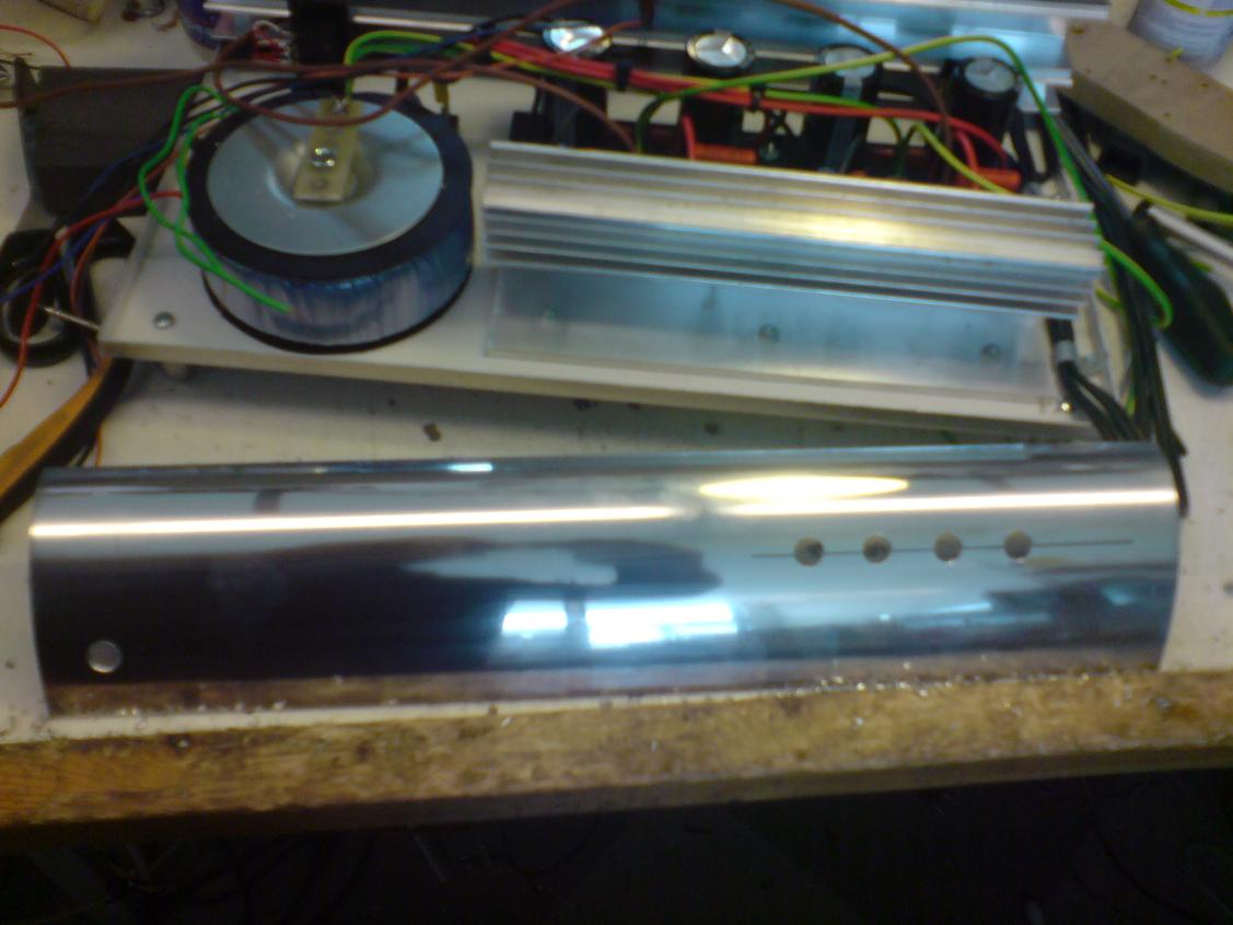

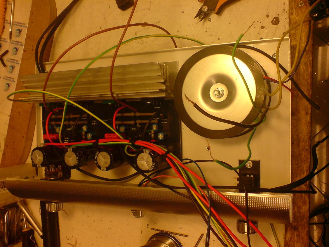

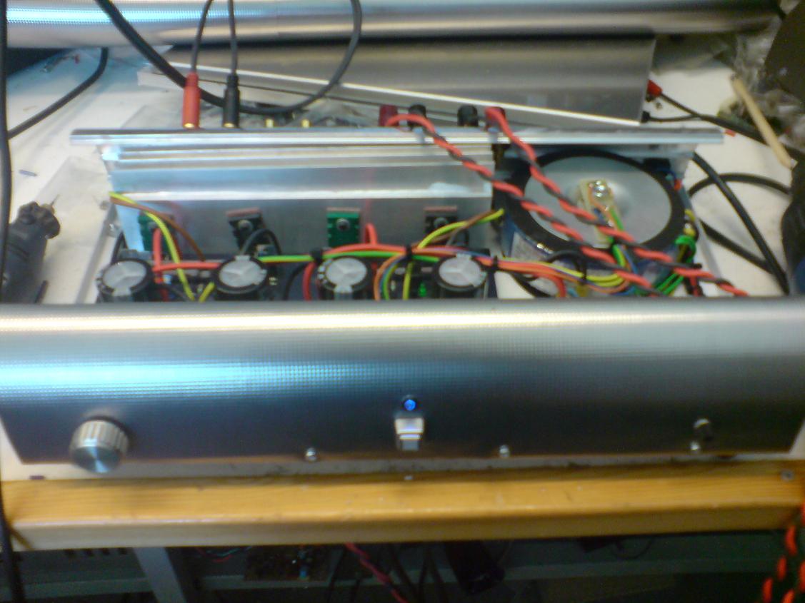

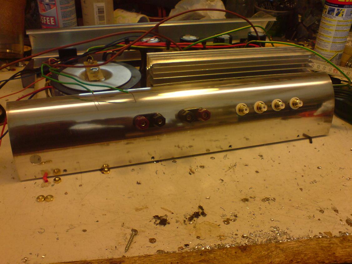

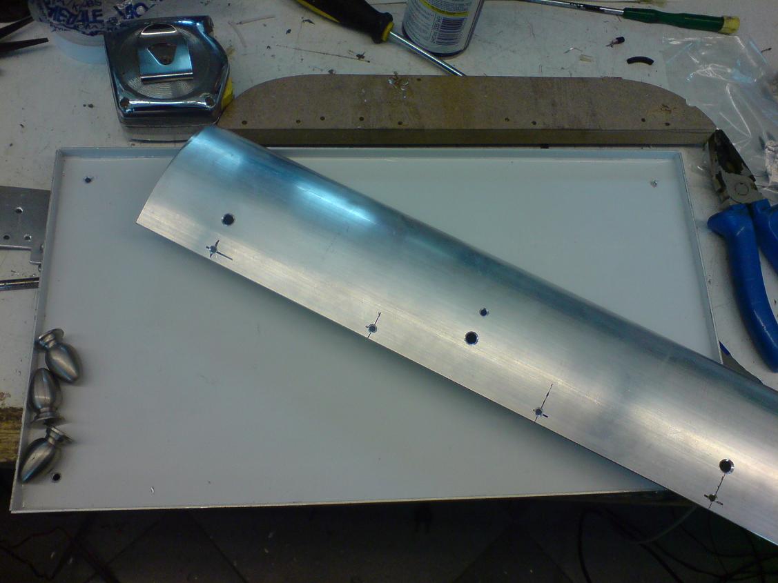

a P3A for my son's bedroom ....
almost 1.5 year ago i have constructed a P3A for my wife so i wanted to see the effect of the sound while she was having the baby ... and then use the same system for the baby after it was born ...
The baby loves the sound ( i think ) so is my wife .... the problem was that the amplifier i builted was too big ...the amazing waf factor ... so i was asked to bulit some other version probably less power but for sure less size
here we go ..there some pictures of my new built ... but i have a small issue ...
that is a standard built uses original 1302+3281 in the out ,100pf silvermica for miller VAS and then 100 pf multileyer for the down driver ...other than that everything else is as seen on schematic
i ve been building in the past mostly with bd 139-140 and mJ15030-31 families
this time i used bd 829-830 i had some of them available and willing to try
i wasnt expecting a noticable diference but even though the bias is quiet low since size of the box and heatsink i didnt want to create high temperature inside still it plays by far better than the 139-140 or 15030-31
can anyone explain why ????
can any one double check this and provide an opinion ???
thanks sakis
Hi Sakis
The main difference between the BD829 and BD139/MJE15030 is the fT. The BD829 has a transition frequency of typically 250MHz, as opposed to 8MHz for a BD139.
It may be the higher speed of these devices which accounts for the sound difference. In what way would you say they sound better?
Steve
well as i describe my approach for this amplifier and some time compared with the DX amplifier which i find very accurate and very precise my amplifier is a bit endy ....means that will represent with problems any signal at the ends ...low and high
now if you see the one that is made with BD139 series and the other was made with BD829-830 seems that everything is more bass is even more rich midle is more perfect but most of all seems that high are by far more clean and have a class A sweetness ...tybe style sound
the previous version i was listening to was biassed at 120 ma per board now this one is biassed almost to 1/4 of this bias and still plays better ...
i have to investigate this farther ...it seems that these driver rock !!!!
( hei do you like my enclosure ??? )
