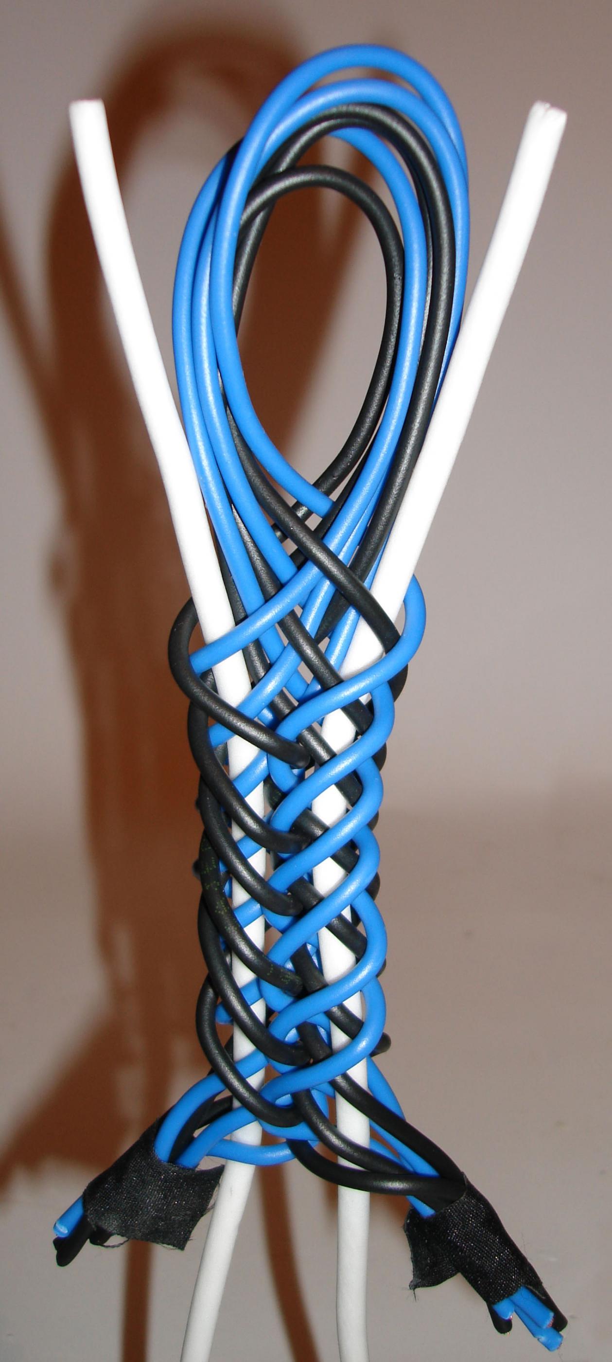

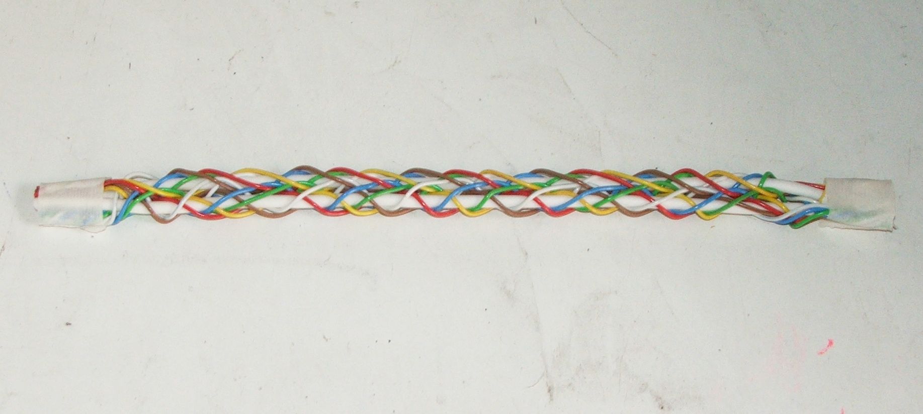

here is my first attempt with lot of colors - bad idea (pic1)
try with only two colors
hardest part is beginning

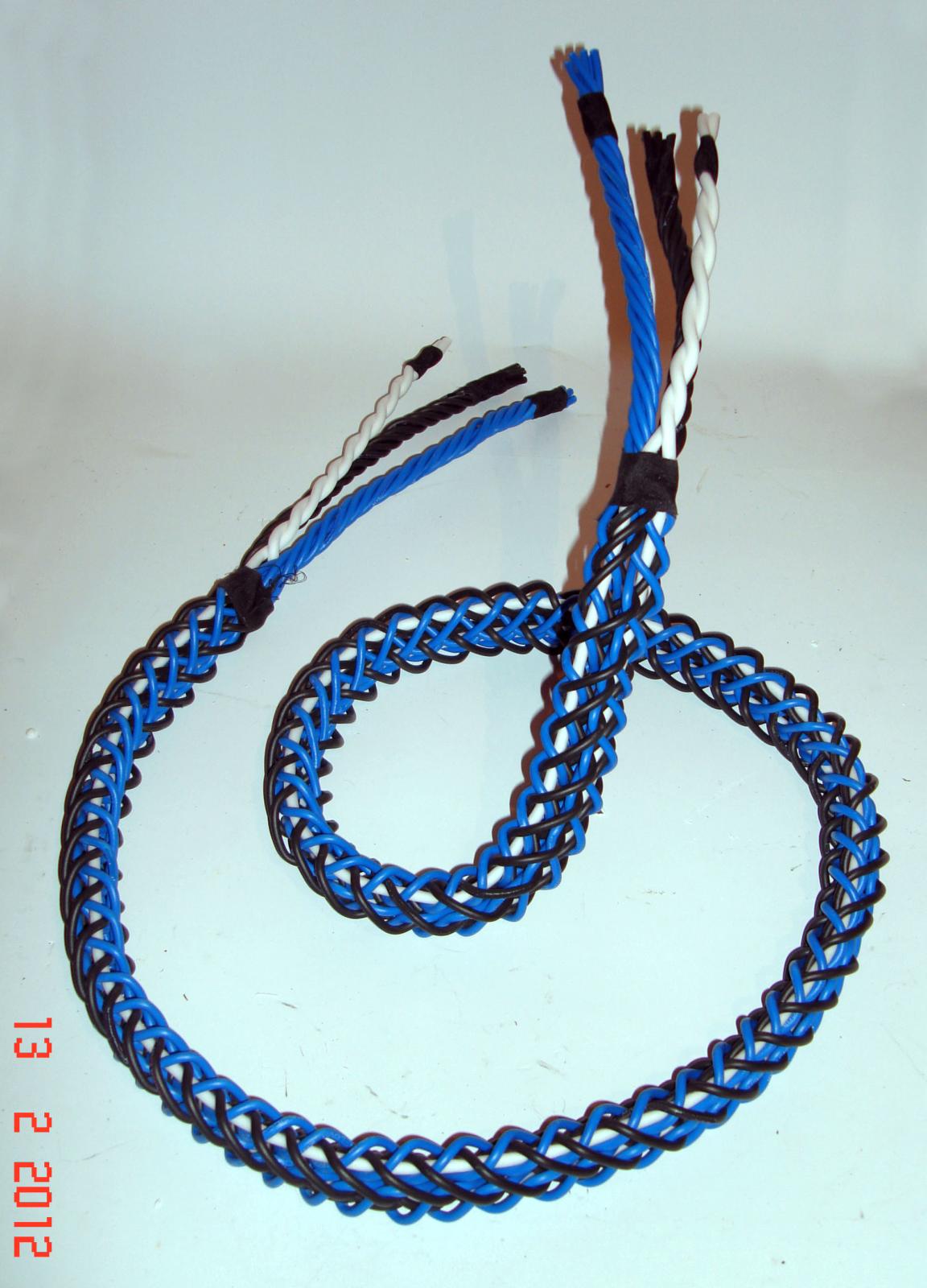

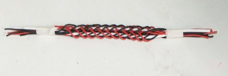

white conductor is not a part of helix geometry
"Some embodiments of the present invention
also comprise drain wires which are not interlacing elements
and which run longitudinally within or adjacent to the helices.
Shielding may also be employed to help reduce noise from external sources."
it is commonly used for grounding, and should be larger in diameter
(easier to braid)
there is 6+6 awg13 conductors
and it is only for heavy loads (amplifiers, welding machines etc :D )
I hope this helps :)
