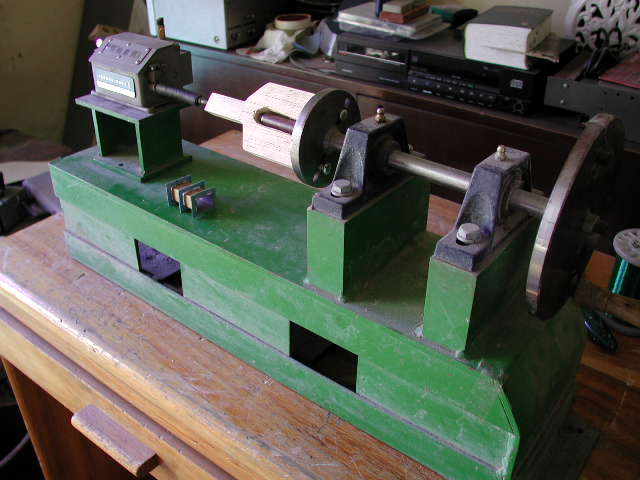

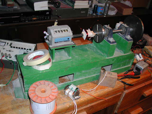

I have rolled 12 ga inductors and transformer in the past and seldom used a hammer (but will depend also on how much of the window you are planning to use) but 11 ga will probably be a challenge.
You need to protect your fingers with masking tape or gloves. If you need to use a hammer you can use a regular steel one taking care that the face is smooth and no dents or burrs. Modern varnish is quite tough and wont chip.
For inductors you will need to calculate the gap between the E & I.
For better results you will need a sort of a hand lathe utilizing a wood mandrel to fix the bobbin.
This are some pics of what I use but you can do it of wood very easilly...

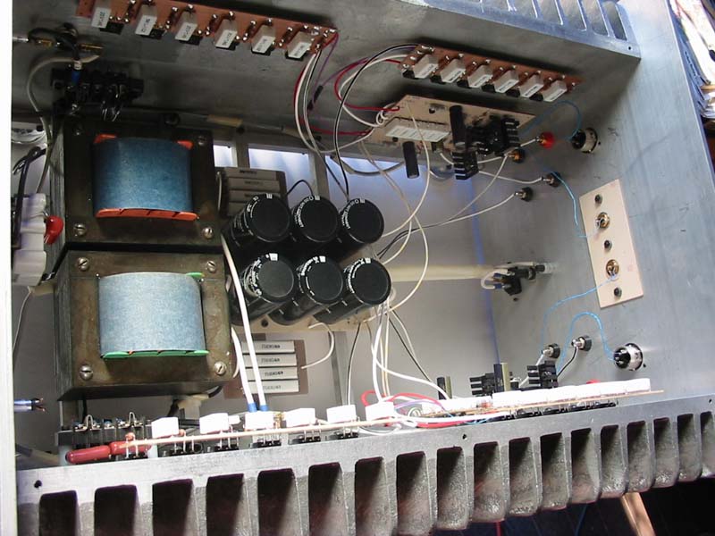

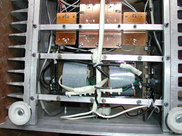

I see Joan2 rolls bigger than me. The maximum I've done is EI 150 (1 1/2" center leg) with a stack of 3 1/4") I would generaly limit the stack to about 2 times the center leg size.
Last year I made 2 transformer of this size for my Aleph 4 rated at around 750 VA each. Secondaries were 12 ga.
Regarding the bobbin former what I usualy do when doing non standard stacking is splitting a standard plastic former with a jacksaw put it over the wood mandrel and fix it with some tape and I'm ready to start winding.
Big bobins should have an internal hole about 0.005" oversize regarding the lamination core to accept the poor gometry of the bobin.
If doing a non standard bobin or in instances that I don't have a standard plastic bobin former I make a former using Fish paper usualy 0.010" thick as you can see a small bobin on one of the previous pics.
The following pics show tranies for the Aleph..

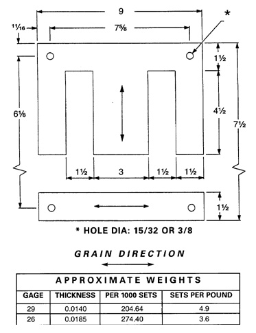

I ordered 750 I/E sets in a smaller size (7.5" x 6.5") #26 gauge. The order stacks out to roughly 14" which gives me a stack height of 3.5" apiece for the four chokes. With shipping (140 lbs cost me $65.00!!) the cost comes to $272.51. The 11 gauge wire cost me $160.00. Everything combined, I'm investing $432.51, which is a bit more than the $300.00 I had originally planned on spending. Still, four of these chokes would probably cost $1200.00 to $1400.00 from Hammond if I were to gauge cost by weight. So I'm cutting the cost by about 2/3s. I'll keep you folks posted on my results.

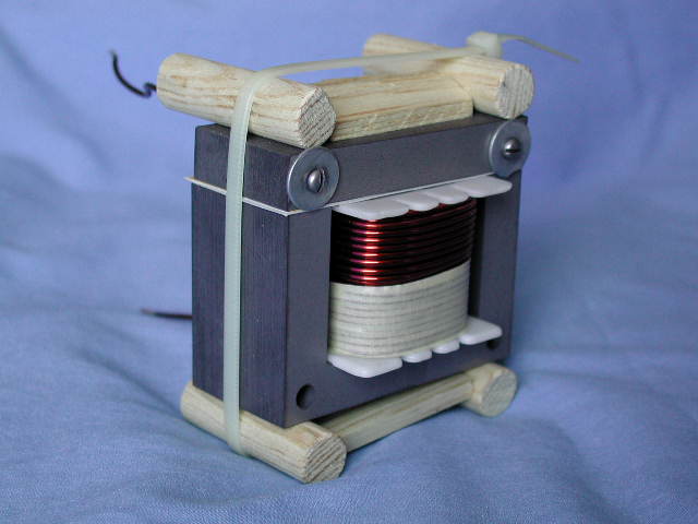

Air Gap:
The way to create an air gap with EI laminations is simple, just put all the "E" from one side of the bobin and all the "I" to the other side in order to close the magnetic path.
To create the gap you just need to put a nonmagnetic separator between the E and the I. Doing this you will be creating a double gap since you are sepatating the central core (full magnetic path) plus both 1/2 outer magnetic path.
So, if your able to calculate a certain gap you should divide by 2 to get the correct physical amount of the gap for EI chockes.
The problem you will have is to hold the magnetic structure. The esay way is to use a frame as you can see on commercial products, but on big and nonstandard pieces such as you are doing this will be something you will have to work on your own. Not difficult though.
I'll show a pic of a gapped choke, for a LP filter, I did reacently. this was for testing purposes but I still have it like this.
