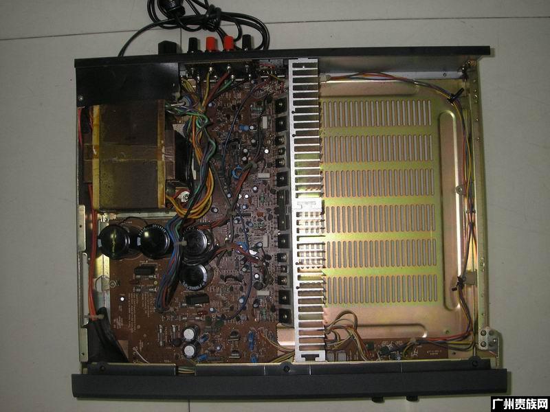

I have a NAD 2100 Monitor Series amplifier that is now dead. Transistors are obsolete and I can't find replacements for a reasonable price.
The transformer and the case are good. Does anybody have any suggestions for a fun project? I'd love to turn this into a tube amplifier but I haven't a clue where to start.

Is this what your amp looks like?

Yup, that's the Amp, I've got!

I've got 3 pairs of wires coming from the transformer to the main board.
Impedence Switch Position___4Ohms___8Ohms
Purple_____________________55V_____55V
Blue_______________________85V_____109V
Red_______________________58V_____72V
From that, can you tell if Project 101 would be feasible?
I followed paulb's advice and went with a pair of ESP Project 101 amps. The link is above.
I salvaged the case, heat sinks, transformer, input and speaker connectors. The P101 project fits nicely in the NAD box.
I just got all the pieces in the box and did the first stereo test last night. Performance is fantastic so far.
Cost will be somewhere in the range of $200. I would estimate that it took me 20-30 hours (this was my first amp project). I have some electronics knowledge.
