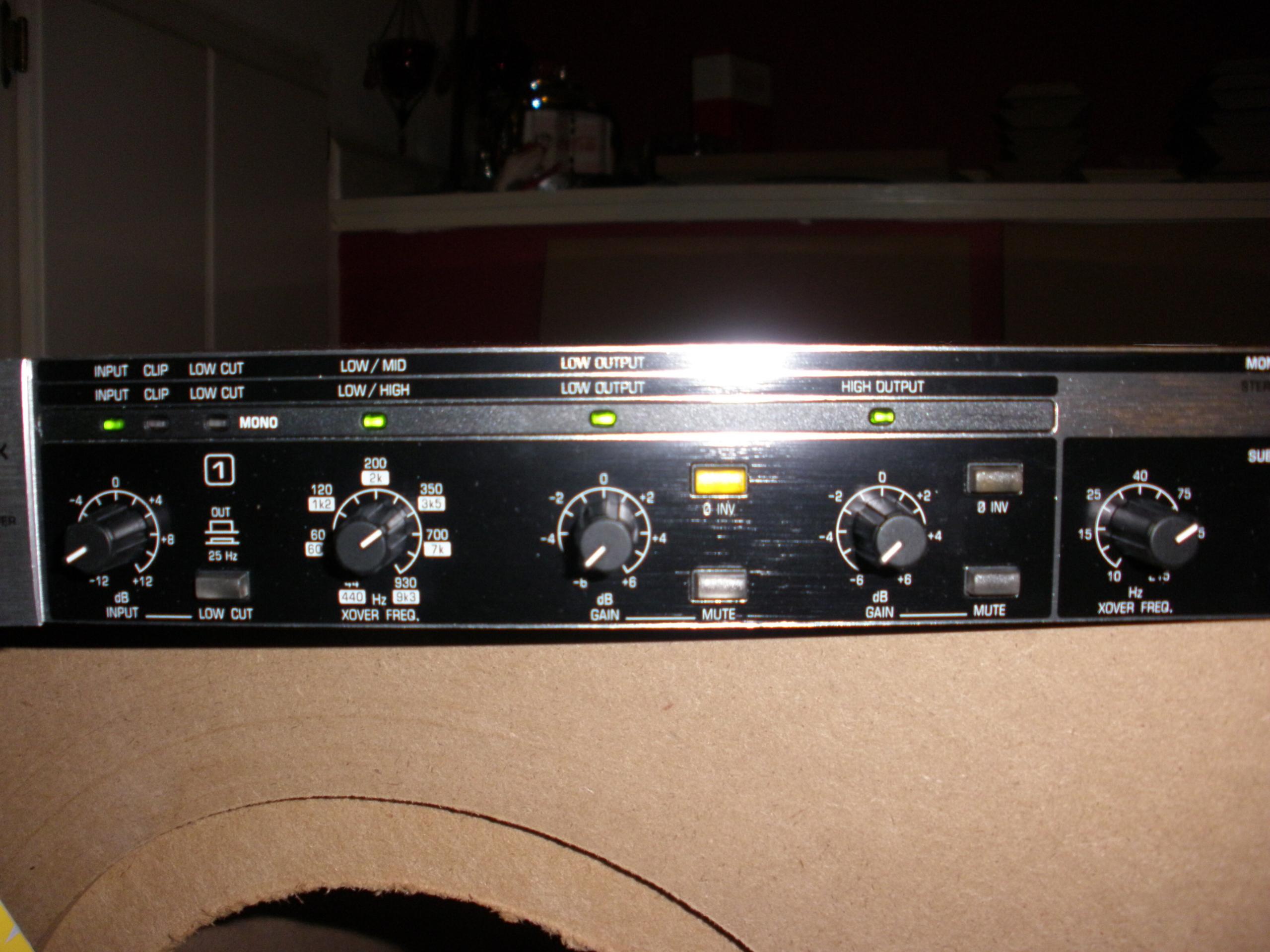

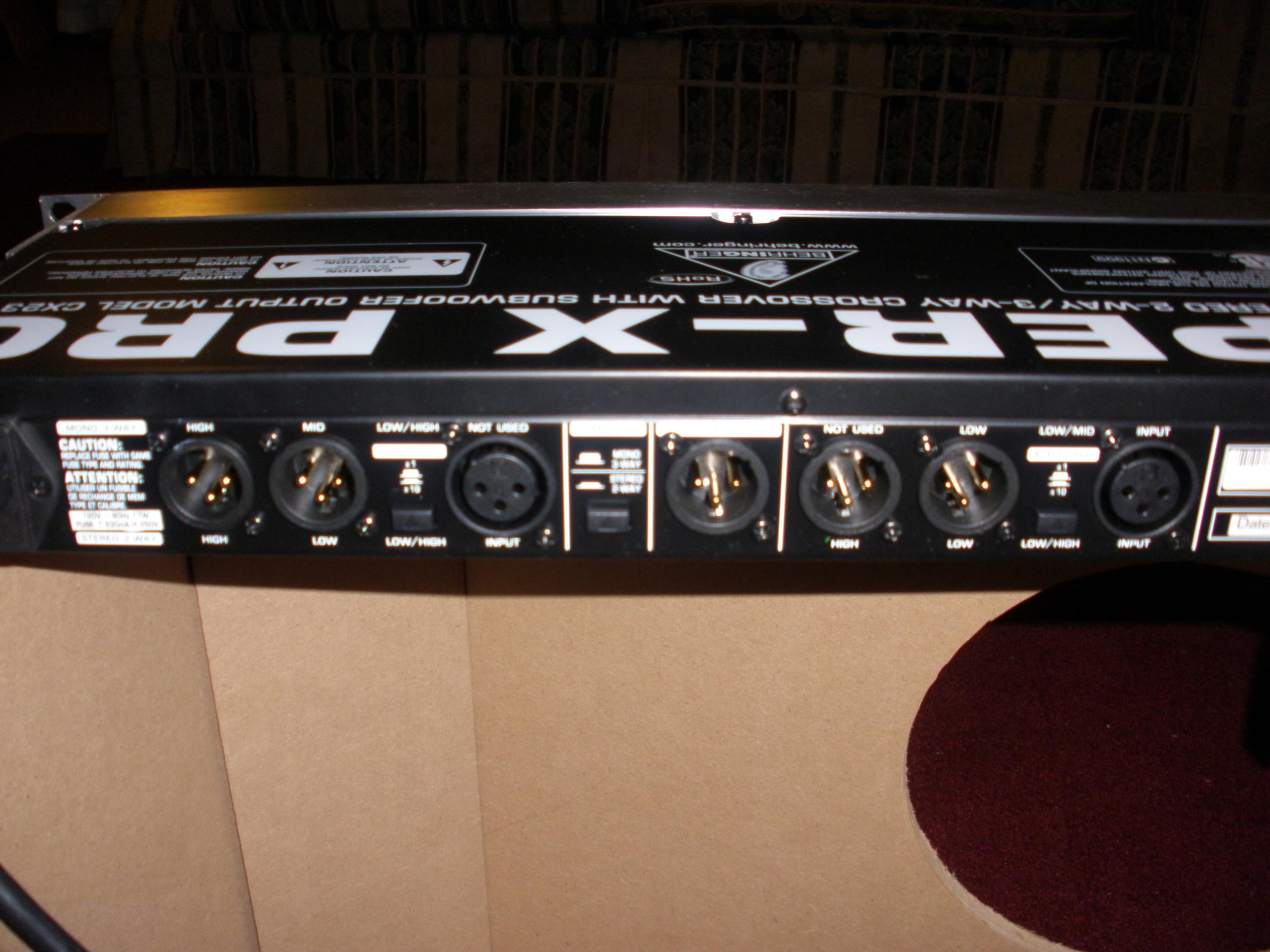

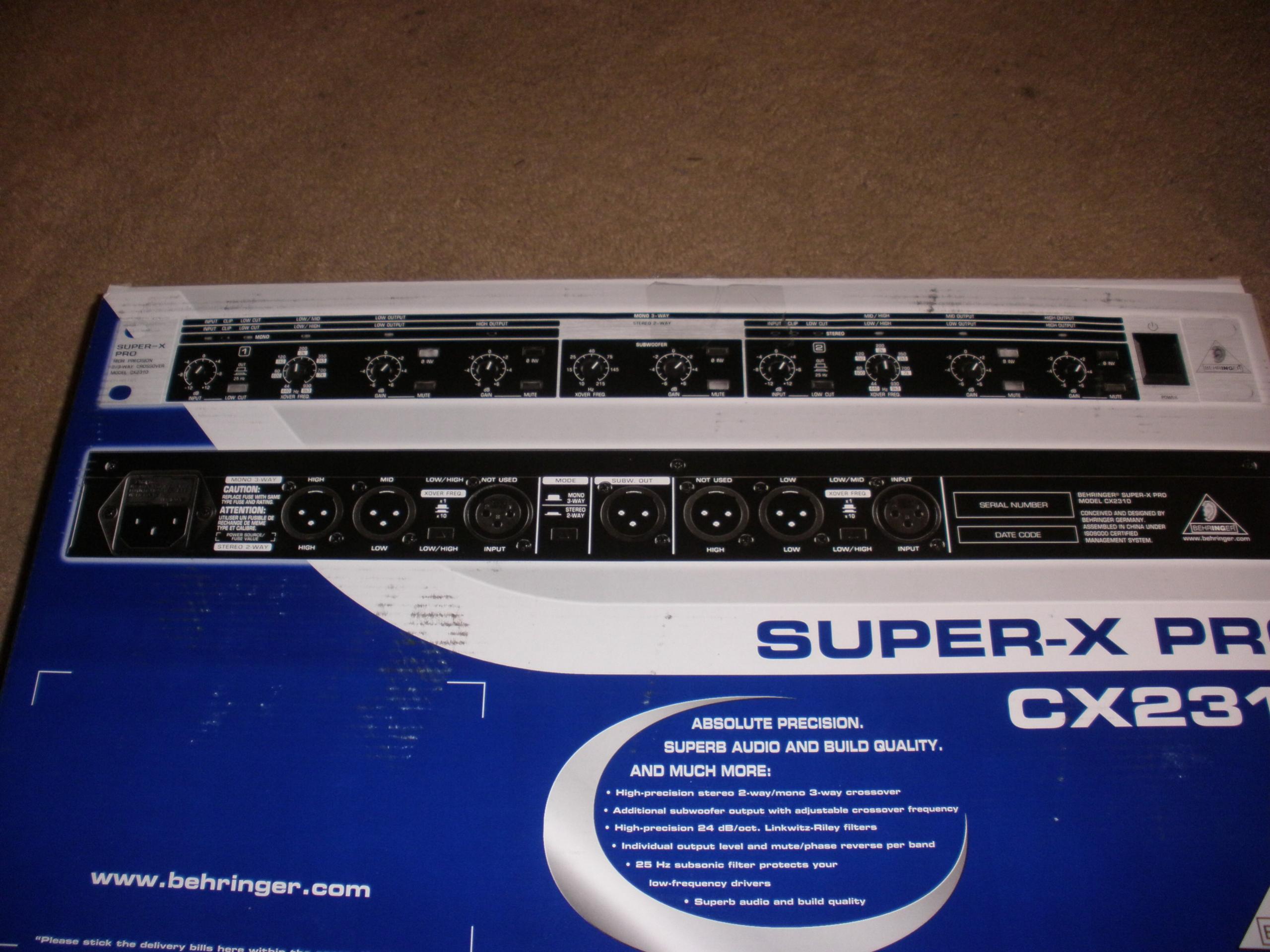

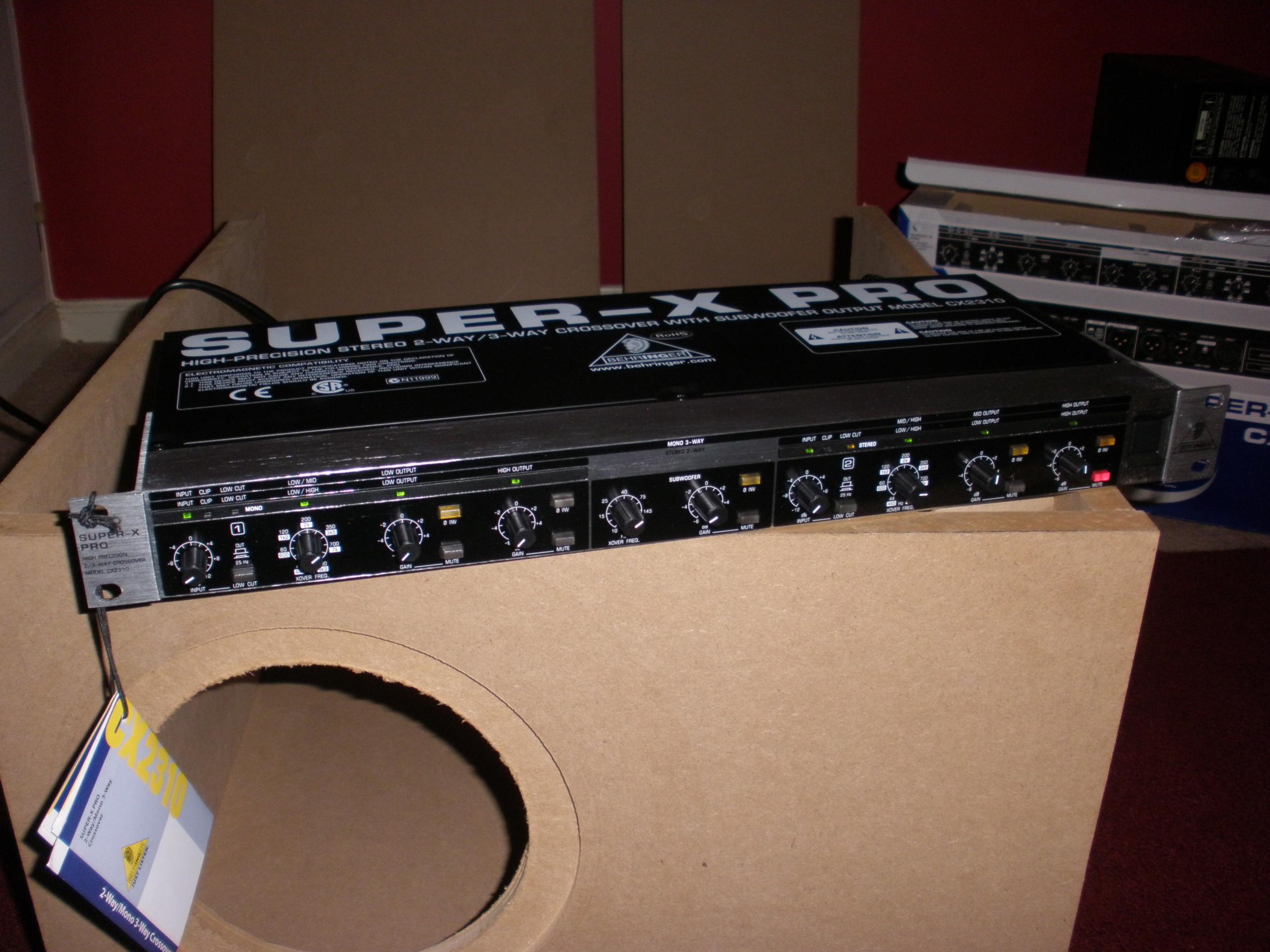

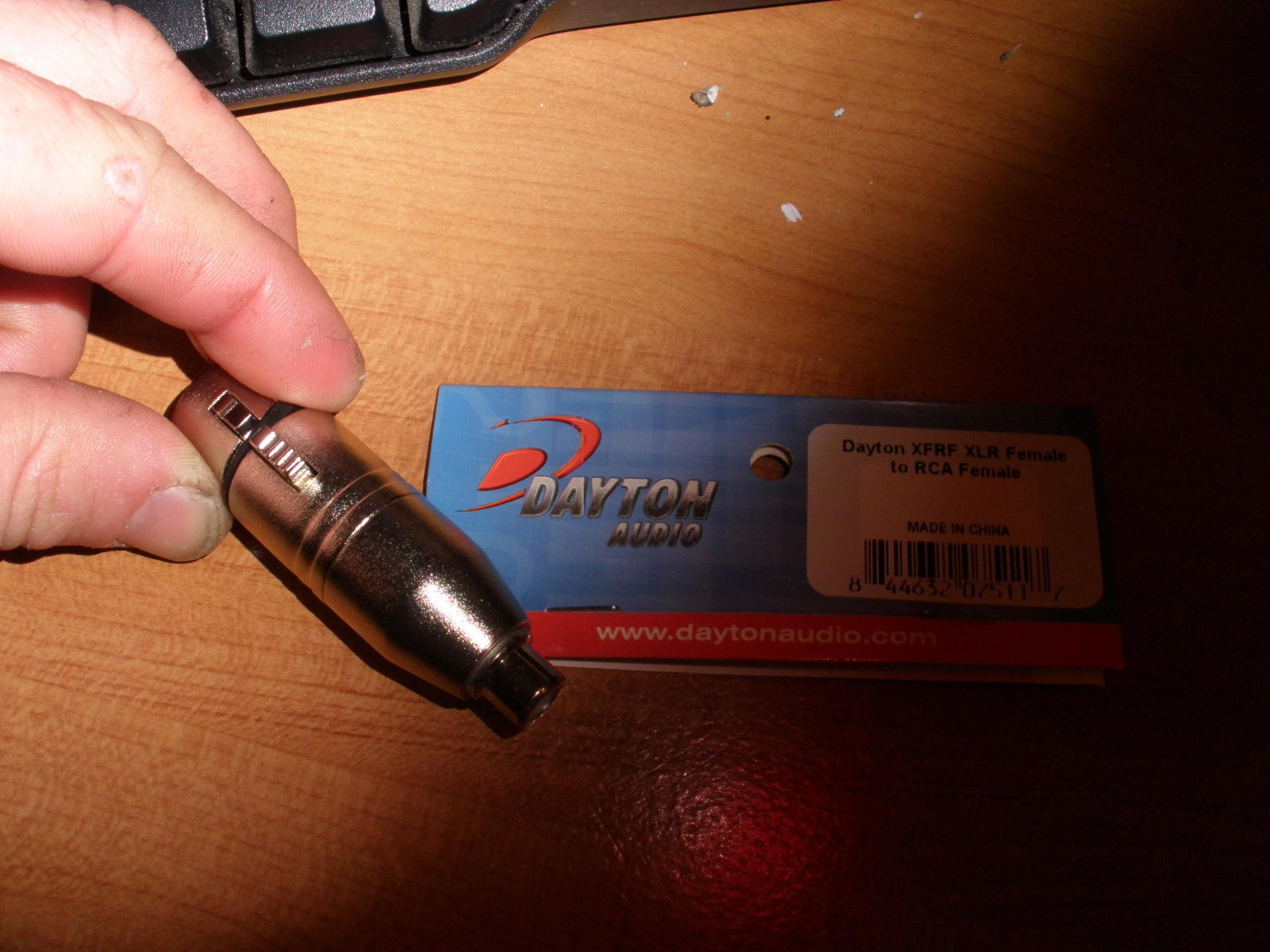

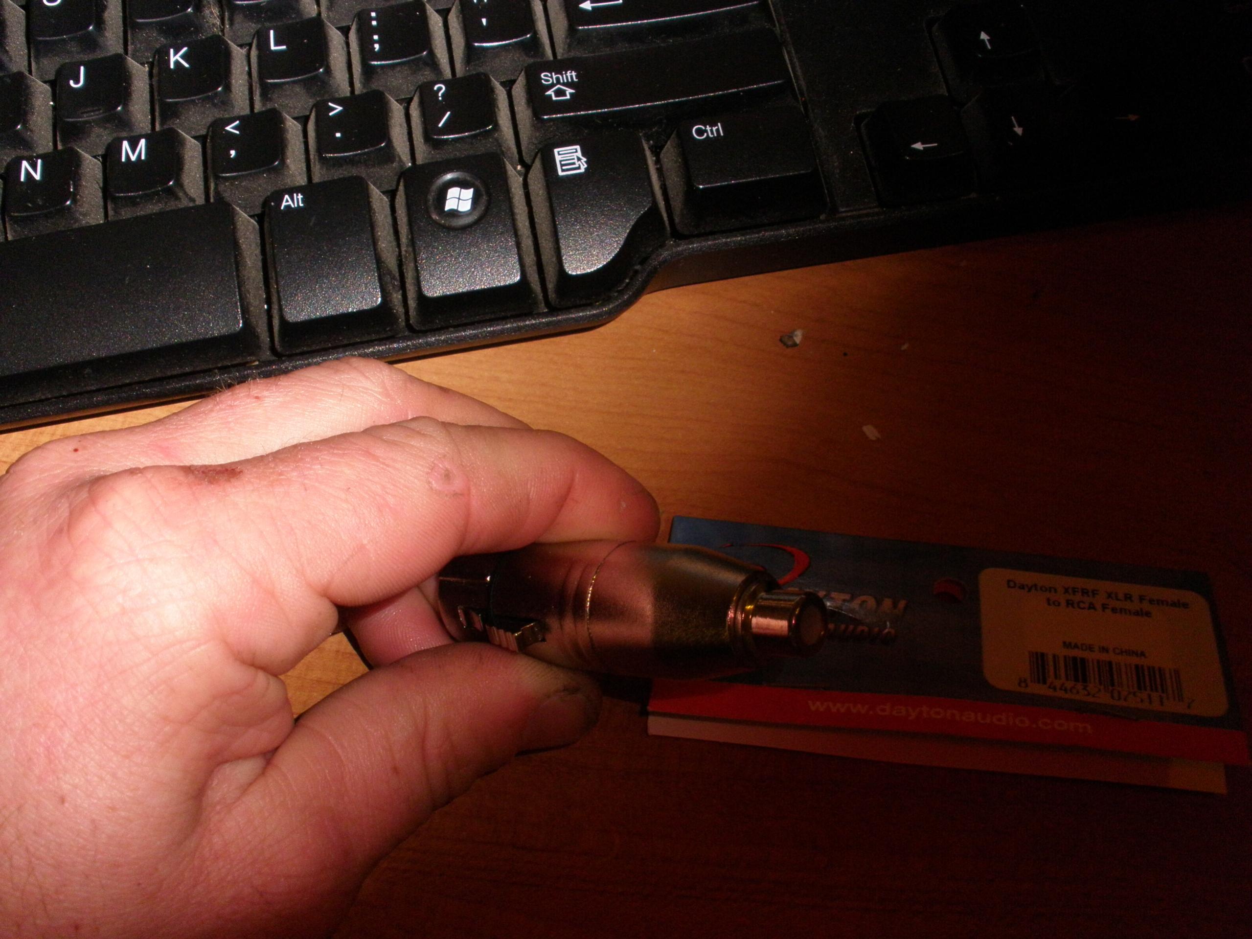

The first is a Beringer Cross over for the panels, it is D.J equipment so you will need to get a Dayton XMRF adapter for RCA connections, from parts express. very reasonable price and well buit. part# 240-438 and 240-428, which are male input and female output from the cross over

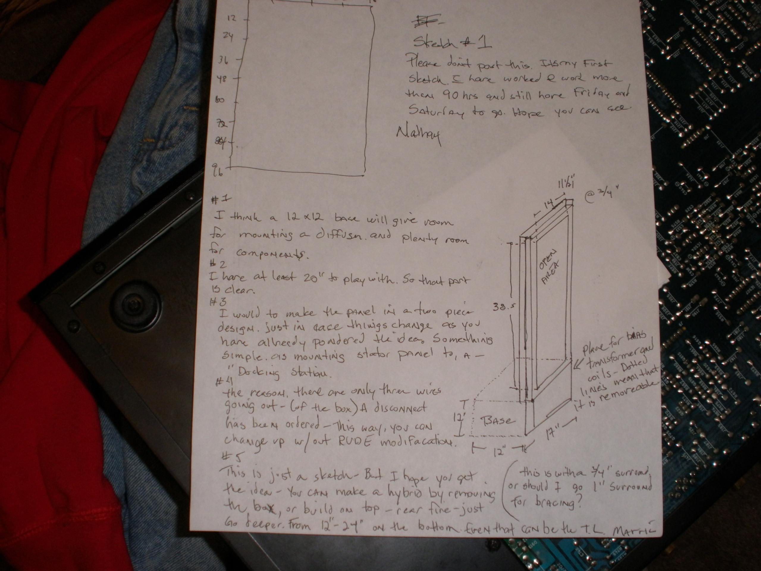

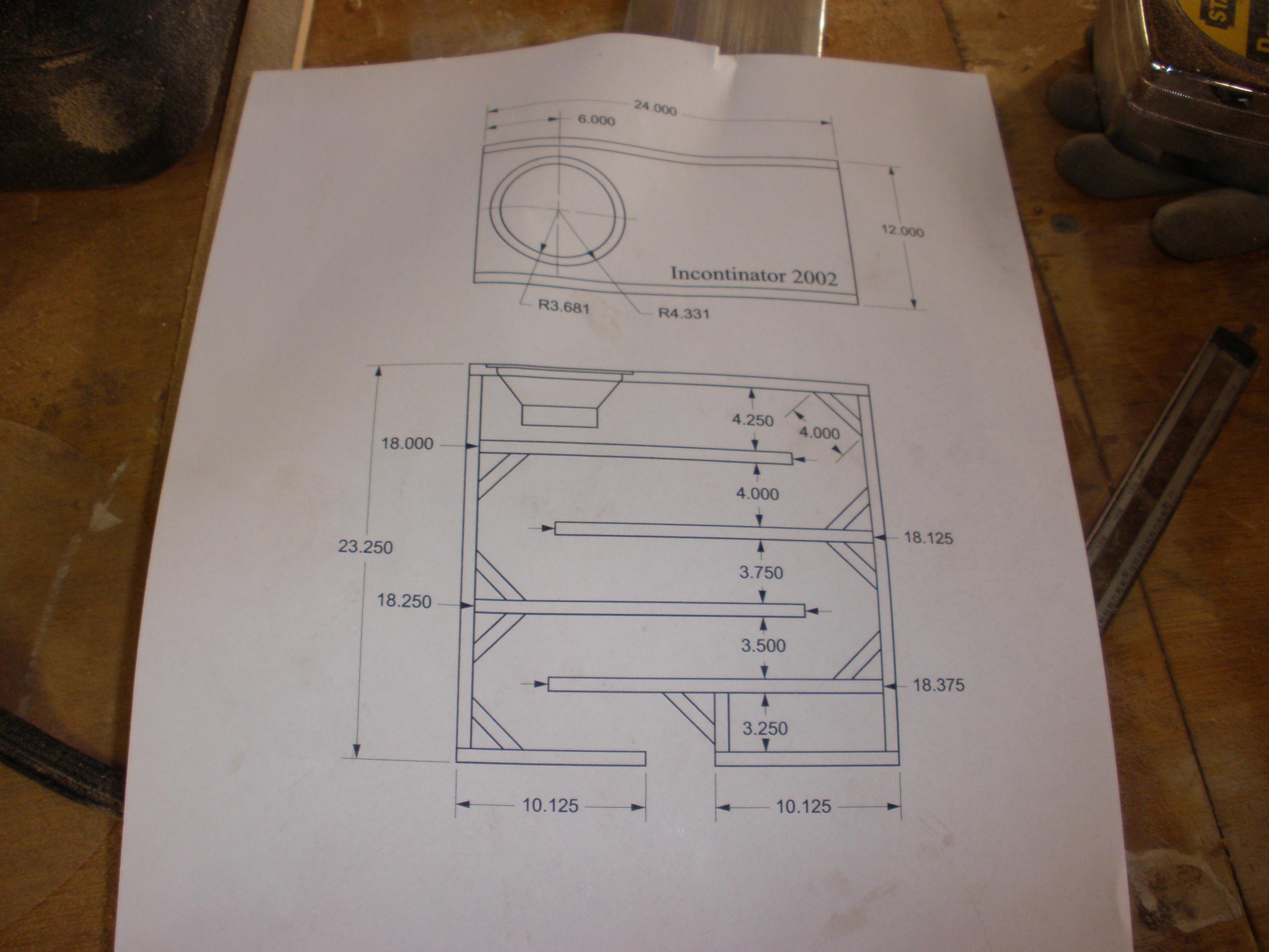

the second pic was a draft of my idea for my ESL's, come to find out that someone had allready done this before, i forget his name as my post was lost. Either way, i give credit to the idea, fantastic!

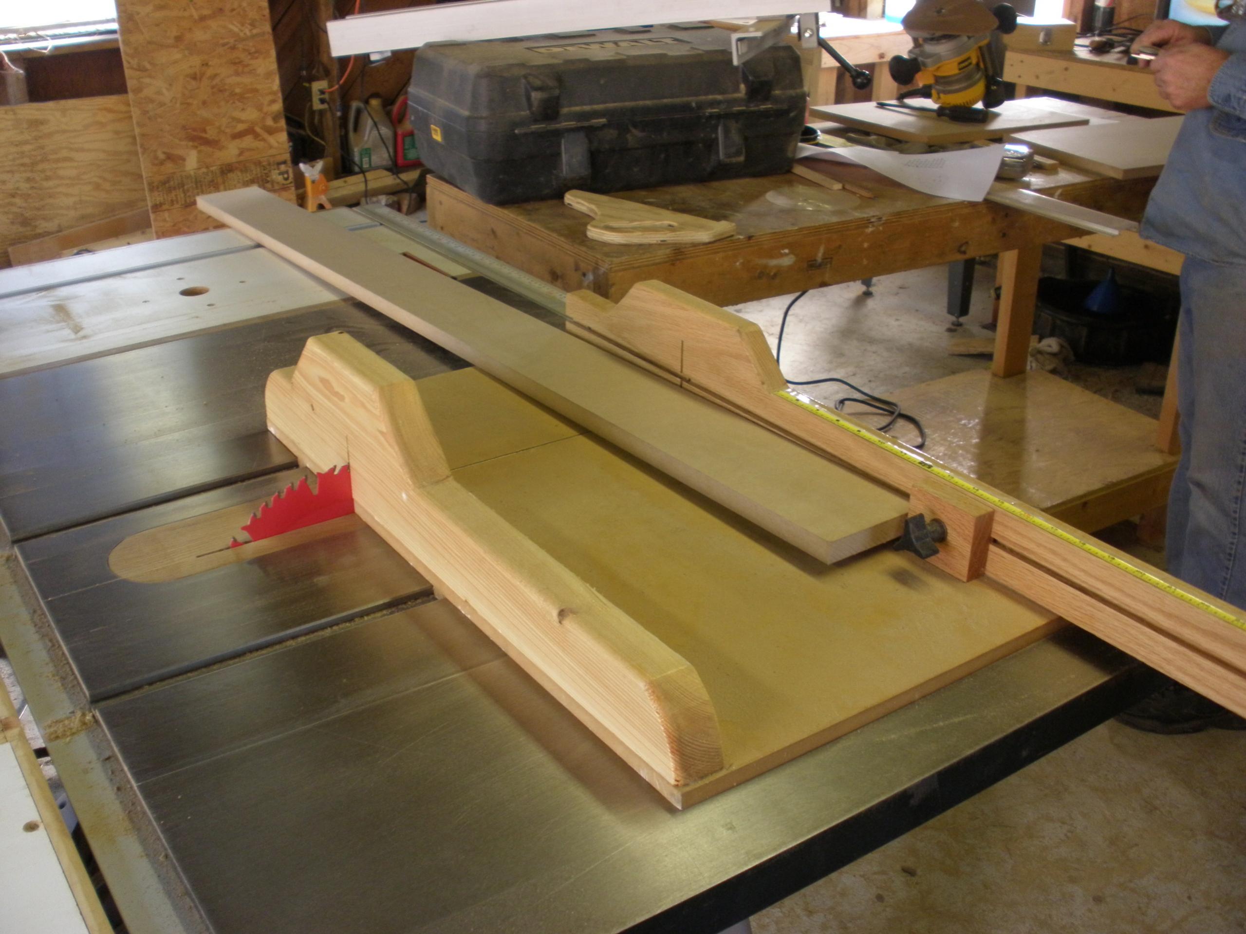

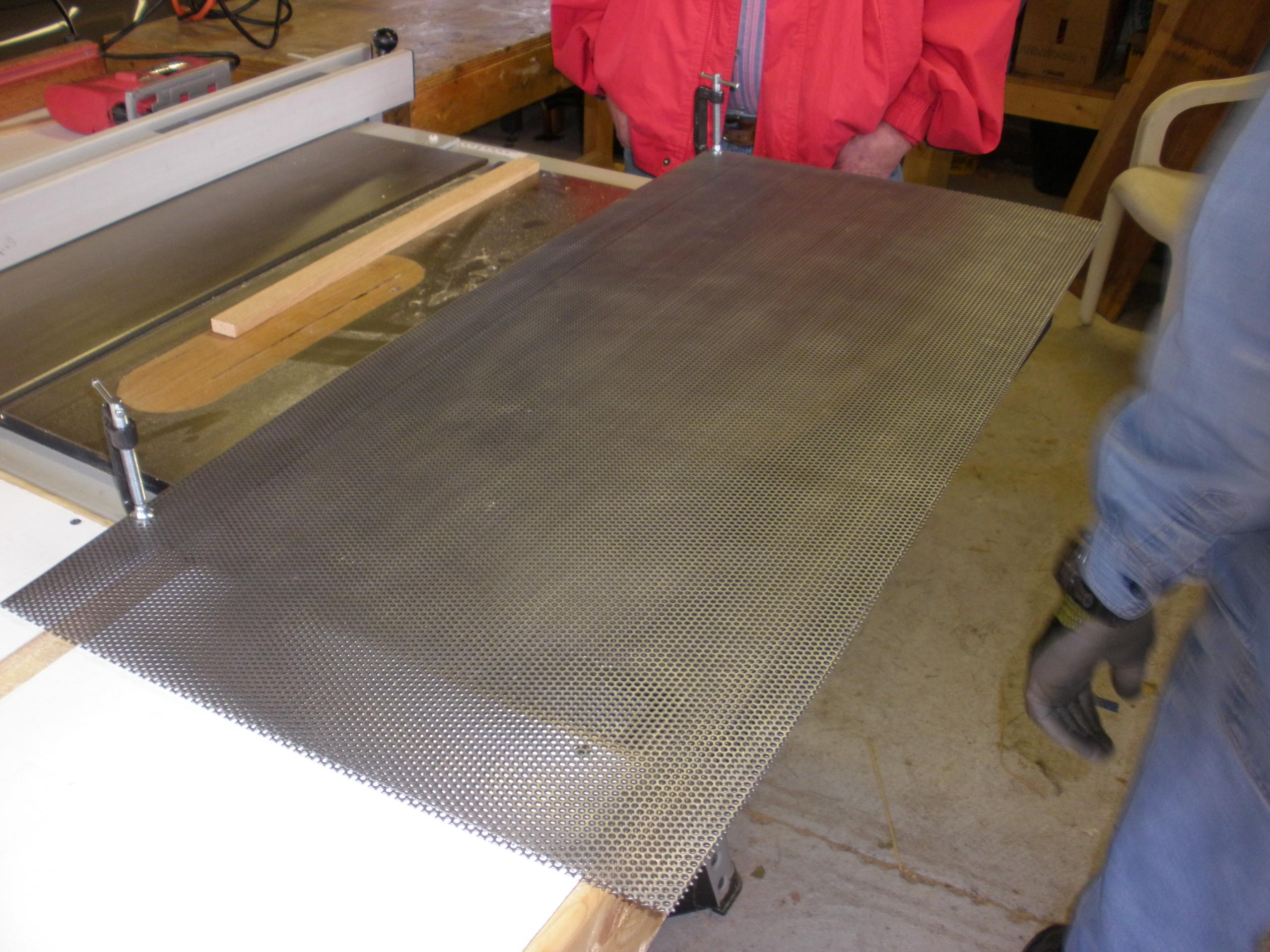

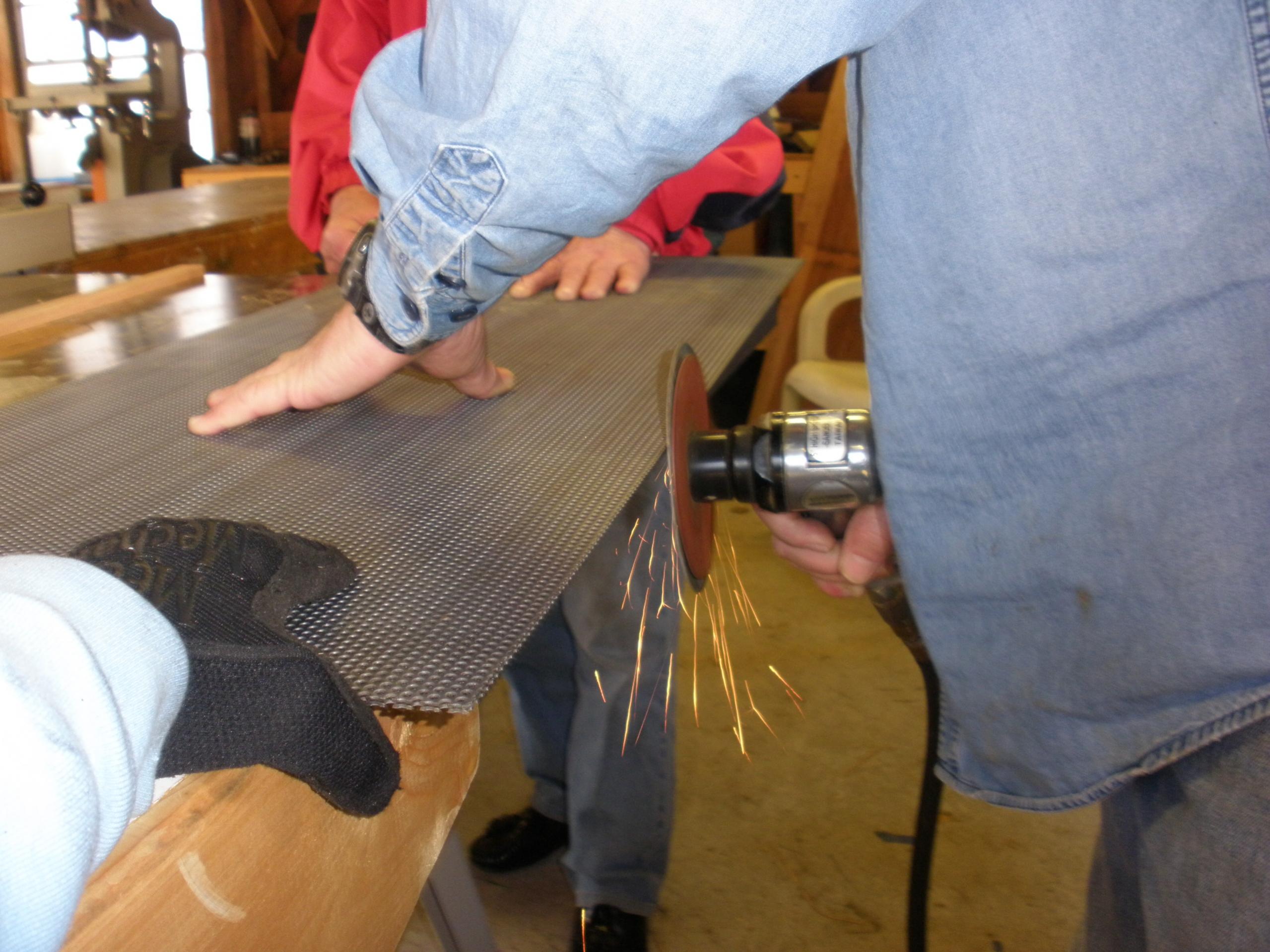

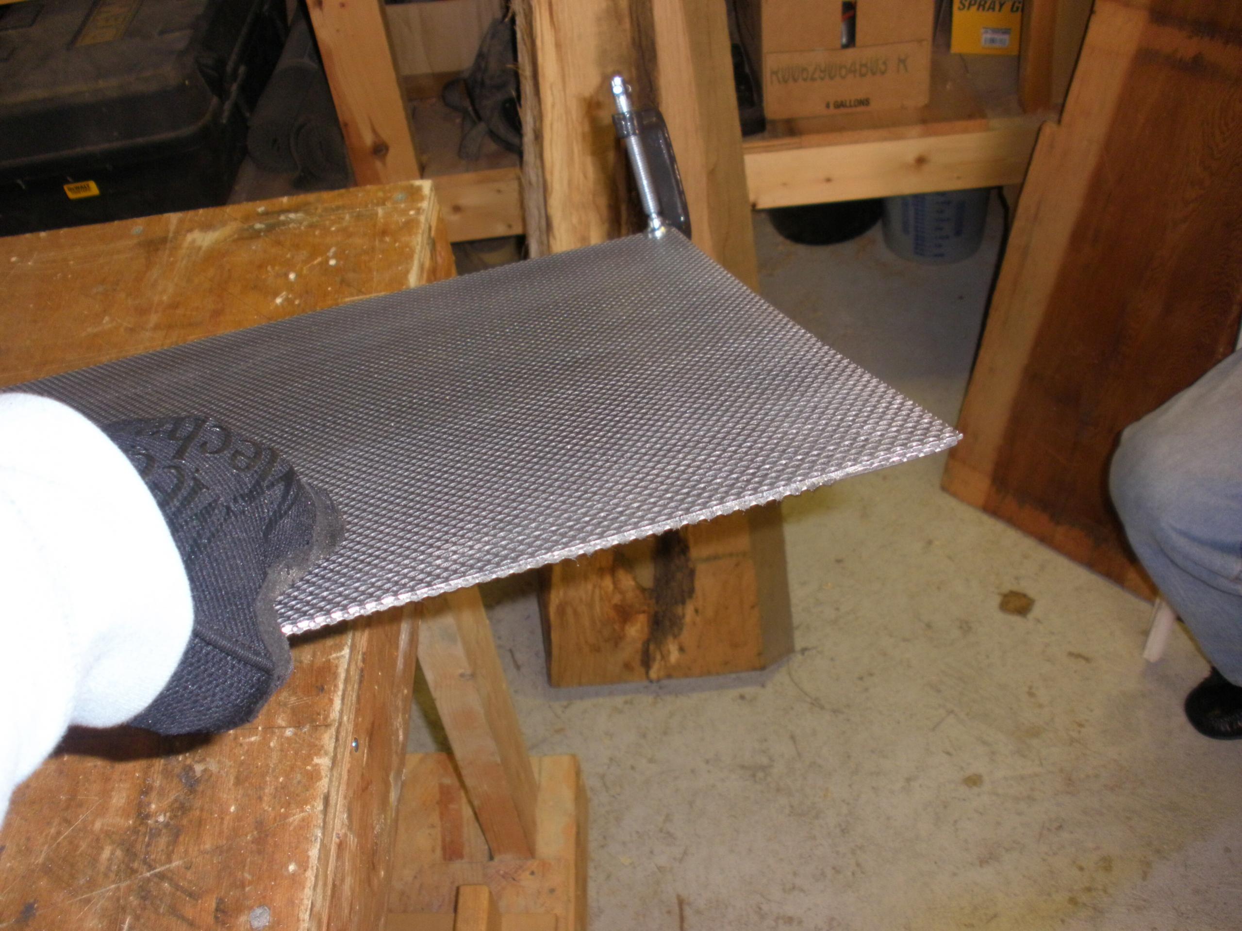

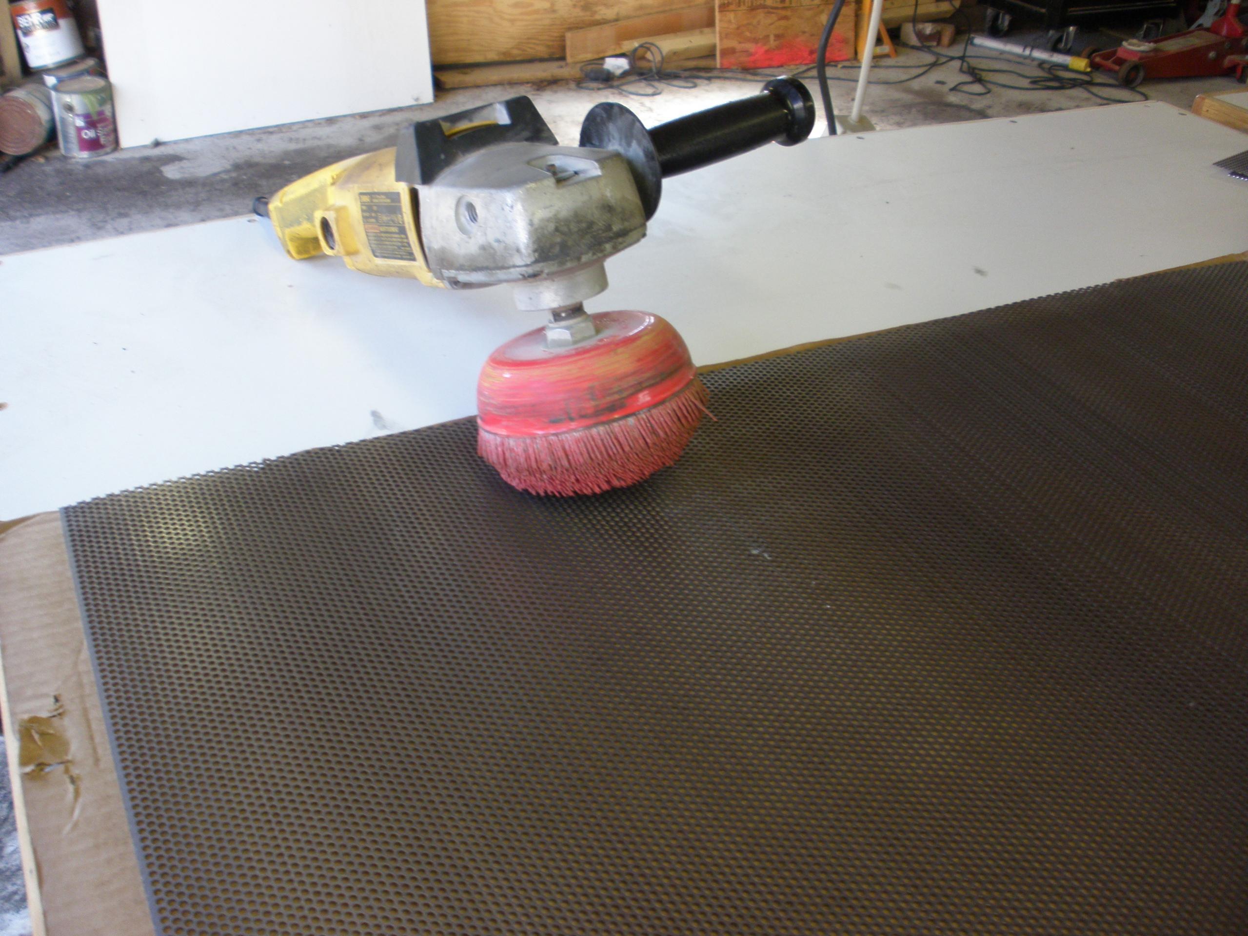

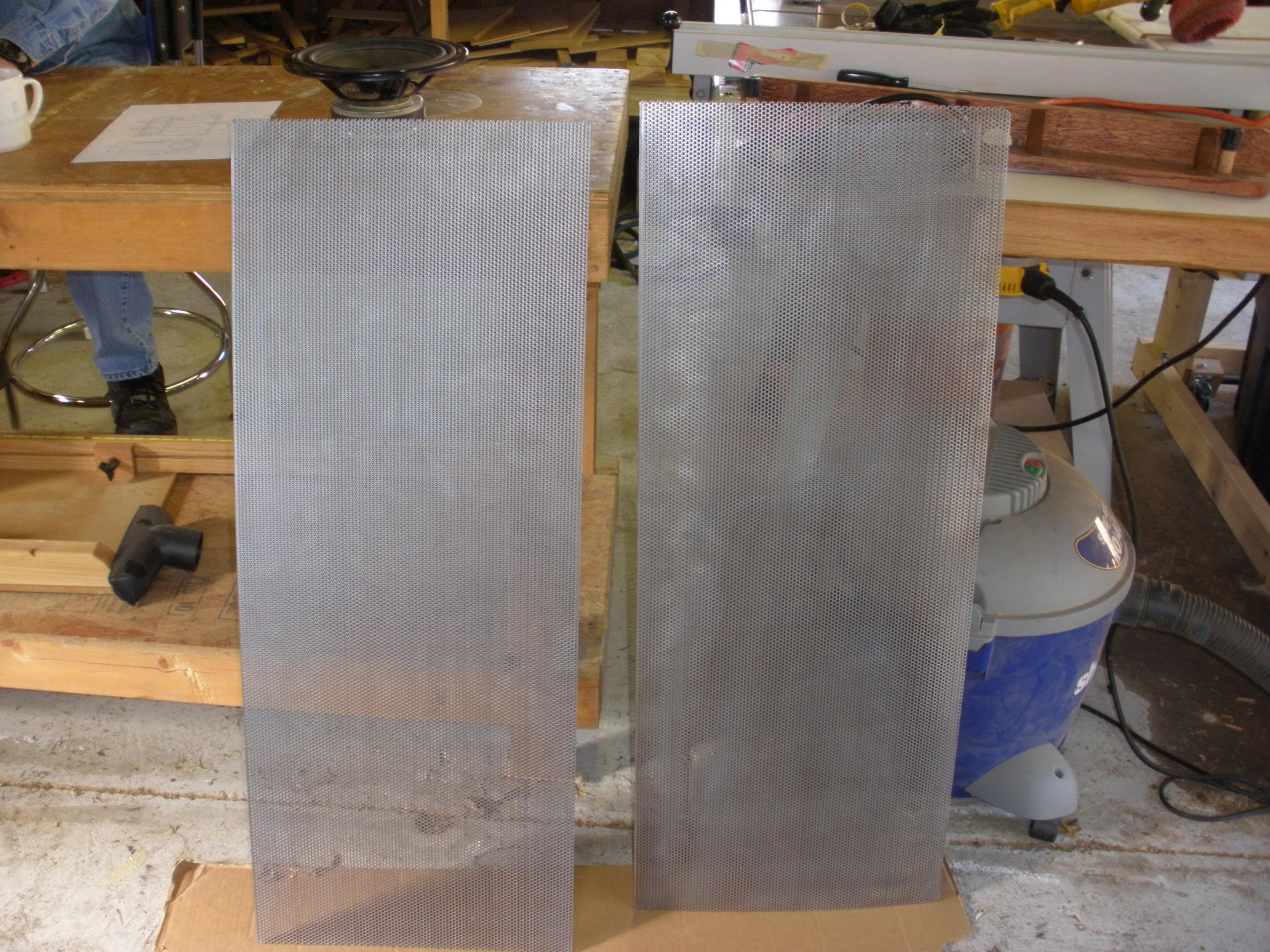

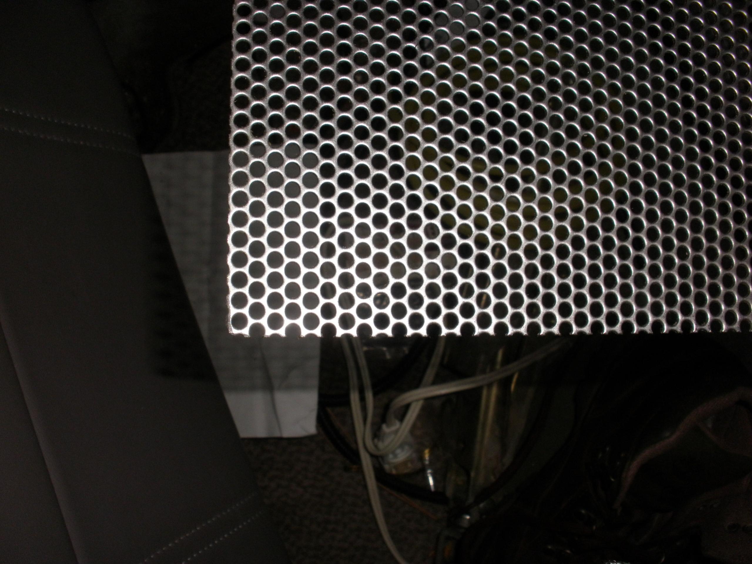

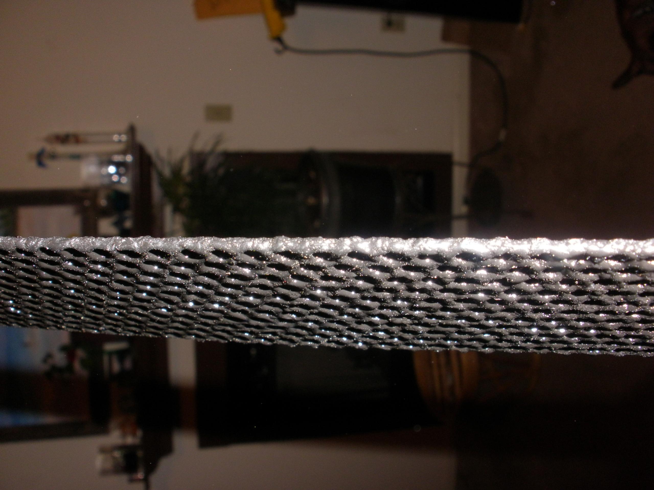

the 3rd pic shows alighning the panels for cutting as well as grinding to smooth the edges and remove any sharp edges as from what i understand is prone to arching. My father as well as Charlie overlooked this procedure.

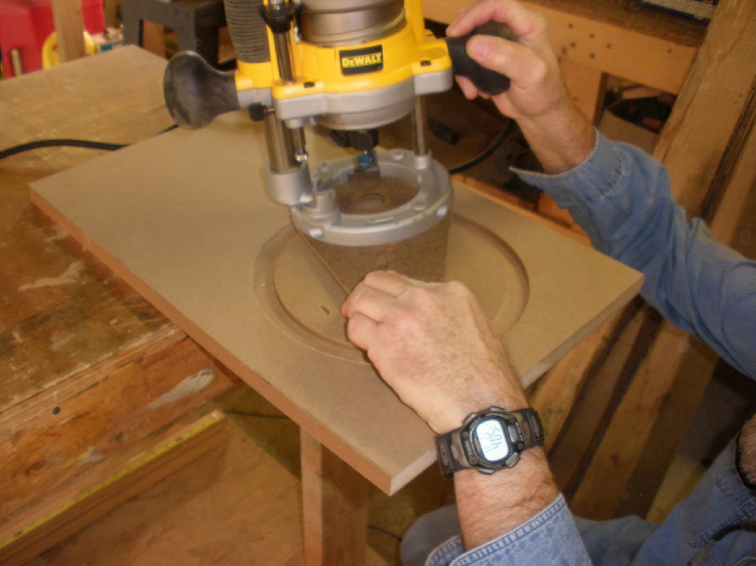

some of the other are building the TL enclosure. Using one 8" carbon fibre driver in a quiet large enclosre, you can see that on pic #128. Charlie has now begun to flush mount my sub panel using a drop router, it made one heck of a mess, but was perfect. those TL's will be coated as well, it will increase the thickness of the box as well as dampen any resonance due to such a large box. they will have about 100 mills of rhino applied on the TL as well as my stat supports.

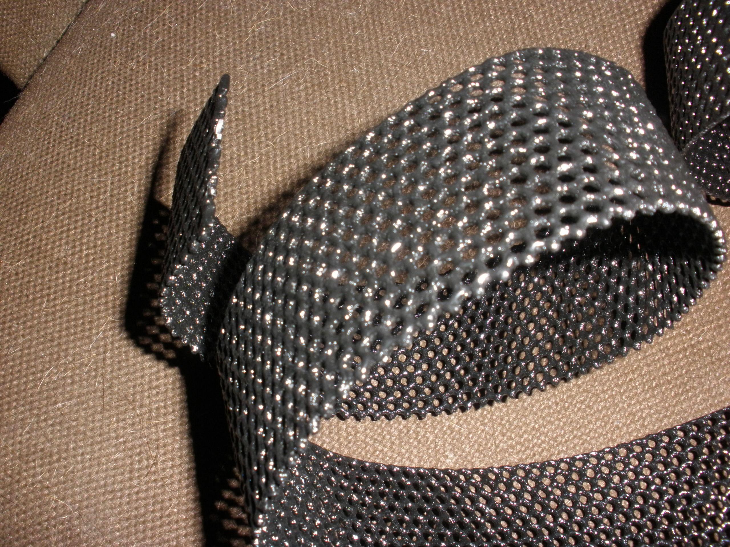

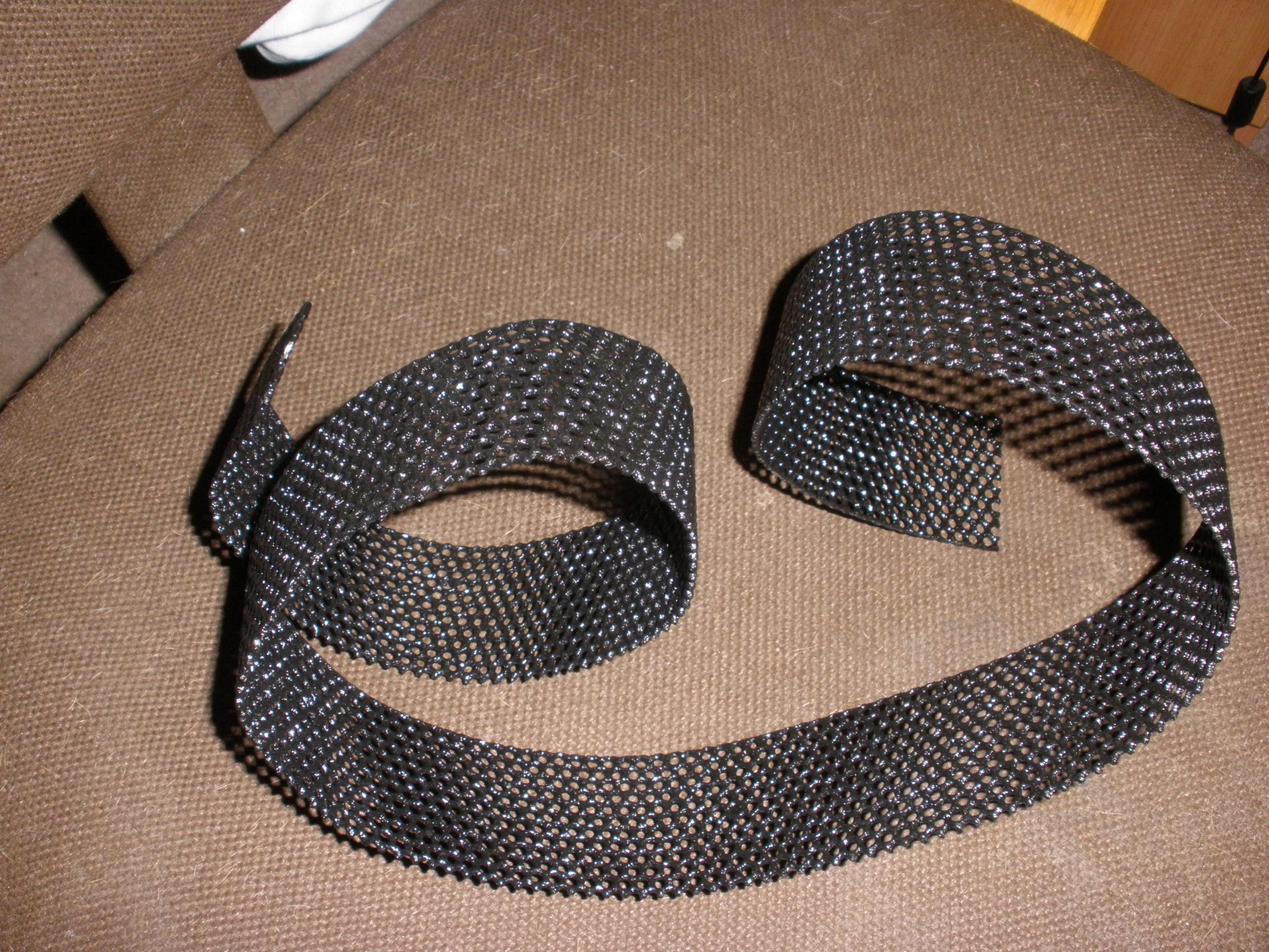

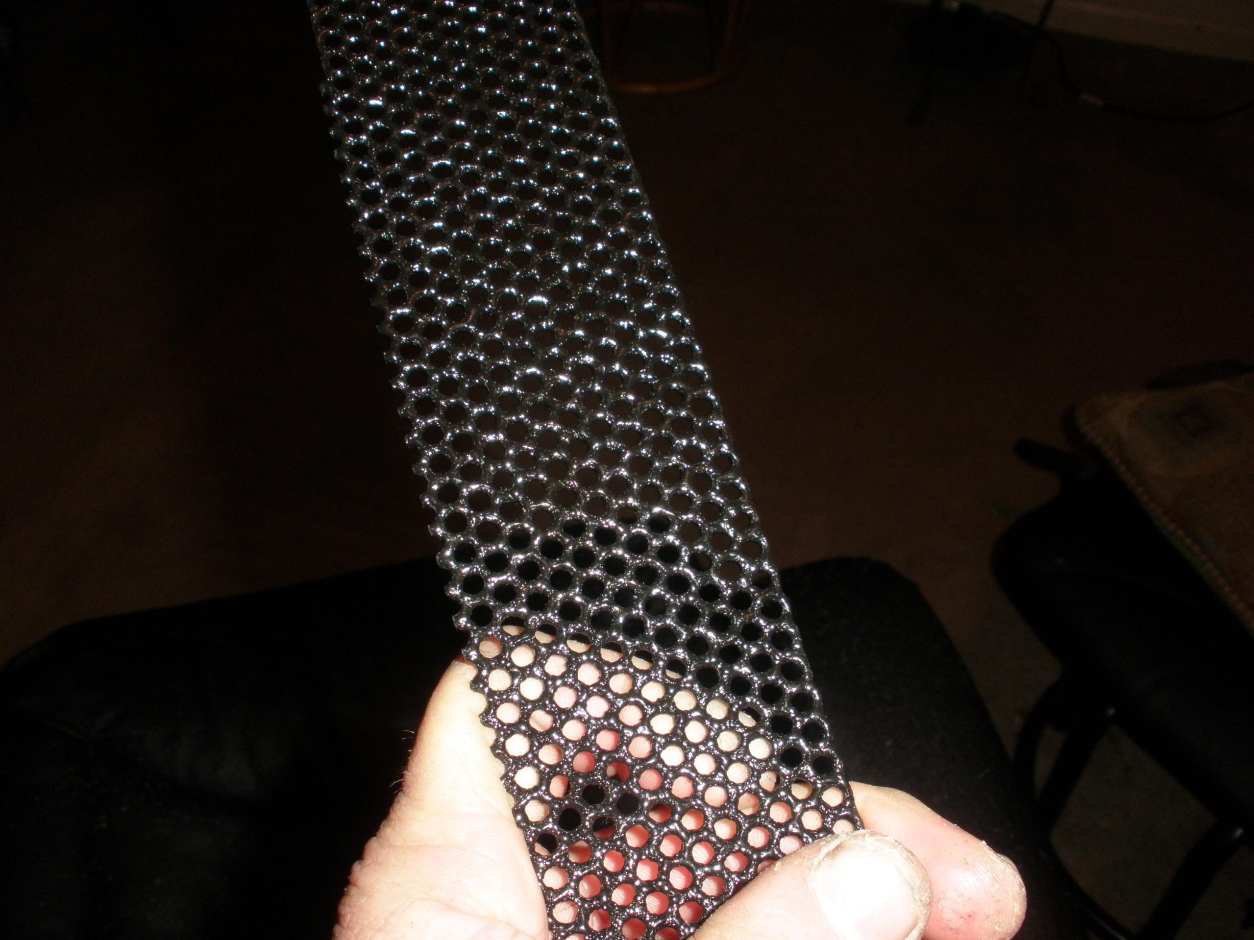

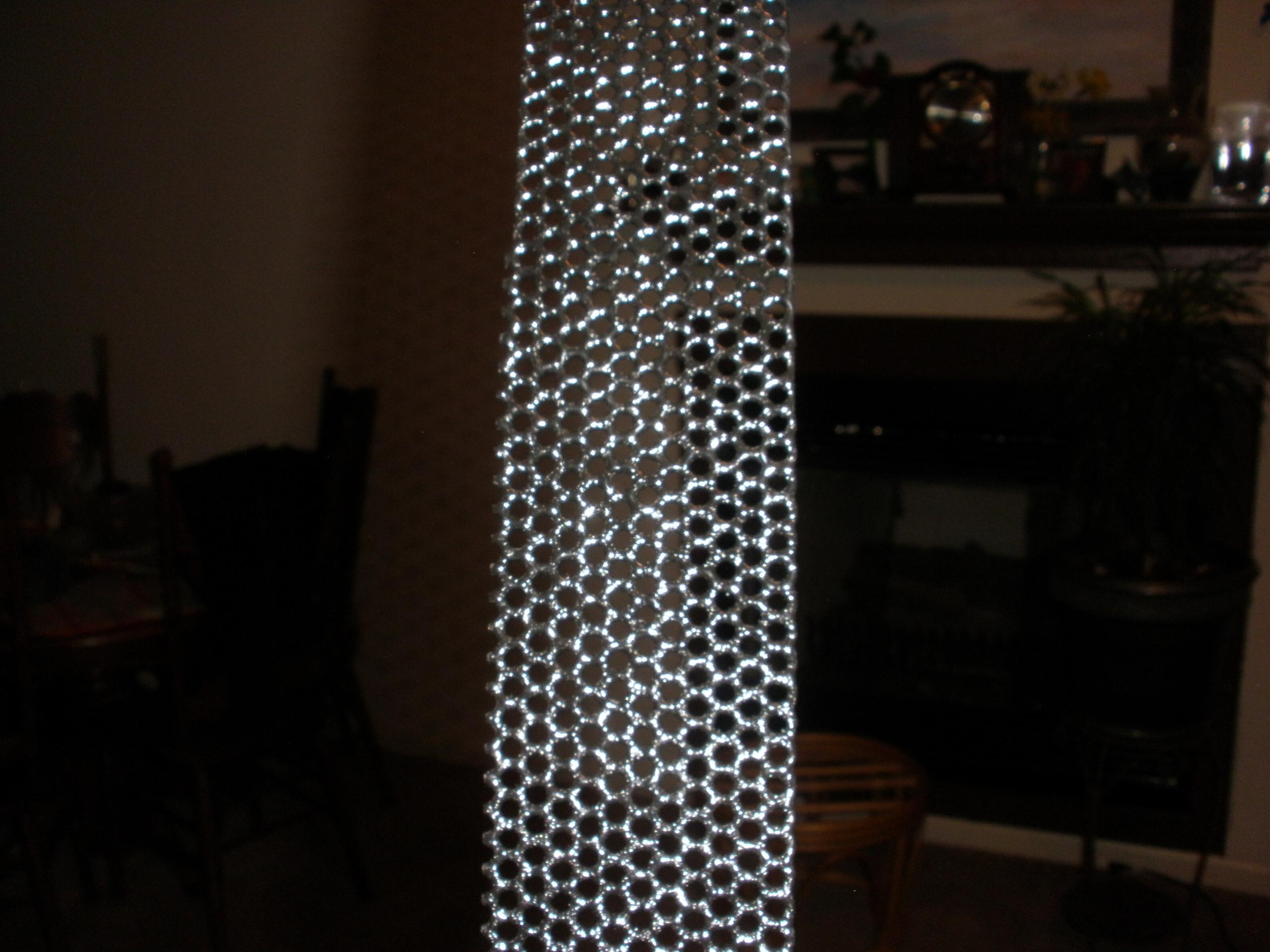

and now some good news, the stator that i sparyed is very durable, inexpensive, and i do not see anything like it. you can bend it, fold it in half, it does not matter, the material will not move off the surface or break or tear, so sometime next week, i will spray my primary panels and arch test them.

exactlly! thats why the build we be detatchable if you see. this driver i am using will carry up to or above 500hz, thats why the cross over is in the desighn, i do not wish to have a full range stat, rather, have my mids/highs vocals on the stat and the the sub do its job. i love a TL, and with this desighn, i can change it, if need be.
i will post some pics of the stat panel, as it will be floor stand or mounted atop the TL, this is a bi amped- active cross over network. I want the abbility to attenuate the sub as music is recorded differnt from one company to the next. thats why i hate MP3 format, awfull. i love analogies now.. since i heard a professionaly built planer, its like going from a bycycle to a race car, i like the race car, the bycycle can do what a race car can.

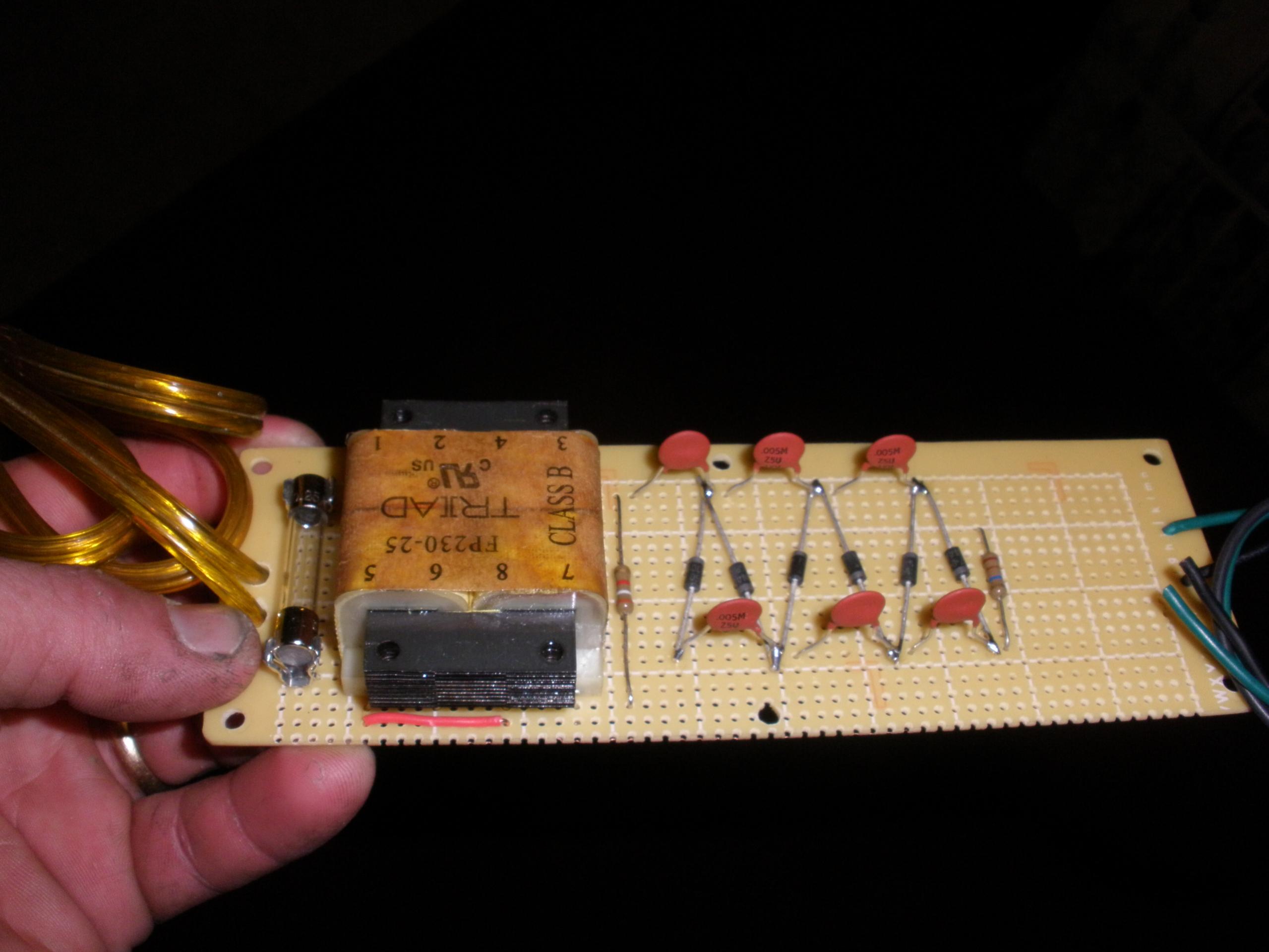

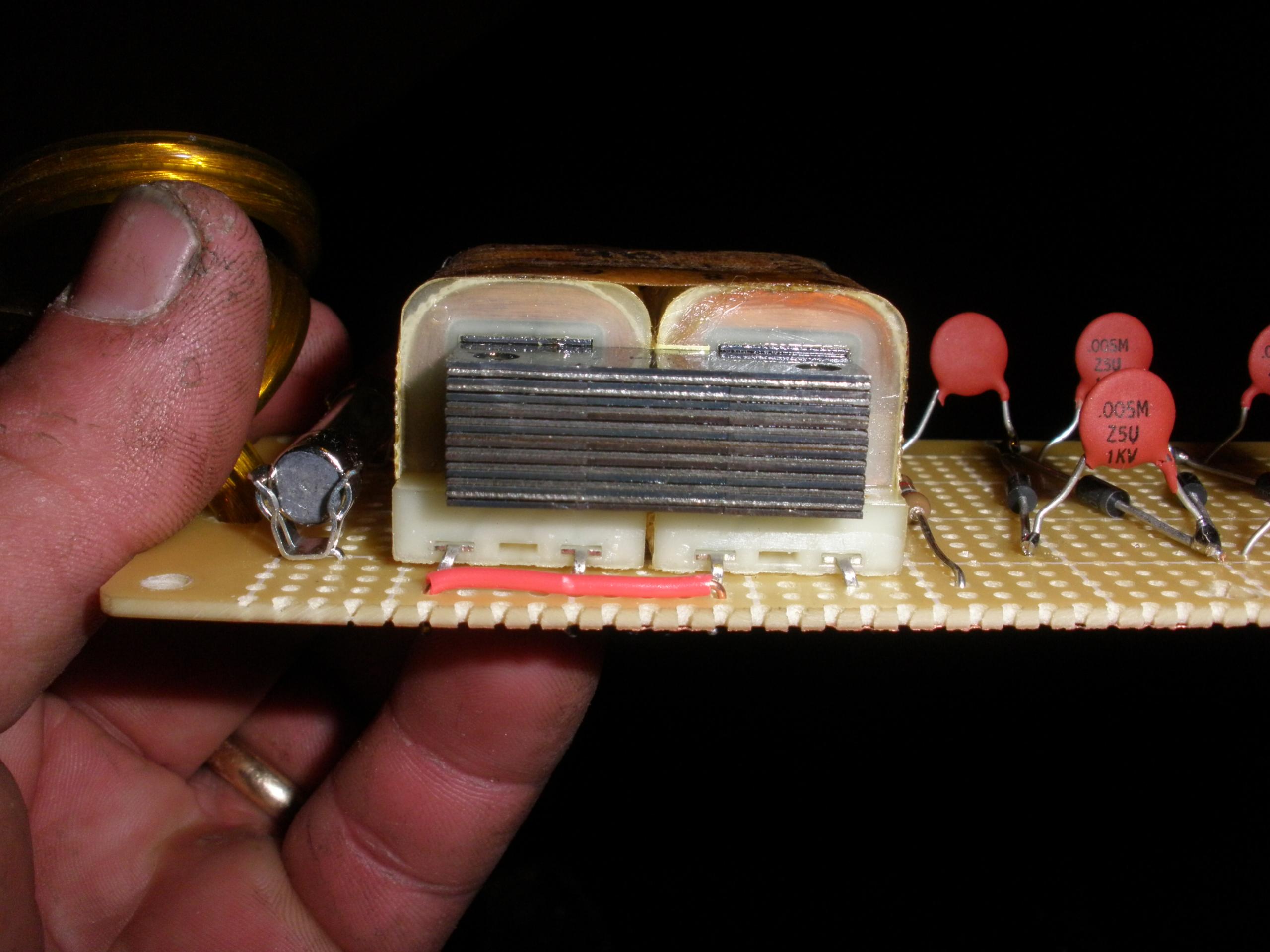

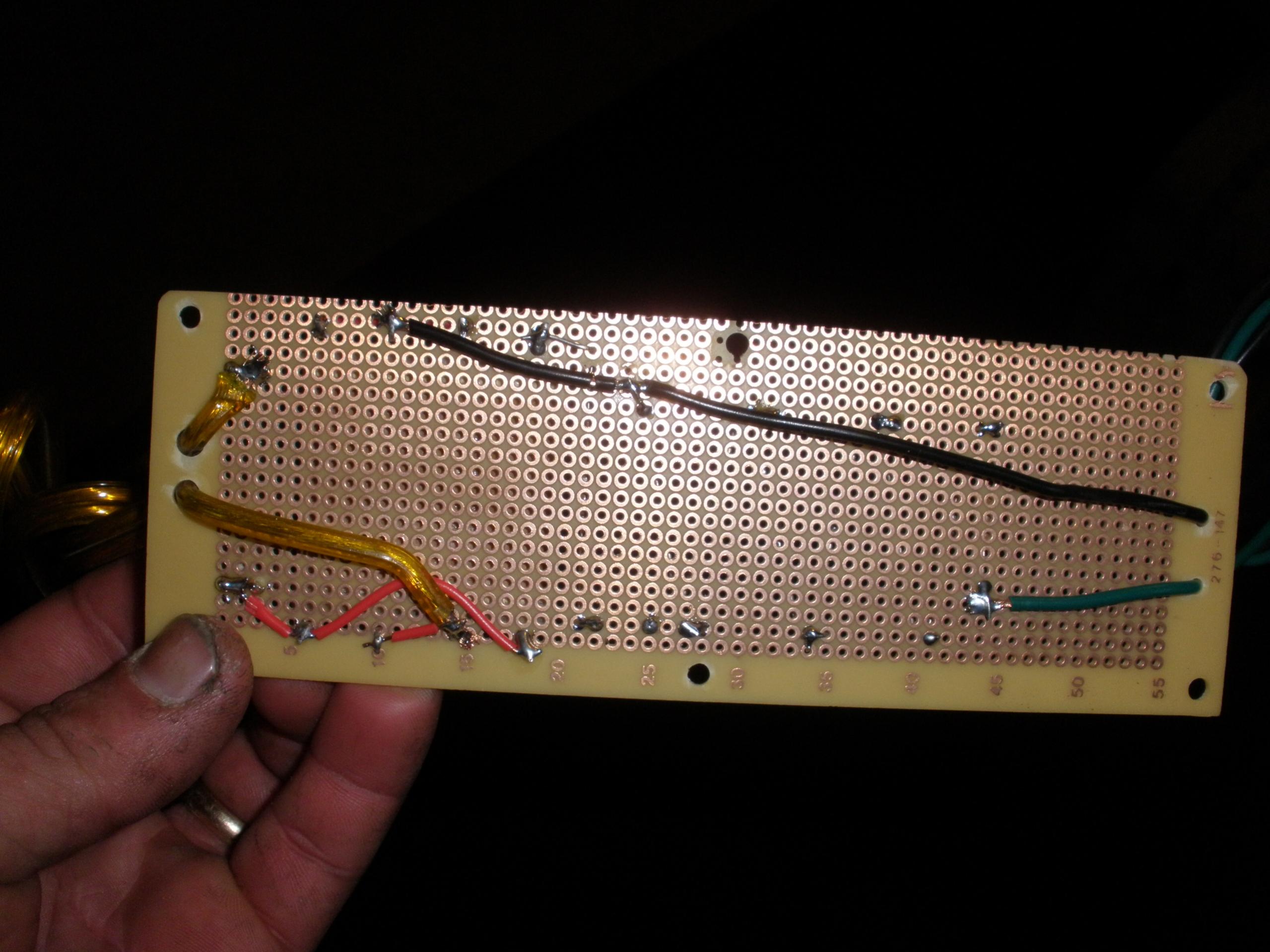

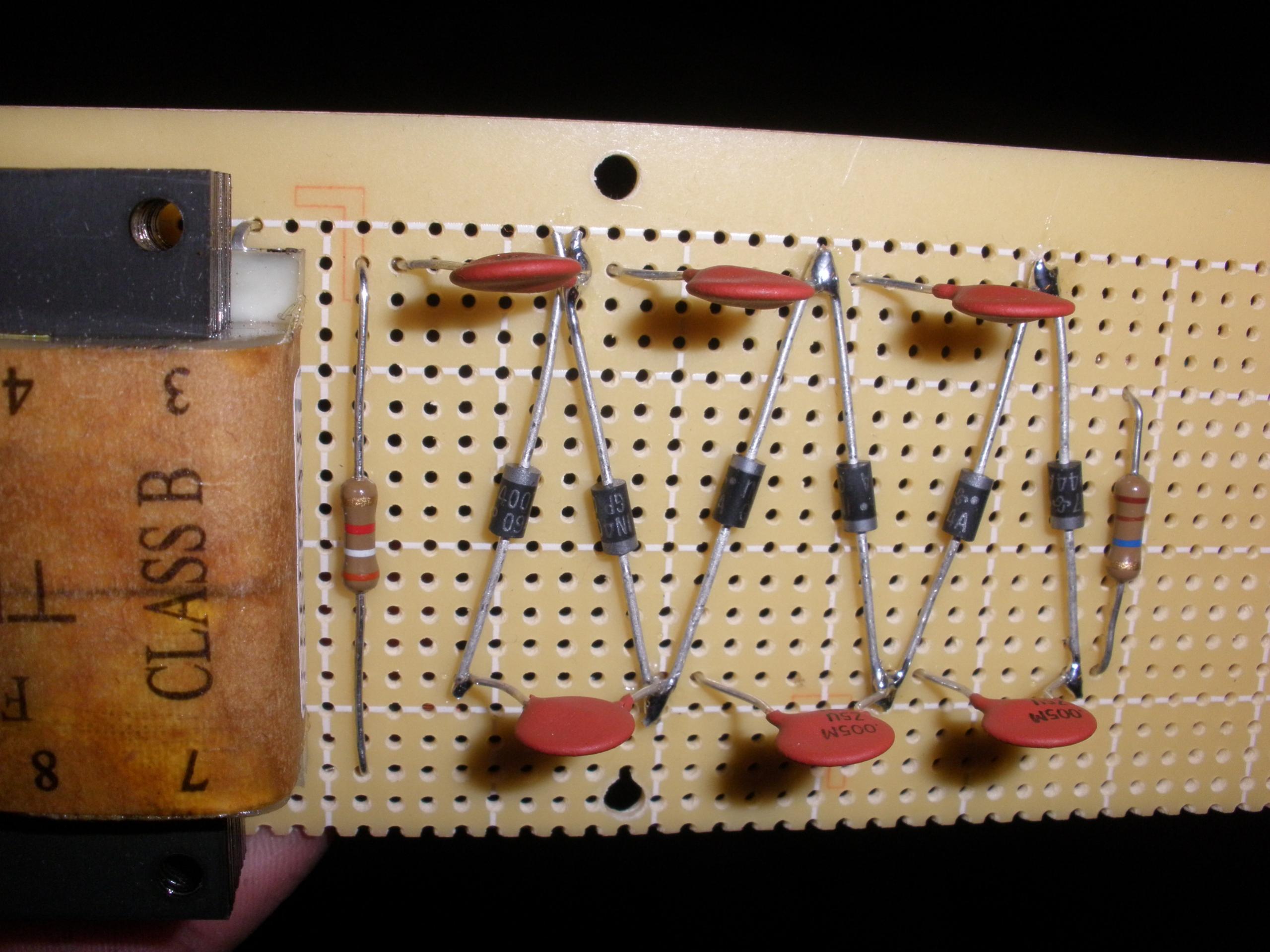

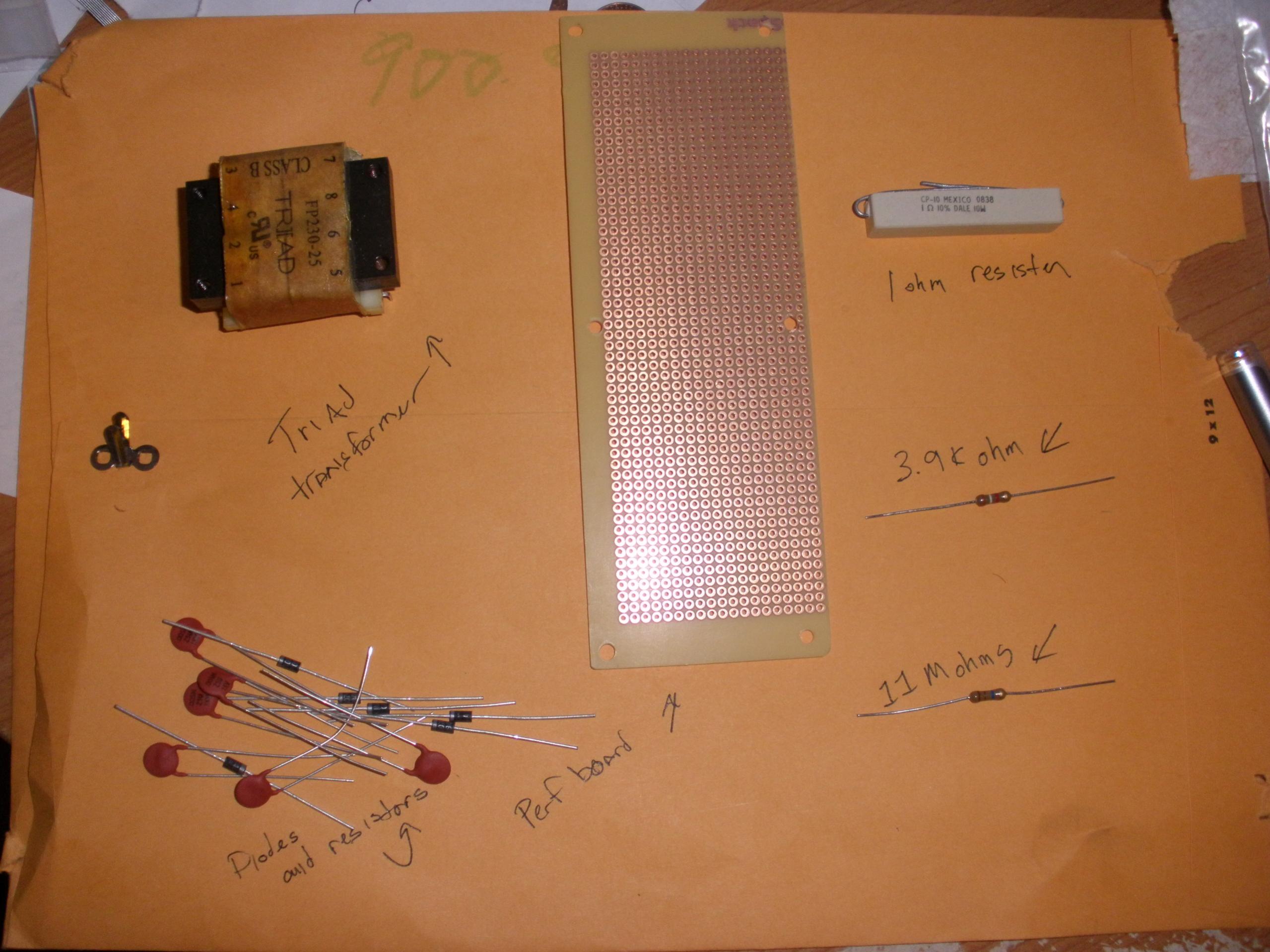

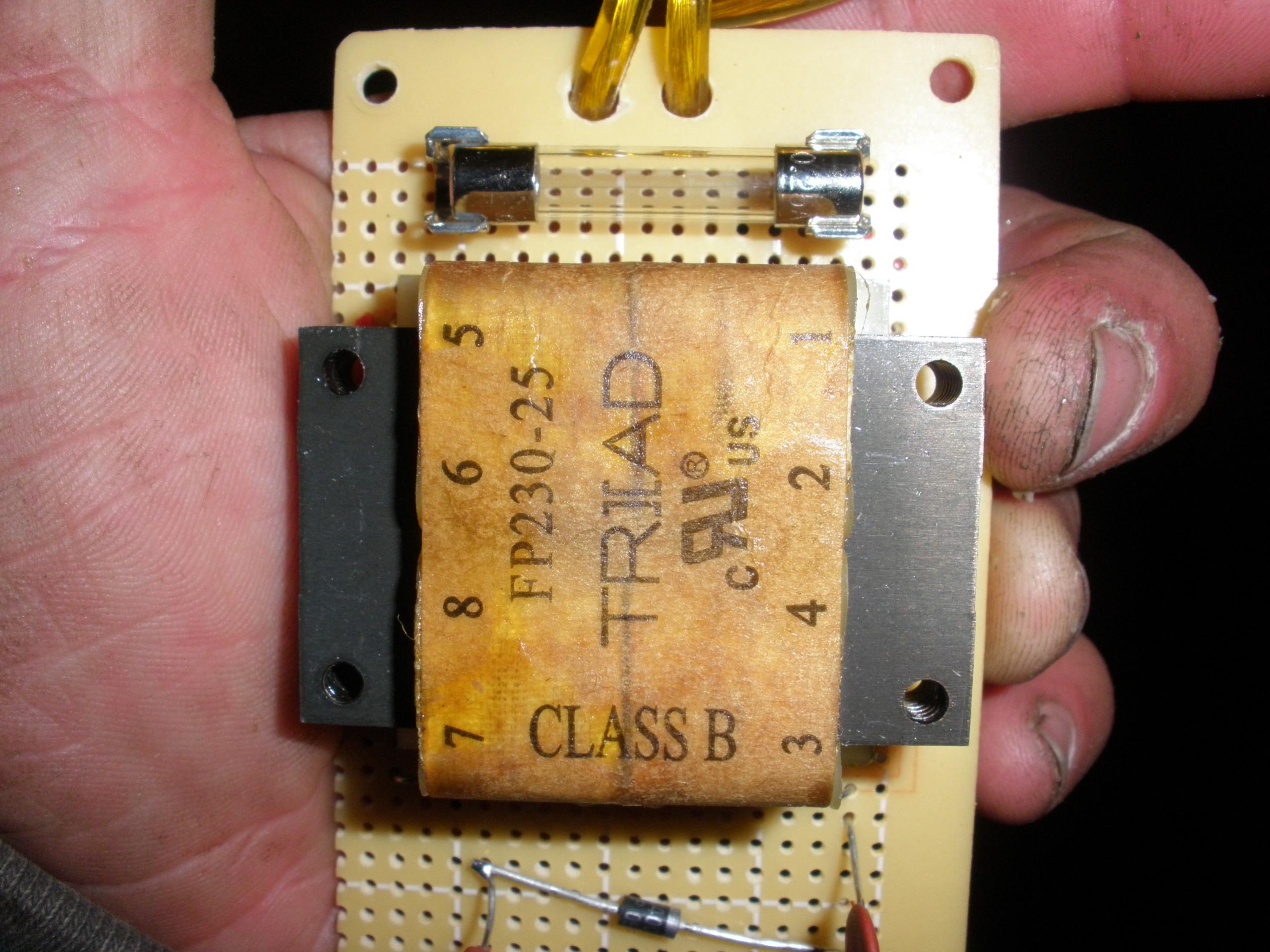

some more pics up the step up transformer. Hi-pot tested @ 2000 vrms. the transformer is made bt Triad Magnetics, there are six diodes placed as anode and cathode opposing each other as well as ceramic caps as a filter, it is fused @ .25amp @ 250v.
This is something Charlie developed and was kind to share his experience and expetiece, he deserves the credit. However, he left the other one for me to build, will show pics as soon as i can, see who can solder better, JK. there are as well, but no pictures of 1 ohm 10 watt wirewound resisters that will come into play. so far, thats it, so busy at work, barely have time to share and explain this to anyone trying this first time.
I will keep my info clean and stay on subject.
There is also better pics of the Begringer crossover, has clipping alerts as the Adcom amps have them as well, two safe gaurds to me, class AB does not like a flat wave, clipped curve or however you can describe it, not good.
please feel free for any advice or critisism, thanks.
I have all the technical questions about these compents in case someone needs to know tolorence or things of that nature.

i like the looks of that crossover,if it deosn't seem to work right you can just send it to me and i'll give it the once over for ya !(he he he he heee) jer. p.s. tip : i would grind away at least one row of those pads surounding the diode conections and at least two on the output to safe gaurd against any arc over between the pads as you know it can get pretty humid in the summer time. as air has a breakdown of 100v per mil
I plan on spraying that as well, just cover the compenents, and spray the board. like the back side, simple, cover and coat.
i am curious about the once over, i am only using it for sub "mono", but notice there is no stereo out, i will take a better look at this, as i need this for my stats"primary" subs are "secondary" . the subs will probally be the last, i need a stereo cross over for my stats, and from what i see and have, this will not work, or will it? let me know if you need more info Ger, allways appreciated and noted. Mav
just use it in stereo two way mode and when you turn off the subs you just sweep the frequency all the way to 44hz and this will pass all but the the extreme lows to the esl's.there isn't much if any thing going on below 44 hz anyhow and you probably won't notice the difference with the kind of music we like. jer

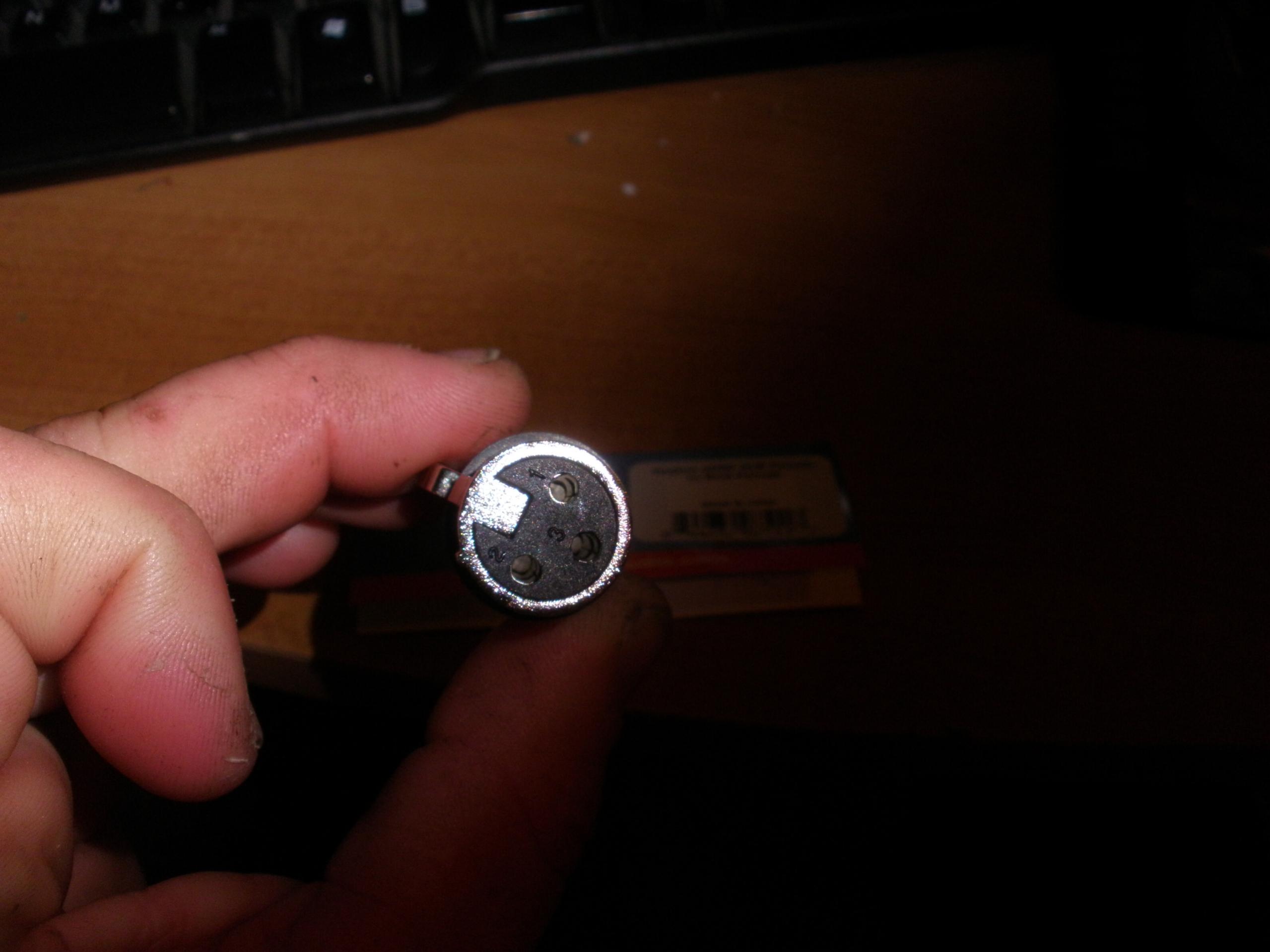

Ger, these are the doo hickies they sent me, it looks like one common ground, but does not have 2 channel out, just one rca out, that corresponds on the out put of the crossover. i am pushing my 45 day limit with thing and as i read it still states stero output. If you need pics of the manual let me know please, as this is crucial, i cannot run my stats full range with what i have. especialy listining to PANTERA, SLASH, GUNS N' ROSES, STONE TEMPLE PILOTS, EXODUS, BLACK LABEL SOCIETY, OZZY, AC/DC, GAMMA RAY, KEEL, YNGWIE, JEFF SCOTT SOTO, and so on, if someone starts kicking that drum, i dont want the diagphram to do the same.
if it needs that once over, i will ship it to you and let you at it. its just i have so much money tied up in material now. from perf metal, MDF which i stilll need more of, to my coils, step up transformer, the laundry list goes on.
as this is a start to finish, i will post all material i am using and time invested, friends like you cut it in 1/2 so that will be un chartable. here is the XLR doo hickie,thanks Ger, again.
