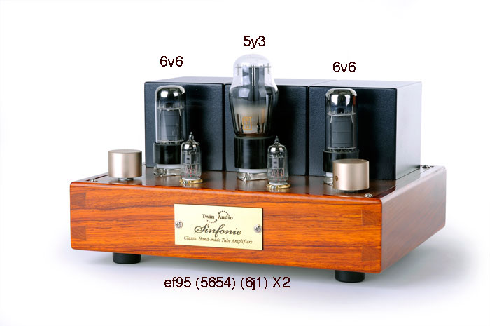

Tony Wong's 6V6 4 watt - Pentode with Triode connections currently powering Alp5, Alp6, Alp7 and Alp 10 protos

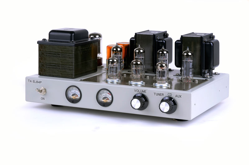

Tony Wong's EL84 12 watt-push-bull -Currently powering Alp 10 (existing model) Alp7 and Alp 12

6V6 is power tetrode and EL84 is power pentode. This mini 6V6 amp is under single end class A circuit. The plate voltage of 6V6 is 250V in the amp and the plate current is 35 Ma. EF95/5654/6AK5/WE403B is a low noise RF voltage amplifying pentode with miniature 7 pins. We adjusted the plate voltage of EF95 at 140V in the amp and the plate current at 2 Ma. The pentode EF95 is under triode connection for 6V6 single end circuit. The reason is 6V6 is easy to be driven and if EF95 is under pentode connection, the gain ratio will be too high, but if under triode connection, the gain ratio will not be so high. Many people like the sound of triode and believe it is sweeter and warmer than pentode.
Tony.

For a beginners kit, a gainclone (peter (audiosector) or Brian (chipamp.com)) if SS -- i like the 1875. A tube amp will probably cost more and be a bit more work, i'd suspect a PP would be more appropriate but the TubelabSE might well be the easiest. Getting lucky and finding a good donor amp can shift the cost of tube amp considerably

1 - Tube amps, a 300B single end around 8 watts or for a bit more power an EL84 pull-pull. More power still takes you to KT-88 push pull. The 300B is possibly the nicer of these options but good 300B tubes cost more. Good transformers and components will also cost for 300B. This choice might take you beyond the 300B if you want to do a nice job. The EL-84 is a nice compromise. Transformers are smaller and components should be easily sourced at affordable prices. 4 X EL84 tubes in push-pull is enough power and tube prices are more affordable. Going to KT-88 may be a bit of over-kill on power.
2 - If the budget can't stretch quite so far and the kit idea becomes too challenging, keep an eye out on Ebay and alike for anyone selling off their project. Could be your lucky day. I recommend searching for the tube amps types I've mentioned. But also any Sansui 907 series and Sony Taf-333EX or 555EX series Mofsets. Sometimes, these amps pop up for moderate money and provided they've been looked after, will do you some musical justice.
Try to avoid buying into a cheap tube kit. With $500 bucks as the budget, this rout may be tempting but risky as you may be restricted on the quality of the components. Watch out for some of the cheap "Chinese built" tube amps. They look good but their components aren't up to much. While others China brands are good but the cost is up.
