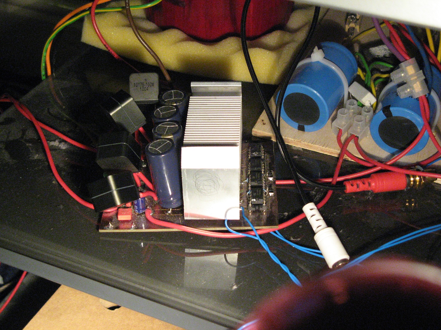

So without further ado I present you with a low quality picture with very poor lighting of the TAS5630 PCB + components on it's shelf. (No I've not made a case yet).
Here you can see the Ice inductors soldered in place on their little wire stilts. As you can see the entire PCB for the amp isn't very large at all.

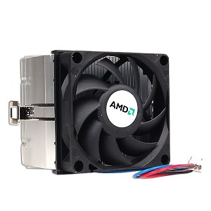

The heat sink I chose to use was an old AMD cooler that I chopped in half. It looked like this...
before I went at it with the hack saw. I chopped along the two slits that held the retainer clip and ended up with two nicely sized heat sinks.
I strapped a 17 watt power resistor two one of them and measured the performance at something like 4.5 degrees per watt without any fan cooling. With fan this decreased down to around 0.5 degrees per watt, which I found a little hard to believe. Either way, when the 5630s are idling the heat sinks get warm to the touch. The old inductors I had would get really hot at around 65 degrees centigrade, the Ice ones run much much cooler. You can barely even tell the amp is on, that's how cool they run. Changing inductors also had the knock on effect of placing less stress on the main chip as that runs cooler when idling as a result too.

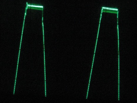

Next are two scope pictures showing how the output filters affect the carrier frequency. The carrier wave simply looks like a messy square wave, it's peak to peak voltage spanning the +ve supply voltage on the Half bridges, which in this case is around 45 volts.
This is at 2 volts p-p showing the effect of the output filter on one side of the bridged output. If my arithmetic is correct this shows ~27dB of attenuation.

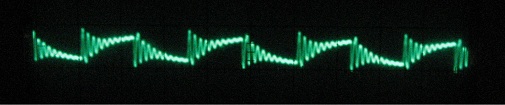

In bridged digital amplifiers TI allow you to use a function called BD modulation which they describe as.
BD modulation — modulation scheme developed to greatly reduce or eliminate the output filter. The
filter-free modulation scheme minimizes switching
current, which allows a speaker to be used as
the storage element in place of an LC filter and still lets the amplifier be very efficient.
The knock on effect of this is that you can cancel out some of the carrier frequency when the +ve and -ve outputs of the amplifier sum.
As a result we end up with...
This shows a drop to 0.4 volts p-p, further increasing the attenuation of the carrier frequency up to ~41dB.

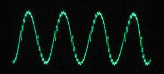

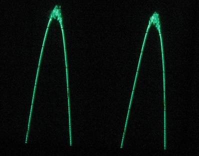

Next up some clipping.
First is a graph of some very mild clipping @ 1khz showing the spectrum of the harmonics produced.
And next a scope picture of the same.
And now 9% THD.
The 0.35% you could perhaps live with, but the 9% looks utterly horrible. No one would ever want to listen to anything with that going on, at least not if they didn't want to get a headache. Quite why TI quote the power level at 10% THD I don't know as it isn't really representative of any real world situation. Most people would turn it down if it got to that point.

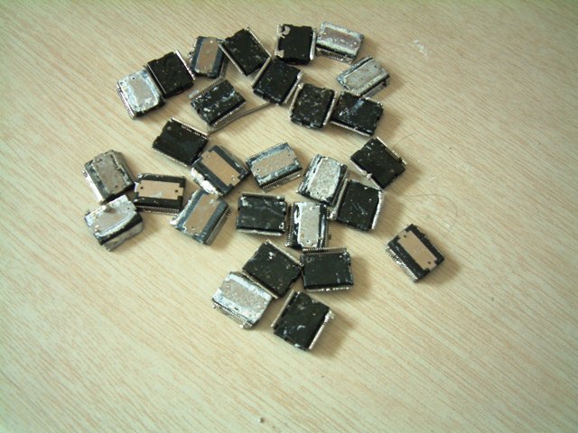

I can't understand ,do you realy get your data in your test ,when you adjust voltage to 50V,and output 2*200w/4ohm,and use your PCb,you will get burning.this chip refuse any over voltage pulse,Sound good ,Use carefully.
Pcb routing very importent.I have to burn one or two chip when I get it one really data,there are 50-100 burned chip in my waste tank.lots of money had married to TAS series,I have tested TAS5615 also,So trouble,don't use it at 50V,low voltage like 35v enough.works stablity.TAS series have excellent sound ,I think due to BB company merged by TI.good op amp and other special circuit inside.upload some of burned chip pic , so expensive.thus called "DIY".
Gosh that's a lot of dead chips :(
I have wondered if they can really put out the claimed 600 watts in PBTL mode. And I've always been worried about blowing something up when testing.
I too have destroyed 4 of them I think up to now, but that was from miss use.
A responsibility designer must know well you design product works good or bad at worst use condition,Never believe the data from lab until you try it yourself.when you finish it .you'll get stable product.discrete component circuit is easy analyze,IC not easy,block diagram not tell us details.you must try it many a time.
