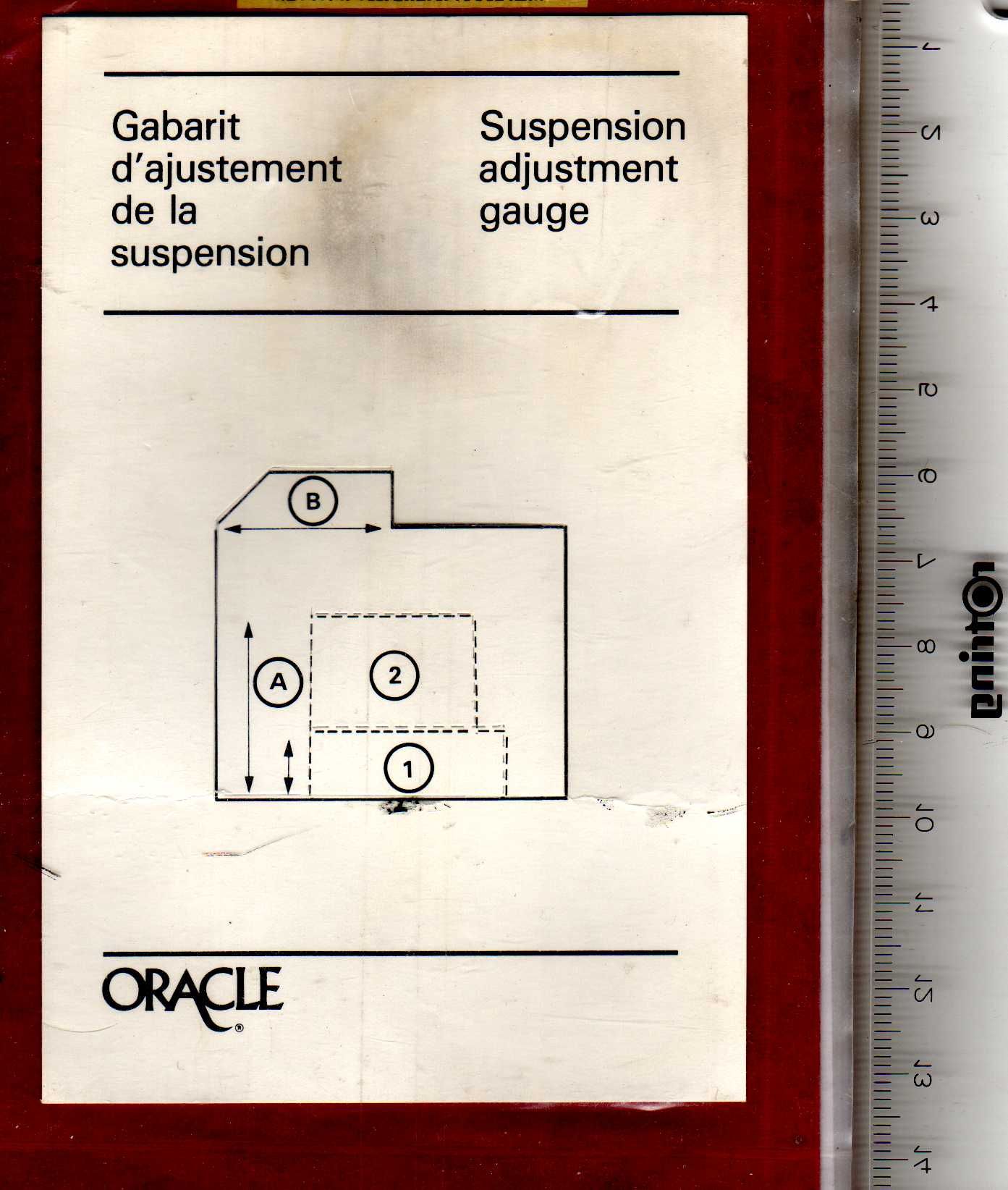

One part of the u- shaped gauge fits over the suspension pillar and is used to determine proper spring for each pillar. The gauge rests on top of the spring housing and should just touch the top of the centre post when the spring is the correct one. The distance from top of centre post to the top of spring housing is 3/4 inch to 13/16 inch (19 - 20 mm) according to instruction sheet from Oracle. My gauge actually measures 13/16 inch (21mm). This is for turntables serial number 1001 - 5694 according to one page of the instructions, but another page says 1001 - 6798.
There is a wider stepped portion at the bottom of the opening of the gauge which measures 5/16 inch (8.5)mm. On the gauge it is included as part of the 13/16 inch dimension, not added on to it. The instructions say this is for turntables with serial numbers 5695 - 8135, but the other page says 6799-9044, and the drawing doesn't show clearly how this step is used. Perhaps the spring housing is narrower and fits into the step. My Oracles are older so I don't need to use it and don't know about it.
A second part of the gauge is cut to determine the height from the deck to the spring housing after the proper springs have been chosen. Height is adjusted using the top knobs. The bottom of the spring housing should be 13/16 inch (20mm) from the table according to the instructions. At that distance it will rest on the cut out portion of the gauge. My gauge is actually 7/8 inch (22mm).
Altogether there are three measurements. One for older Oracles and one for newer Oracles to select the right spring for each pillar, and a third measurement for final adjustment of height.

Hi,I have lost my suspension gauge and know that you can make one out of carboard but need the measurements. If anybody can please post it will be greatly appreciated.
Thanks in advance.
Just scanned my original gauge at 300dpi - the ruler scale is in mm.
This gauge was from a Delphi 3, but as far as I know could be used for the original Delphi and Delphi2, as well as the Premier's if you have the proper springs and do not use the counterweight. If you look at the instructions/owner manuals - they are all stored at Vinyl Engine | The Home of the Turntable - setting the suspension with the gauge is only briefly referred in the manual of the Delphi3. The procedure is much better explained in the manual of the Delphi5, showing the gauge and suspension photos.

The Delphi is not easy to set up. If you get the Oracle I suggest getting their Maintenance Kit which includes new belt, a syringe of oil, new vibration dampers, and various springs to handle the weights of different tonearms. Most importantly the kit includes instructions and a gauge for setting up the turntable. Set up doesn't require a lot of skill or special tools, but does require patience. Setup instructions are also available at Vinyl Engine so you can take a look before you leap.
