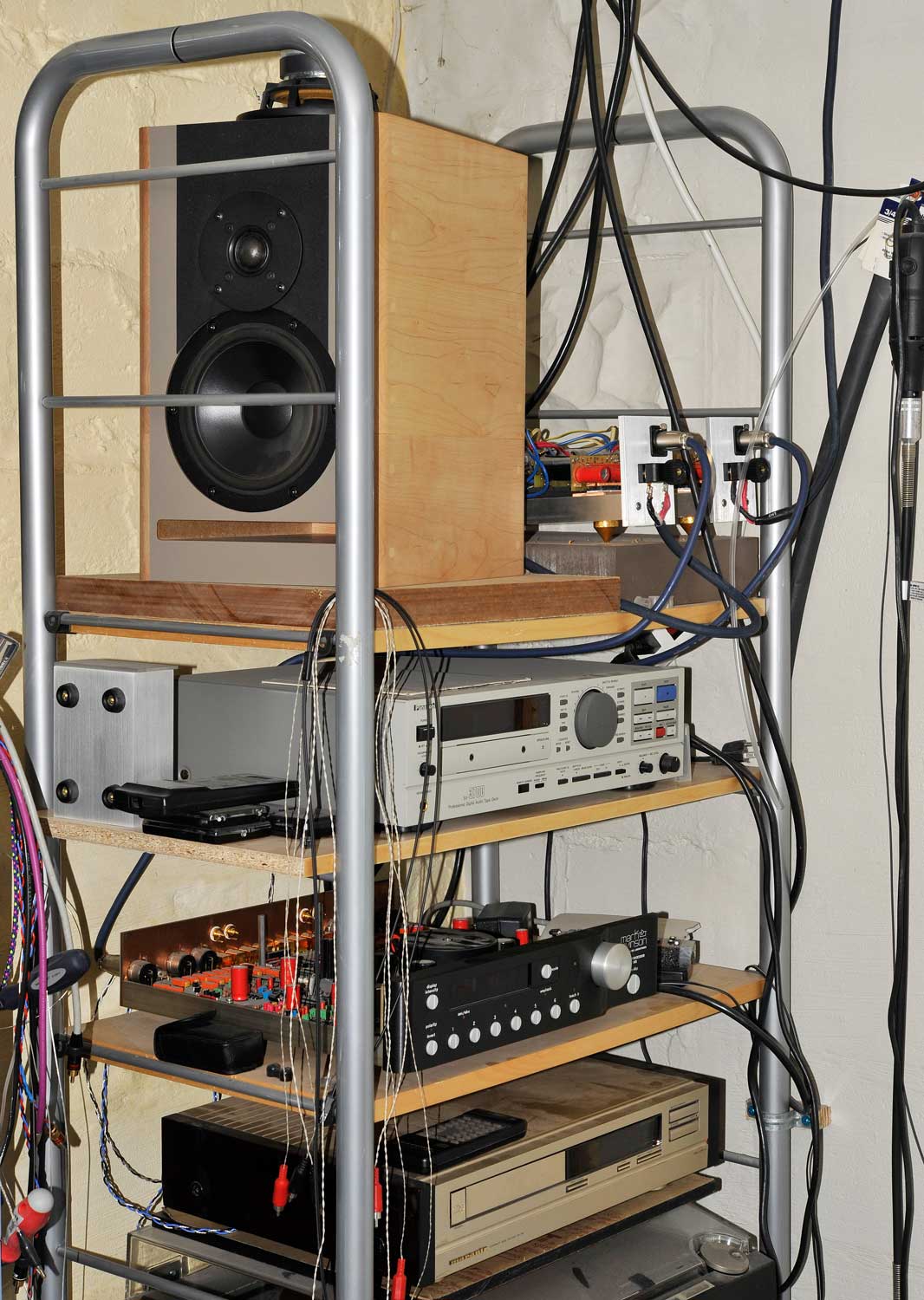

I've been using bridged LM4780 for years in my workshop system with Audio Technology drivers:Flexunits 5 H 52 15 06 SD
As you can see, there is not much heatsinking in my simple chassis, yet with moderate sound levels, or really pushed for a reasonable period, it does not create any problems.
