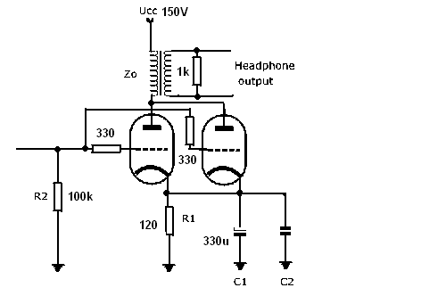

I am about to finalize concept and design for basically a complete amp stage 'between' the balanced voltage output of my DAC (Wolfson WM8741 in dual mono config) and my headphones with 8ohm impedance (Ultimate Ears UE-10pro). Credtis for this go to Lars/revintage who has provided immense knowledge and support - thank you so much Lars!!
The specifics are:
- Lundahl LL1676 transformers (connected 2:1) for balanced-to-unbalanced conversion
- two parallelled E182CC/channel as in the attached schematic
- Lundahl LL1630 output transformers
What do you all think of this? I am absolutely thrilled by how 'simple' and straightforward this is, a purist and minimalist approach with highest-quality components - I'd appreciate your comments if you'd like to share :)
Best,
Robert
Hi Jaap,
many thanks!
I knew the ecp.cc article, shurely an interesting and integrating solution.
The audiodesignguide article was very interesting reading too, I could find additional thoughts on the Lundahls, and on many other aspects ;)
Well, regarding power supply I was intending more to keep it 'external' - I was thinking of this: Z100A shunt Voltage Regulator in combination with this: CCS1A Constant Current Source Would this work - or is it blasphemy...? ;)
Many Thanks,
Robert
Hey Bertel,
Waste of money;)! With discrete components you can build a PSU for this amp at a fraction of the cost. One or two depletion MOSFETS and a voltage regulating tube(plus a few small components) is all that is needed. Two channels will draw 40mA plus the 10-15mA through the regulator.
Hi Jaap,
Many Thanks,
Robert
I have done a 5814 (also D3A or E810F)/LL1630 pre-amp in the same style. First with 2 chokes in the psu and later with only one choke + 10M45s CCS + 0A2 gas tube returned to the cathode. This was a big step forward (more bass for instance). I had not enough room so I tie wrapped the 0A2 under the hood. It worked a long time but the thing started oscillating yesterday so I have to do some surgery.
I am also thinking of changing the PSU by adding a solid state regulator and perhaps taking the 0A2's out. If I remove two big oil caps I have room again on the chassis.
I have some boards from the Jan Didden (Janneman)/Elektor regulator. Take a look at the power supply forum. There is a choice these days. I saw for instance the simplistic Salas regulator. I even think that for a hobbyist a HV superregulator is not over the top. Provided that you are not ripped off by buying a too expensive kit :cannotbe:
Ah, so you had the 0A2 connected back to the cathode like in the ecp.cc example, right? I don't know, well sure I have no experience with tube-based PSUs, but I would really like to keep PSU 'out' and go solid state too.
And yes, good that you mention it - I am just about to start building two shunt regulators as designed by ikoflexer, this is further development based on the simple Salas reg :)
