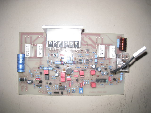

I mailed to Analogguy but he never reply me :confused: I think he gone out of this site so long time ago (I check from his latest posted) but yesterday I found someone in Taiwan talk to this amplifier and show his cloned : :eek: and mailde to him.
MyAVµøÅ¥°Ó±¡ºô - Avantgarde°Q½×°Ï
He told me this PCB was a groupbuy in Taiwan for 4-5 years ago, So now I waiting for a link :)
Regard
Anadigit
