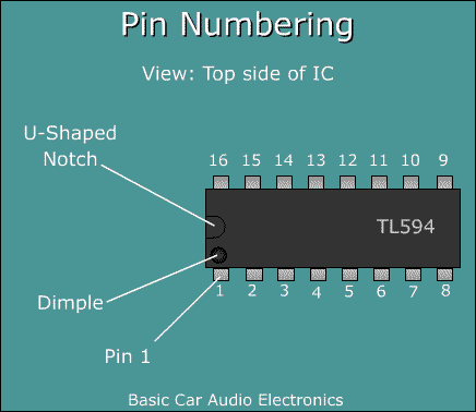

Are you sure you have the pin numbering on the 494 correct (see attached)?
Thanks Perry - I was hoping you was going to answer.
I actually removed the finals as this amp mount some old Sanken that are difficult to find here - I'd like to avoid to fry them.
I double checked the numbering and I did it right. Pin 9 and 10 are the one driving the IRFIZ44N according to the amp service manual.
