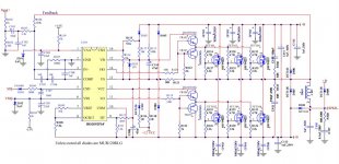

6000W By IRS2092
Here is a JPG picture of the circuit since the PDF is too big to attach.
The mosfet driver totem pole BJTs are rated 80V so the
supply must be below +/- 80V.
Assuming the supply is 80V the maximum output power is 1600W on 2ohms
or 800W on 4ohm
The totem pole drivers have separate rails and are never subject to main supply voltage.
A full bridge is required to obtain 6KW on a not too low impedance with 200W MOSFET.
Yuck, the driver transistors to the output mosfets are also operating in class B by quite a margin..0.65V each way :eek: Not very nice at all, some kind of bias to get them conducting & speed things up might help :)
No bias at all ensures no cross-conduction. Note that these transistors are driven with a square wave, a logic signal, not with an audio signal, and that bipolar transistors tend to exhibit longer turn-off than turn-on delays. Note also that conventional bias schemes only work well at audio frequencies, not for the ~100ns current transients that these buffers have to deal with.

Yeah most of the time will be spent trying to charge the 15,000pF, after crossover, even with those 15A drivers.
Does anyone know what the switching frequency is? This thing looks like a woofer amp.

Eva, what are the limiting factor(s) when targeting max output with the half bridge implementation? I'm not only referring to this design. Let's assume there's an appropriate buffer between the IRS2092 and MOSFET gates, the MOSFET are matched, inductor is optimal, appropriate power supply, and load = 4 ohms. I'm guessing switching losses will be very high but maybe it can work by reducing the switching frequency?
Sorry, I meant "200V MOSFET"
200V blocking capability limits maximum practical half bridge rails to +/-90V or so, which translate into (90*.707)^2/2=2kw @ 2 ohm
Full bridge doubles output swing resulting in (180*.707)^2/2=8kw @ 2 ohm
Full bridge also allows to use a supply voltage closer to 200V because there is no pumping.
+/-120V rails only give 3.6kw on 2 ohms, not much improvement considering that Rds-on is doubled and reverse recovery charge of body diode is doubled too (from 200V IRFB4227 to 250V IRFB4229).
Note that these figures are very optimistic. There will be a lot of sagging unless the power supply is regulated (which increases complexity, size and part count), resulting in substantially less power. Not to mention that regulating a single rail supply for full bridge is much simpler...
But you'll sure as heck get the 6000W at 2 ohms with a full bridge from +/-120. Even if it sags to +/-85 under load. Most real amplifiers do this.
As far as the higher Rds and Qrr of the higher voltage part, it seems you have two choices. Either put up with higher switching and/or conduction losses or put up with it being fragile. Pick your poison:). The same goes for any amplifier, really - high fT Jap outputs don't have the Is/b of the old hometaxials.
