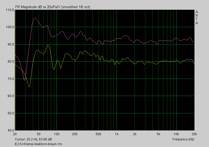

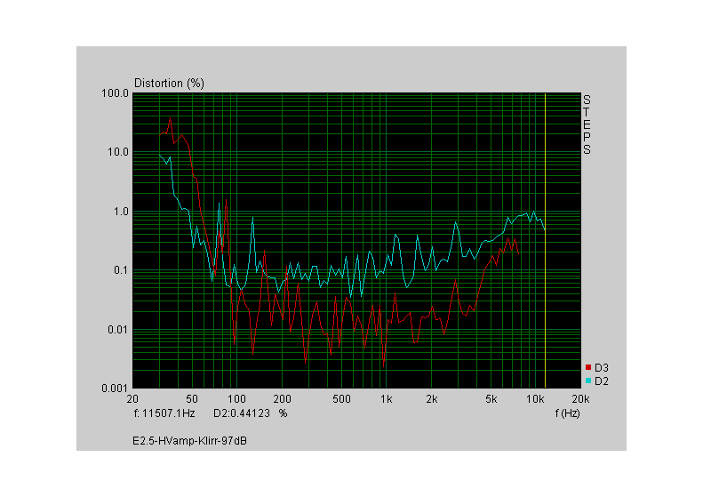

any concept using high voltage amps require an appropriate design of the ESL-panel.
Curved panels (mostly non-segmented) and non-segmented flat panels are and not the requested choice, since Capacity might be 1nF and higher.
In my ESL-design there is just one small stripe for frequencies higher than 5000 Hz. Its 69" (175cm) long, 0,8" (2,1cm) wide, having a capacity of 140 pf.
The tube amp shows no band width limitation in the audible range (see frequency response taken at 40cm and 1 metere) and distortions at 97 dB soundpressure (1m) are extremely low. No step-up design enables such low K3 values. There is just an increase of distortions for frequncies heigher than 5 000 Hz indicating the current limit of the amp. In Music such frequencies are not present with this level.
