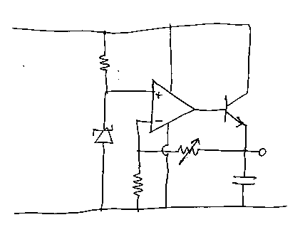

O.K. Here it is. Now you can start to stone me (or teach me). Just BTW, I am not qualified in any electronic trade/profession, so just keep it in mind before picking up some big rocks ;) I quickly tried to use Simetrix and put together something that looks like a voltage regulator. I KNOW it is far from perfect and must be improved alot, but at least I tried. Although it is not really practical to use this method to adjust + and - 0-60V up to 15A, I will set the requirements to + and - 5-50V @ 5A, just for the exercise and to learn more about electronics - myself that is.

It's a big rock, so I'll drop it gently...
There are rather a lot of things wrong with your proposed circuit. Let's start simple and work up to a space shuttle.
Fundamentally, a linear power supply is a non-inverting op-amp with an emitter follower added to increase its output current. It amplifies a voltage reference (often a 6.2V Zener), and its gain is adjustable, allowing the output voltage to be vared.
As shown, the circuit cannot go down to 0V, and is not protected against short-circuits, but it gives the general idea.
You need a book to help you. "A Practical Introduction to Electronic Circuits" by Martin Hartley Jones is very good.

I think that rock was made of sandstone, landed very softly ;)
O.K. I got some more odds and ends on PSU's and op-amps from internet and will study them and do some mods. to my circuit (I learn much better by practically trying then by just reading a book - so I hope Simetrix will give me some usefull results)
A question: Is it possible to use zeners (in practice) for + and - supply to op-amp (in this case OPA501 must have min. +- 10v up to max. +- 40v) if your supply are way too high for op-amp supply?
Yes, but it means adding a gain stage after the op-amp, and when you apply the feedback, there is a very real danger of it oscillating. It's probably easier to make your own op-amp out of a cascade of differential pairs using hgher voltage transistors. If you get yourself a breadboard, you can knock up circuits quickly and easily.
You really would be better off with a variac. This isn't going to be easy at all.
