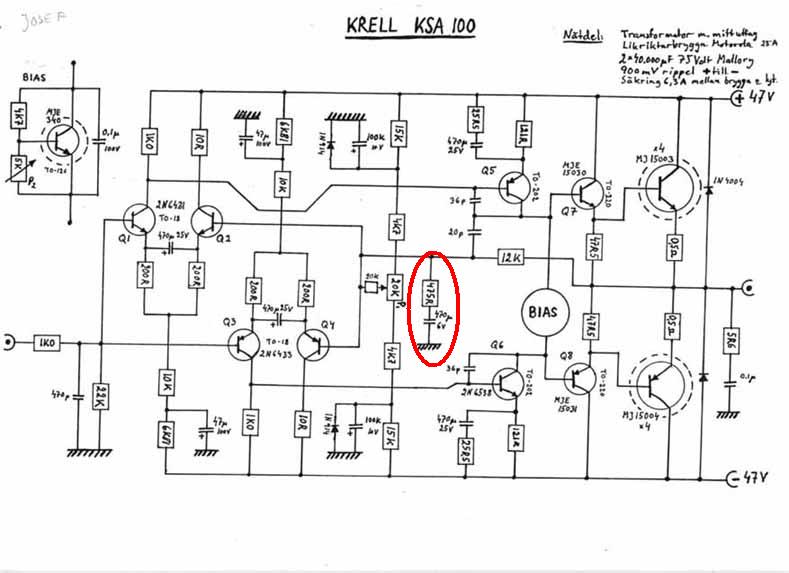

Hi all,
Anybody have experience on DIY Krell KSA 100, please help me for a little. I just wanna know what is the reasonable value of the resistor in the cross distortion in attached schematic.
(which is circled in red): 475 ohm, 4K7 or 4,7M ohm :eek:

UrSv said:
Doesn't get more standard than that...
However it seems funny to open a thread asking about a resistor that is clearly printed in the diagram...
Who cares :D At least this way we get to see the "secret" Krell schematics... Pretty average looking if you ask me.

Based on the schematic. looks like 3 pairs of outputs. If it runs 100watts class-A into 8 ohms, i'd say the bias is as follows:
Total bias 2.5 amp per rail.
Bias per device 0.84 (x3 devices for each cycle of push pull) .
voltage across each emmitter resistor = 416.6mv.
This amp will dissipate 235 watts per channel at idle.
All this is based on the 100 watt class-A spec and the values on the schematic.

Tube_Dude said:
The unbiased electolitc capacitor in the emmiters of the LTP...is a strange feature...
Any comments?? :)
I think it is to reduce degeneration for a/c signals without causing excessive d/c offset. with the cap, the two 200r resistors are essentially tied together, thus no more emitter degeneration.
for a/c signal, the cap is open, thus each leg has a 200r resistor.

With regards to the 3 pairs of outputs I think it could easily be 4 pairs as the schematic clearly says x4 for the output transistors.

Not needed the service manual...if the simulation gives you 1mA...your simulation is flawed...
The current un the VAS is +-8,3 mA...;)
PS : How a 1 mA current can drive a follower that is not even a triple follower but only a double!???
Yes!:)
No..i think that what you mean is....for DC !!! ;)
I thought it was settled on that other thread that for such a topology, you cannot calculate VAS and LTP current. Assuming that the current in the LTP legs is evenly split is falwed.
