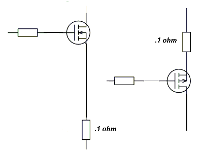

I've received, for free, a defective Motomaster Eliminator 1750 watt power inverter. The circuit use a SG3525. It seem to be made by Xantrex and I can not find any schematic of this inverter.
Four of the IRF640 output mosfets are burned.
I presume that those four mosfets was connected in parallel, and one mosfet did goes unbalanced and have to much load and burned, after that the 3 others get all the load and burned ?
I can replaced the 4 burned mosfet, but I was thinking to put a .1 ohm resistor on each source terminal of all the 16 output mosfet for a better current sharing between all those mosfet, is it a good ideas ?

Do not try to reengineer it without understanding it first.
Power the inverter with a current limited supply for initial testing. If nothing else, connect a car light bulb in series. Make sure none of the components are heating up.
It is possible that another component is bad which caused the MOSFETs to burn out, but it can also be caused by an overload, incorrect input voltage, or overheating.
This looks like a quasi-sine inverter and these blow quite easily because they always have trouble with big inrush currents and very reactive loads like motors. In most cases the MOSFET drive circuit is too simple to suffer damage and replacing the MOSFET is enough.
You should check that the drive circuit works and that the rest of the MOSFET are not damaged, though.

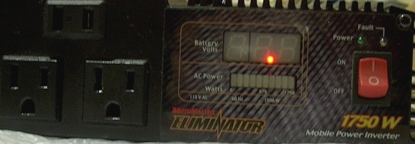

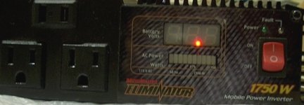

Btw, I forgot to say that the digital voltage meter of that Motomaster inverter do not show the battery voltage but just a red dot.
