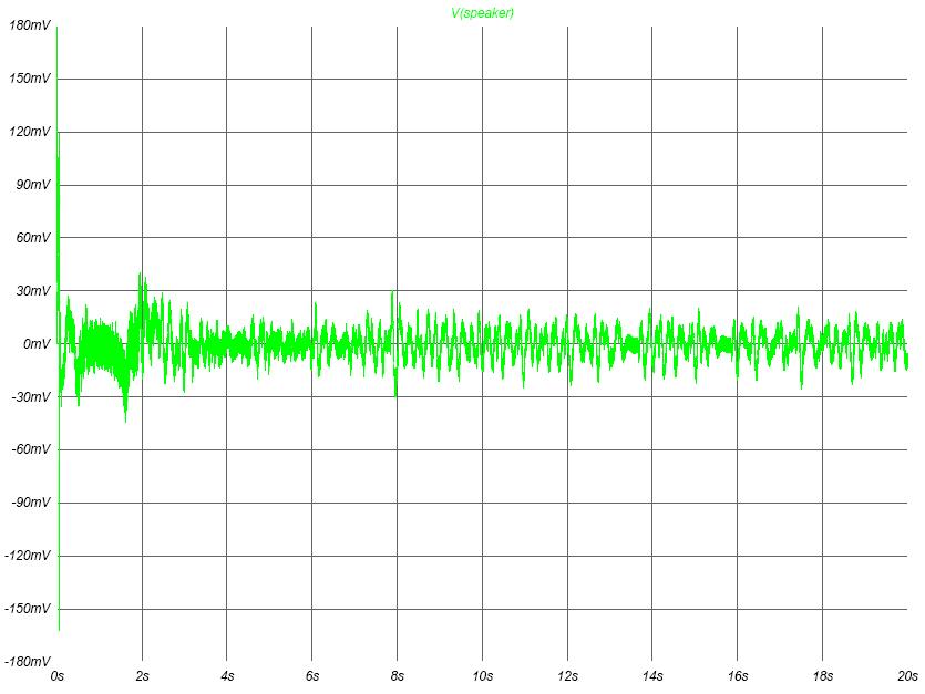

This may sound funny... the noises are like high pitched crackling noises doesn't seem to be a constant frequency hum or buzz, its hard to explain, imagine deflating a balloon, that noise, but high pitched. I haven't noticed but apparently that behaviour can be seen in the simulation as well (I attached it as well).

I forgot to mention that transformer inductance values of the schematic are real. And all voltages of the simulation are almost the same as in real life. I attached the simulated speaker plot without input signal.
