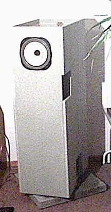

In fact, the second of the 2 Lowther systems whose sound I could probably live with were these OB's (Tone Tubby woofer IIRC) demo'd by Jon ver Halen at VSAC 2008:
don't ask about the amps, courtesy of crazy Jeffrey Jackson ( Experience Music )

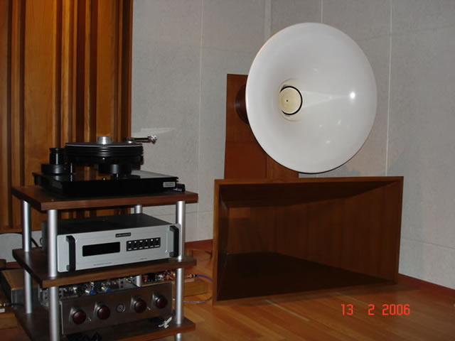

I understand where you're coming from about OBs brownie; of many I've heard, the only two I I could listen to any time @ all were the one chrisb posted the picture of, and Phil's Festrex system. --And I must add the Lowthers were greatly helped by the 304TL transmitter tube amp; I heard it earlier w/ a different amp and couldn't stay in the room, it hurt my ears so bad..
For rock--I know a pair of Austin 166s w/ bag end clone subs for rear deflectors will more than fill that size room w/ sound, or do quite nice for late night, low level listening, using a FE166ES-R. Or could ck w/ Jon for which Lowther he'd recommend/had close TS parameters?
But if I were going to buy a Lowther, I wouldn't put it in a cab...
Something more like an Azura horn; that would pick up efficiency, and would really be able to handle all styles of music.

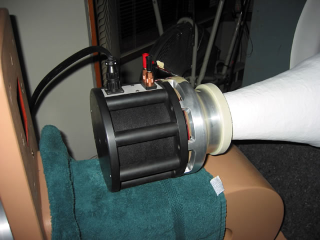

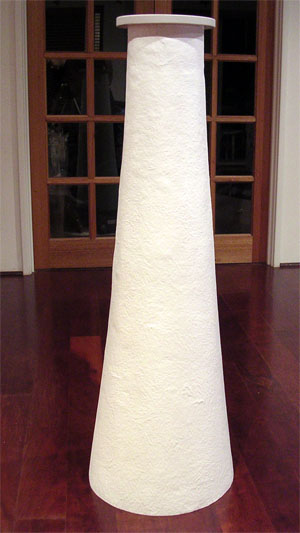

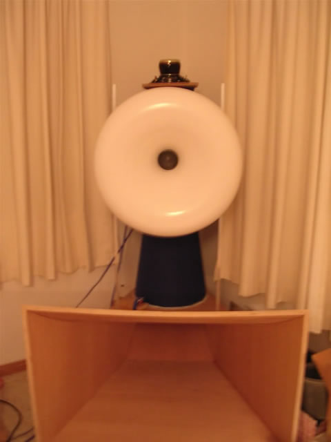

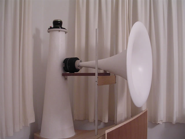

Or maybe a combination of both, which I didnt find :rolleyes:
These guys play with some pretty expencive stuff :hot: but less will do
Some will also have a ribbon supertweeter, or something else, like a Fostex tweeter
Pretty strange stuff, but rest asure that they have tried every other possible way
They are just very "fanatic" about Lowthers fore bass
Strange, ehh
Im sure at least midbass is special, with acoustic music
Though I doubt they like heavy rock very much :D
Fore doing such like this I would coctact Martin Seddon, very nice man
Though, his bigger Azura stuff will be be expencive to ship outside AUS
