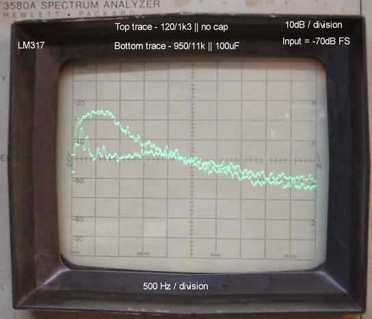

Now we get to look at some noise spectra. (Until I get confidence in how to post photos, I'm going to post this in chunks.) The following pics are all 0-5kHz sweeps, 10dB/division, -70dbV full scale, 30Hz filter BW with smoothing, and a painfully slow sweep rate. I didn't show higher than that because these voltage set components didn't change the noise spectra that much above 3kHz. With a smaller output cap they might.
The first pic shows the the extremes. Top trace is 120/1k3 with no cap. Bottom trace is 950/11k with 100uF cap. The top trace is the high trace all across, the two intersect right about 2.5kHz. The lower program current gives 2-3dB less noise at high frequencies. The real benefit of the adjust cap is below 1kHz, with a 15 to 25dB reduction in noise in the midband.

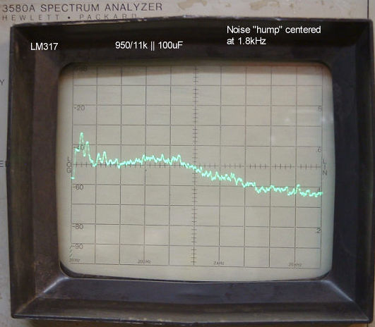

The second pic is the 950/11k || 100uF all by itself, so you can see the broad rise centered on 1.8kHz. This is Jung's configuration, which gives the lowest noise. It's also the one I described above as having an "aggressive glare" in the 2k region. I was a little bit off, my tone range identification skills are deteriorating a bit with age, I guess... :)

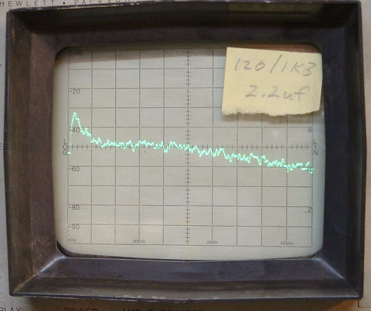

Now, as stated above, based on data sheet info, I am assuming that the noise curves are also giving us insight into the output impedance and interactions with the load. I'm not an EE so I can't explain the inner workings of the regulator. I'm more of a systems integration type and I look for problems such as exactly what I'm seeing here. And clearly, optimizing this thing for lowest noise creates impedance nonlinearities in a region that is very audible. I'm guessing the IC's error amp has run out of gain bandwidth and maybe becomes unstable until the large output cap finally takes over above 3kHz.
So I tried various combinations to find the ones that give the most linear noise spectrum below 3kHz and doesn't excite the resonance.

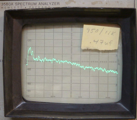

The third pic is the same 950/11k resistors with a .47uF cap. It gives up a little bit of noise below 1.2kHz but there is no sign of any resonance.

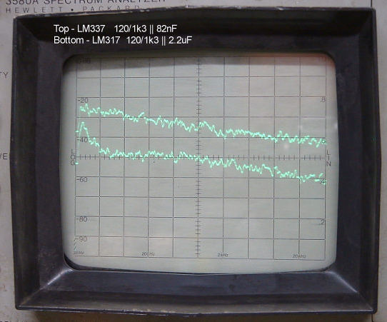

This last pic shows the LM337 with 120/1k3 || .082uF compared to the "optimized" LM317. About 20dB noisier across the board! That's where we go next. Stay tuned...

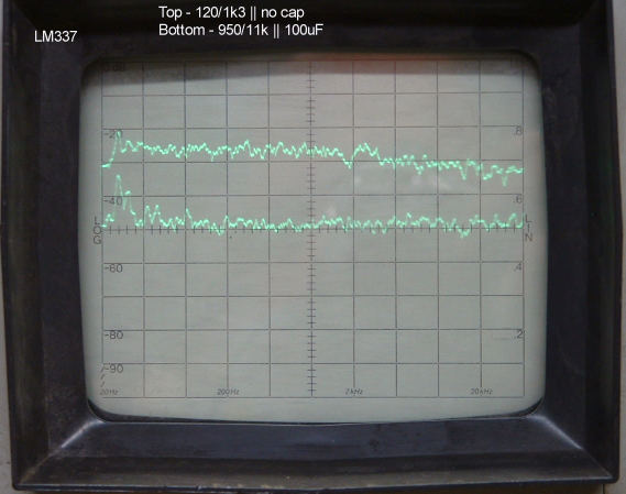

OK, here are some noise sweeps of the LM337. This first pic shows the extreme cases, top trace 120/1k3 with no cap, bottom trace 950/11k || 100uF. The bottom trace doesn't look too bad, except for the same poorer line freq ripple rejection that we saw with the high value resistors on the LM317. So I think the case is built to avoid the higher value resistor ratios on that basis, even though a little lower noise is possible with them.
The other thing to note is that the noise does not fall off above 3kHz like it does on the LM317. This was into a 1500uF cap on the output! Adding another 1000uF made very little difference.

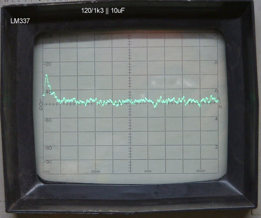

This sweep shows the LM337 with optimized values, 120/1k3 || 10uF. So the factory values are right on here. There was little if any benefit to using a larger adjust cap. But interestingly, there was no penalty to it, either - no resonance that developed. So 10uF seems to be the optimum value for the LM337 with the lower value resistor ratios.

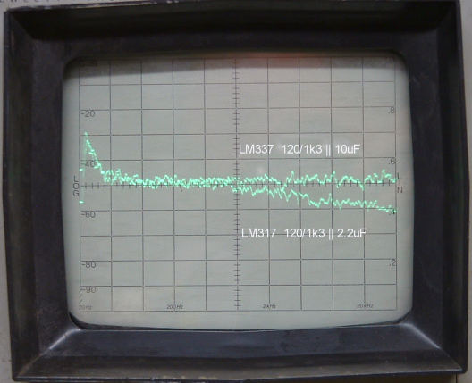

This one shows the noise spectra of the "optimized" LM317 and LM337 overlayed. They are pretty much equal at around -120dbV up to 2.5kHz, after which the LM317 rolls off significantly, better than 10dB lower at 5kHz. Frankly, I think this high freq noise difference is a sore spot of this regulator pair. Maybe as things progress we'll find a way to deal with it. But, that said, throughout the critical midrange, the noise spectra are pretty equal, so there is some success here.

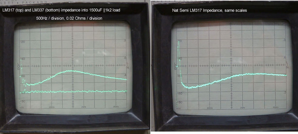

Now here's where the things get even more interesting. I really wanted to measure the output impedance of these critters. I have a network analyser based system that would do it with great accuracy, but it's down for repairs and won't be back up anytime soon. So I decided to use the 3580A tracking generator to put 1VRMS thru a 1000 Ohm resistor then thru a 10,000uF capacitor (to isolate the DC). This creates a current source and the AC voltage at the load is then proportional to the impedance. Since we'll be looking at very low impedance values (below a tenth of an ohm), this method will be accurate to about 0.1% except for the increase caused by the capacitor. But since we're looking for impedance trends and not exact numbers, this is plenty accurate. You can do this with a very sensitive AC voltmeter if you have one, but it's nice seeing it visually.
The pic on the left is the impedance of the "optimized" LM317 and LM337 into 1500uF ||1k2 ohm loads. The impedance range is 0 to 0.2 ohms vertical, DC-5kHz horizontal. And, what do you know, the impedance curves bear a strong resemblance to the noise curves. Who woulda thunk it. :) The 317 impedance bump is centered at 2.4kHz, right where I was hearing it. So I guess my tonal ID skills are doin' OK after all... But the real surprise is that the LM337 is so much better behaved than the 317, with lower and flat output impedance.
Tomorrow I'll go back and re-optimize the 317's RRC values, and the output cap too, and see if that bump can be eliminated. I want to see impedance curves that are smooth with no bumps, and broad, gradual transitions if any. And I want to see the + and - supply be as equal as possible. Right now the negative rail is a better voltage source than the positive.
I then noticed that the LM317 in my test jig is not a Nat Semi part, it is one made by Motorola 9-10 years ago. So just to be sure, I replaced it with a current Nat Semi part, and the impedance sweep of that is in the right photo. It's a better curve for sure, but it still has problems. I'd say stick with the Nat Semi parts if you can.
By the way, the impedance on both of these start rising above say 8-10Khz just like it shows in the manual.
