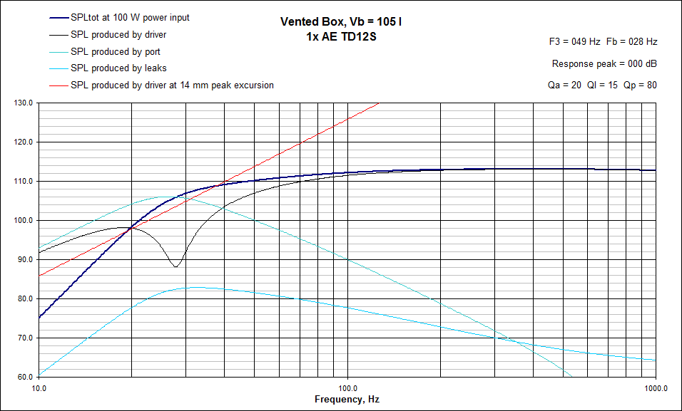

Wayne Parnham (sp?) of Pi speakers uses the TD12M upgrade choice for his Pi3.
Actually he uses the AE TD12S for the Three PI upgrade. It goes lower than the TD12M.
