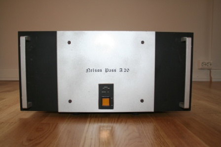

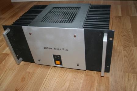

Here is a picture of an amplifier chassis I built very early in the 80ties. It was ment for a Threshold 400A clone. I had obtained a schematics at the time. Later I changed my mind and planned for a A40. Then I found I did not have the time to finish it - allthough all the metal work was ready! - and sold it. The amplifier then became a Pass A20. Which it still is to this day.
The article with schematics can be found here at Pass labs http://www.passdiy.com/pdf/classa_amp.pdf
The article was published in "Audio" February 1977.
I publish these pictures as inspiration to fellow builders.

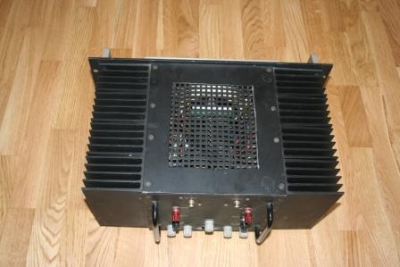

The front panel is purchased Schroff 19" one. The heatsinks was purchased as one meter parts, and then cut up. We bought several meters of heat sinks. (Still stored to this day - except the ones used here.) All other metal panels where cut from large aluminium panels. The top panel ventilation was BTW added after I sold the parts.
The heat sinks are joined by a thick horizontal metal bar. A la 400A. The TO-3 transistors where also mounted in the 400A fashion.
Rear panel fuses are BTW the same as used in some F-16 electronics from way back when.

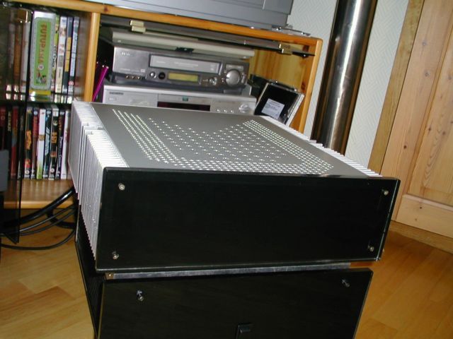

Your chassis looks great, and seems Electrocompaniet inspired with plexiglass front(?).
Yes, mine was constructed maybe as early as 1980. I cannot remember exactly. What I remember though is that the Threshold 400A was soooo desirable when it arrived. And expensive. So I had to get one/build one!
