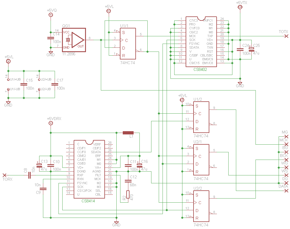

Just about any decent (full-duplex) card which have at least one S/PDIF input (including my Juli@, of course... ) can be synchronized to it. All you need to do is to embed your DAC local clock into a dummy s/pdif stream and sent that back to the sound card input. You lock the card to it and bingo!, your output stream is locked to the local clock on your DAC. Just open up the connection between the s/pdif receiver reconstructed clock and your DAC (connect it directly to the local clock) and you're done. In principle it's trivial...
it's what i did with my TerraTec Aureon 7.1 Space (Envy24HT based) and the attached circuit. I built a prototype of this circuit on perfoboard using 78l05 for any +5V* point in the schematic and toslink input output. The cs8402 (in mode 0) generate a blank spdif signal to sync the audio board and the right FSYNC and SCK to feed the cs8414 (slave in mode 3). The cs8414 receive the spdif signal from the audio board and output i2s. This i2s is then reclocked from the same clock that control the cs8402.
From alsamixer i choose IEC958 Input as the source for the 'Multi Track Internal Clock'.
It works.
The prototype described on previous post is attached to the TerraTec Aureon 7.1 Space (i think any envy24* based card it's OK) with two optical cables (one to spdif in and one from spdif out) to have complete galvanic isolation. For now i'am using it with a DIY DAC with 4 TDA1543 (not so good and not so bad) using for I2S connector a SIL header on the two boards and short twisted pair.
I'am searching SIL male and female angled connector to attach the two boards close to each other.
The next steps are:
1) improve this circuit: better ps; better digital signal interfacing (some resistors from chip to chip and some kind of buffer/driver for the MCK and maybe for the other I2S signal); two clocks (11.2896 and 12.288) and the possibility to choose from 4 FS (44.1, 48, 88.2, 96KHz)
2) design a good PCB layout
3) build more DAC modules with other DAC i have (PCM1794A, AK4396, AD1955)
I'am open to hints and critics
Ciao
Andrea
Related to this is my work with the Infrasonic Quartet board.
If the card is slaved to the DAC, its output sample rate will correspond to the incoming clock from the DAC.
The DAC clock must be changed first for the whole chain to move to another sample rate.
Would a buffer be enough to let the FPGA in the DAC recognize the sample rate?
Alas, i2s sends a clock, could that be used?

Thanks to phofman and 1audio to have answered to Telstar, i think the better option to control the DAC clock from the PC is via a serial or usb (with ft232 for usb <=> serial) link as oulined by phoman and, yes, the alsa arcam-av plugin is a good starting point.
On the board a max232 or ft232 and a pic could be added to receive messages from the PC and select the right clock and, eventually, return messages with status.

Yes it's not difficult, it require switching from 8414/8404 to 8416/8406 and some thinking because they are not pin to pin compatible and have a different way of setting input output formats. Anyway from a quick overview of the 8416 datasheet i saw it's possible to set it slave with FSYNC and SCK input and SDATA output.
For the question of changing the FS on the DAC i think the best way is via a side channel (serial or usb) and a user space app, on linux an alsa plugin and on windows whatever a windows guy will do - i think will be simple, only some messages through a serial link.
yep. On windoze the easiest thing is to write a trivial "one-click" user-space app that simply does the (manual) rate-selection (for whatever it's worth).
Nevertheless, do NOT leave out manual rate-selection switches to be placed on the front panel of the "reclocker"... ;)
BTW: if you're going to implement such "remote-control" input, do not forget to use optocouplers there... or we can say good-bye to clean reclocking! :dead:
One more thing: it would be nice to have copper S/PDIF too. To keep the isolation, some transformers should be used there... or perhaps it would be better to build (or buy?) a copper->optical and an optical->copper S/PDIF converter?
