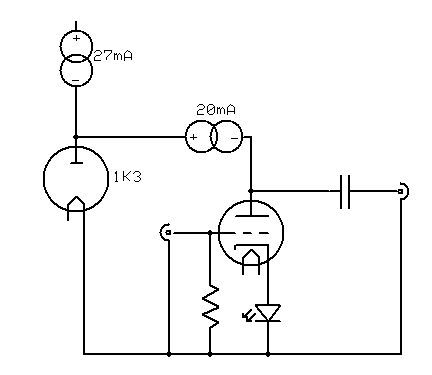

Colt45 said:The 1K3 is useless
You could use it to make a shunt regulator for a highish voltage line stage -- something like a 12b4 with a CCS on its plate. It is higher voltage than most glow tubes, won't (?) oscillate when bypassed like a glow tube.
Edit, it has lousy impedance specs -- an order of magnitude worse than a glow tube. Still, with constant current it could work.
