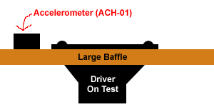

well I've been looking into the Accelerometer idea, and the good news is that it has been done before (my project does not have to be unique). LAUD has a webpage explaining how it can be used to measure speaker enclosure vibrations. If the speaker box volume is known or is just a large baffle, could this be used to measure speaker FR?
Gaz
Here is my idea:
Gaz
Here is my idea:
