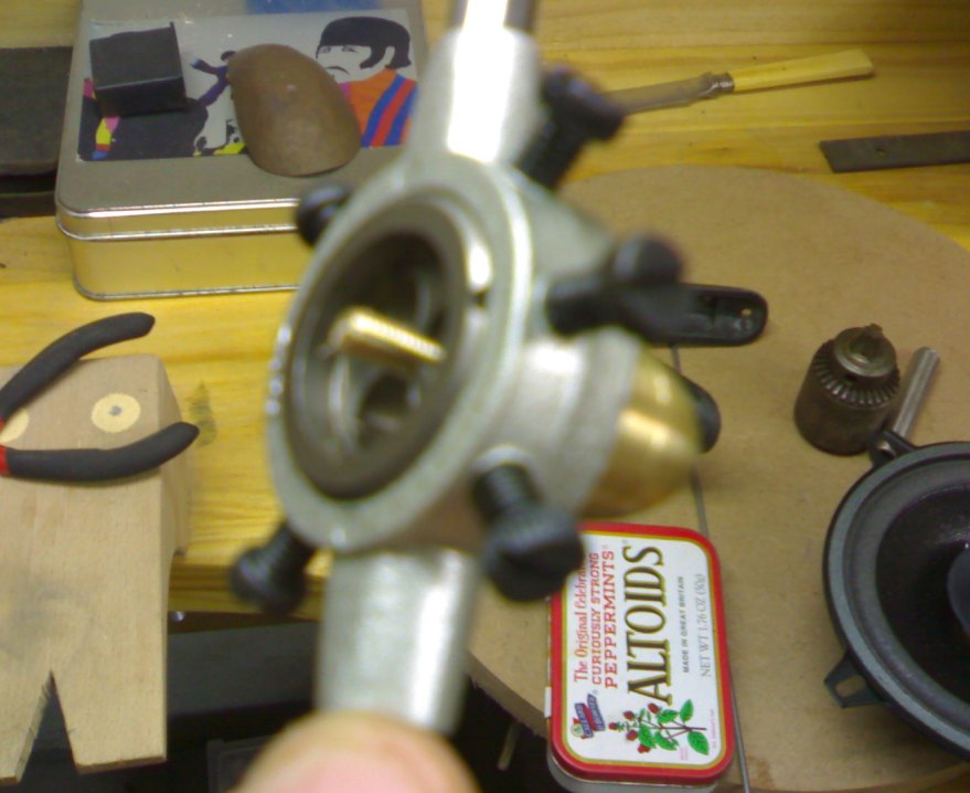

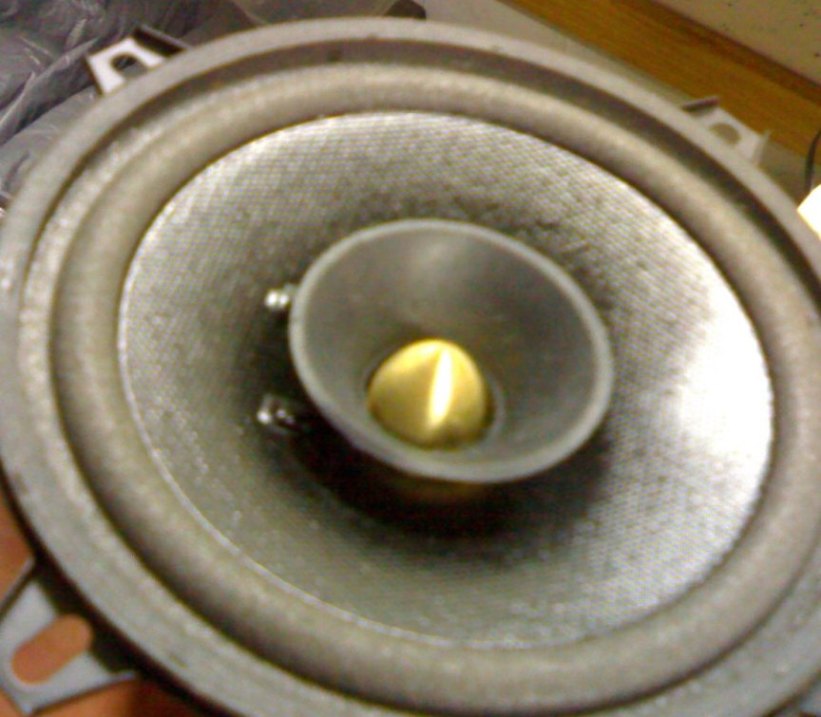

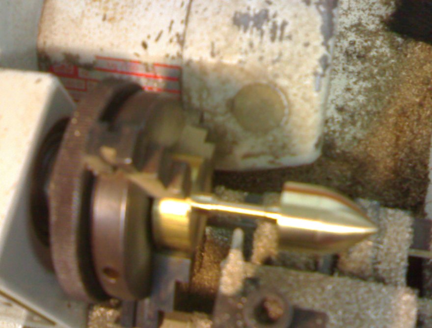

Just last night I was experimenting with making some brass phase plugs on some cheap drivers.
The plan is to do it for my FE167e's when I have the technique down.

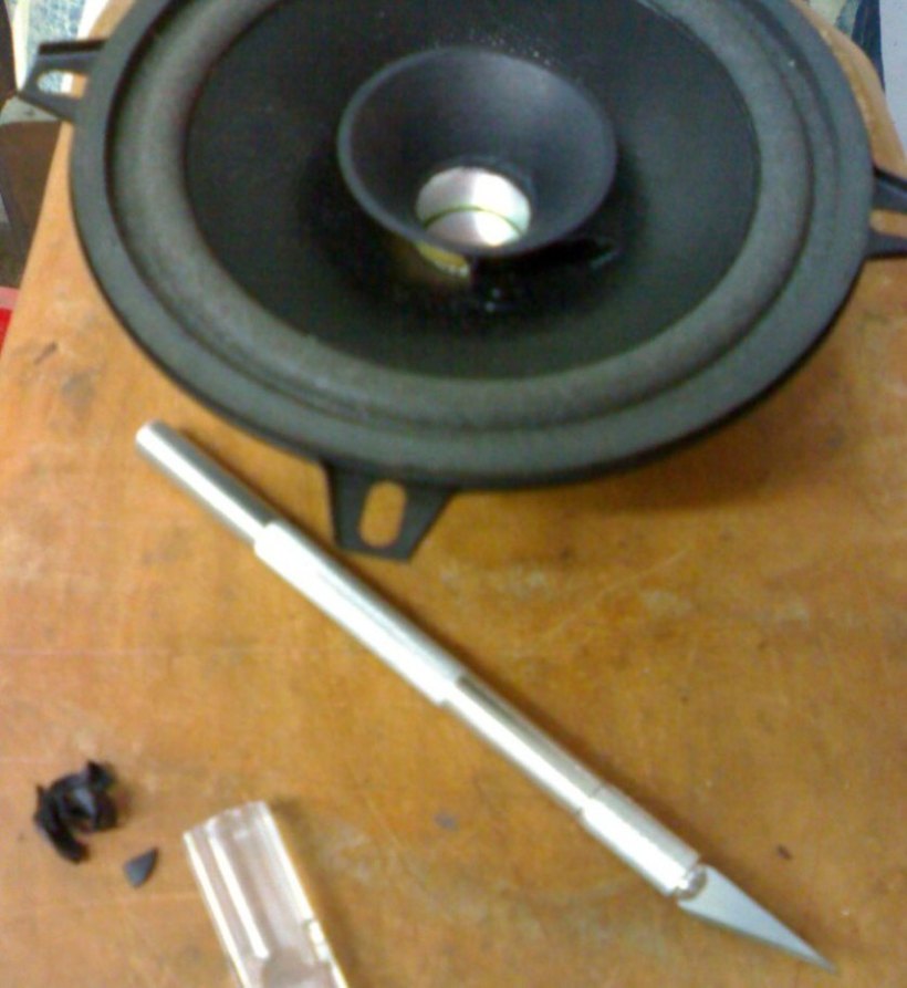

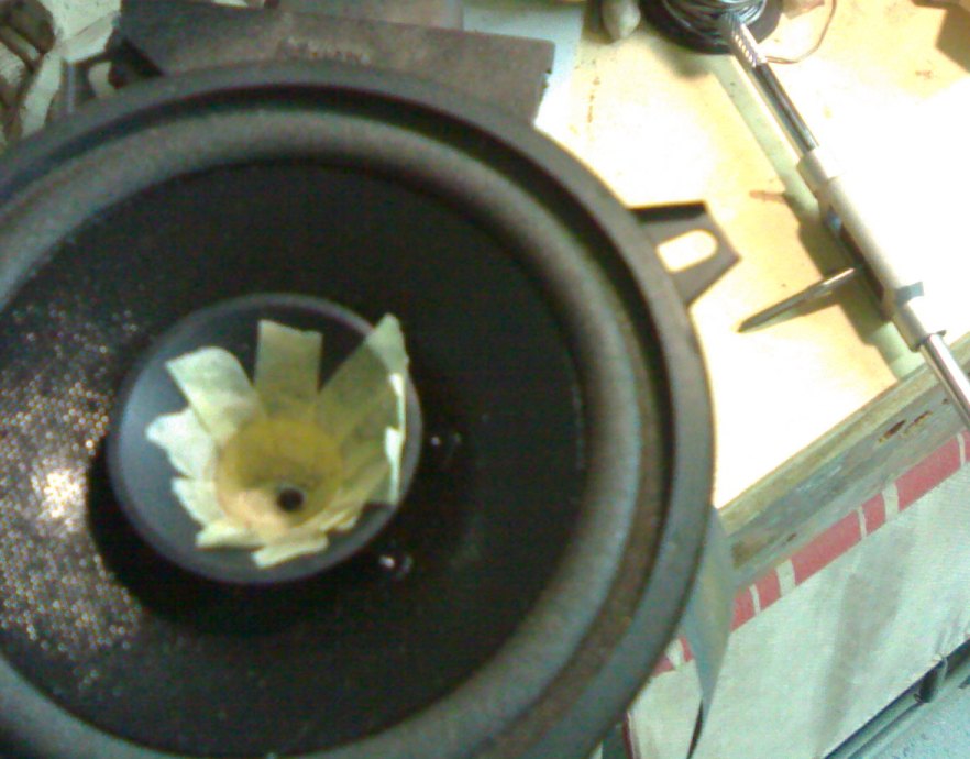

My experiments are far from finished, but here's what I was up to last night:
-excuse the phone-camera pics.
#1 - Dustcapectomy

my process
#7 - clean ALL debris out of center of driver
#8 - remove tape from gap
#9 - screw in new phase plug
#10 - Enjoy.
Now it wasn't all as easy as it looks. I ran into a few problems.
-but that why I'm doing these experiments before I get to my FE167e's.
I have not done any listening yet, but will do soon.

planet10 said:
From that last picture, i'd suggest a plug that is fatter (so there is less gap) and longer (tip should reach to the top edge of the whizzer (at least))
dave
I agree mine have about the same clearance as the voice coil/pole piece. I didn't want to take the chance of metals chips getting into the gap so mine are fastened with a small amount of JB weld and positioned with shims till set up. never tried one of the mushroom shapes though.
