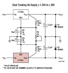

In the data sheet for the LT1033 negative adjustable regulator there is a typical application schematic for a tracking regulator that i am interested in but don't understand. I like the simplicity of the design as all the tracking regulators i am familiar with use opamps.
here is the schematic from the data sheet

my two questions are:
1. how do you adapt the formula to calculate resitor values for the tracking regulator?
2. how does the circuit match a voltage change at the output of one regulator in the other regulator?

1) If you want to build the tracking regulator, then use the values in the datasheet, don't recalculate.
2) As you adjust R3, then the resistance between the adj pin and gnd is symmetrically changed for both regulators (look at the resistor network formed by R2 R3 R4).

i think the second resistor in the voltage divider is made up of r4 and r3 in parallel. the effective value of R3 is acutally 2.5K not 5K as i originally thought.
using the above logic i calculate the output to be 22V. Still 2 volts too high so i must still not be accounting for something.
leadbelly 13th February 2009 05:00 AM
I just cannot get my head around what you are trying to say. You do realize that R3 is a potentiometer? When R3 is adjusted to 5K, the voltage is +/- 20V and when it is adjusted to 0 the voltage is +/- 1.25V.

Essentially, you don't need to change the formulas in the single supply schematic to adjust it for dual tracking. Actually, I think its a really nice application note.... The key is to identify the current flowing through the resistor divider network (R1 - R5).
If R3 = 0, R1 and R5 are tied together and the reference pins are pulled together, putting them to 0V offset through the now parallel connection of R4 and R5.
If you want to fix R3, calculate half its value in parallel R2 and R4.

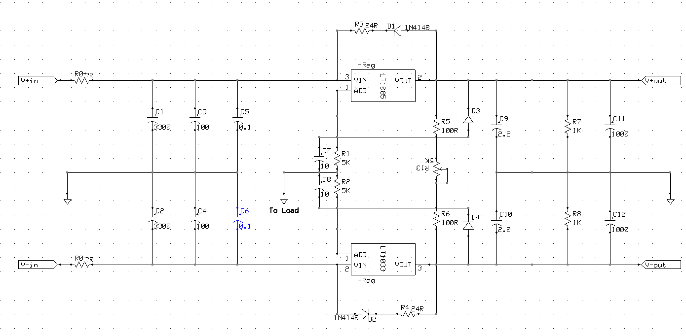

okapi 19th February 2009 03:39 AM
prototype up and running
leadbelly and bakmeel, thank you for your replies.
i now have a working prototype
http://tim.cheapo.cc/images/Tracking...024x768%5D.JPG
i have not tested it's tracking but i will do so soon.
i have to admit that i still don't quite understand the circuit but, i do at least know how to calculate the output voltage based on the value of the trim pot.

after i build a point to point version i plan on designing and ordering circuit boards. This supply will form the basis for the buffers i have in the works (B1 and a LME49710 based buffer).
if i can find a negative regulator that is pin compatible and can handle higher output amperage it might work for my chip amps as well.

Try to approach the regulator as follows: It will work to maintain a voltage difference between OUT and ADJ of 1.25V, based on its internal reference. It will adjust the current passing to the output as a function of the current flowing into the ADJ pin.
Work your way through the resistor network based on the constant 1.25V, and you'll find how the remaining currents flow and why. It's not difficult at all.. ;)

For your benefit: put some ceramic capacitors (typically 100nF) parallel to the output capacitors. Put them physically close to the regulator, and minimise the track distance to the ceramic from the OUT pin and GND. Keep GND close to the input and output (or use a double sided PCB with a ground plane).
The ceramic cap will short high frequency noise generated by the regulator
