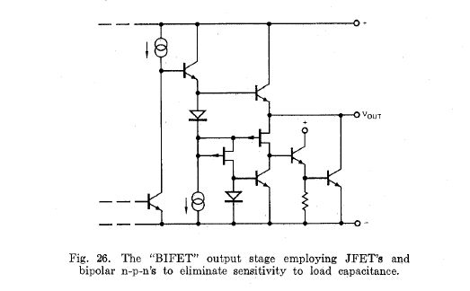

Does anyone know the name of this configuration?
Is anyone familiar with this configuration?
Hi everyone, I was reading the 1974 Solomon opamp paper, where he refers to the output stage pictured below.
I am interested in it as he suggested that it would be suitable for capacitive loads, and I am putting together an opamp for driving an equalizer
Cheers in advance:drink:
