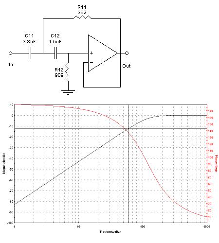

I am looking for some suggestions regarding a line level high pass filter for main speakers. I don't mind building a circuit as long as it is a good or better than something I can buy reasonably.
I would like to be able to filter out <~60hz signals from reaching the mains. If possible I'd like to be able to adjust this freq. I believe a 2nd order filter is what I'm looking for.
I am using a digital source -> DAC -> Amp -> Main Speakers

At frequencies that low, I think that active is the way to go. You can do it pretty simply (Sallen-Key filter made from opamps) or you can get a bit more sophisticated (for example, the Acheron crossover shown on my website). Either approach will well outperform a large, clunky inductor and equally large, clunky capacitors.
How much attenuation is needed at 60Hz? Here is a circuit which will give -12.4dB at 60Hz. It was generated by Microchip's FilterLab software.

The high pass of a PLLXO coule be used. 2nd order gets kind of droppy and if your amp has a low input impedance could be a no go... (i'd suggest 50k or higher input impedance, and if that low make R2' infinite and the cable short).
http://t-linespeakers.org/tech/filters/passiveHLxo.html
If the input impedance is an issue and you still want to approach it this way, you can sandwich the PLLXO between 2 buffers. I have a dual 9V battery powered one for one of my speakers, but it could be done with jfet beffers (like in Nelson's B1 or cathode followers (don't forget the CCS)
SY's XO is also very interesting -- i'm no big fan of SK... I'm happy he did the groundwork for this so the rest of us don't have to. Thanx SY.
