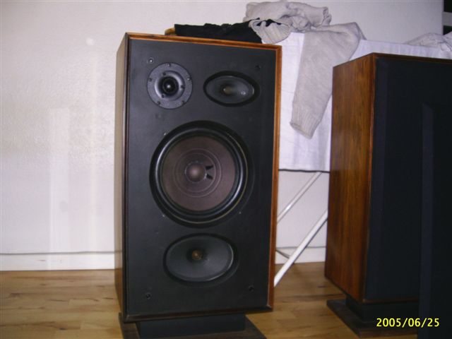

Isophon BS60/4
MadsKaizer said:
To that price, is there any alternatives/newer speakers I should take a look at?
Sensitivity 94dB/1W - PSL245/60/4 Ohm 10" woofer alnico - 1318 oval midrange - F713 oval tweeter 12dB/octave - 6dB/octave - 6dB/octave deliver soundstage , perspective and clear sound as 10" Tannoy coaxial driver.
Look at picture.

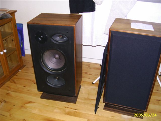

Re: Isophon BS60/4
Look at picture.
Forgot to say that the showed cabinet and units are not for sale -
But if you want to built a pair , I have bought 6 speaker vintage renewed units from Isophon in Berlin. The only thing different is the tweeter - as shown on the picture the old tweeter is oval ( 1972) - the newer type(1977) is round approx 4" dia.

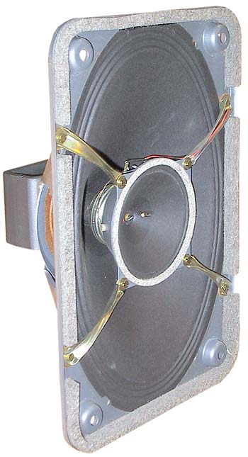

That 4-way could probably be simiplified and made into a better speaker.
Do you have a bigger picture -- and a picture of the fronts -- of those isophons? They are particularily nice vintage units, far higher build quality than the EPIs. And given the sample measurements i've made of similar probably happiest on an open baffle.
I've had Germans pay me big bucks to ship Isophons back across the Atlantic (the 8x12 oval with the co-axially mounted 4" tweeter for instance)
I guess there is an aura associated with stuff from overseas... there is a lot of nice European stuff that people pay a premium over here for.

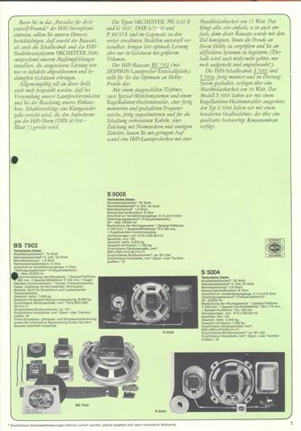

On the picture please find S5004 from 1975 . The kit includes crossover and units. It has to be the famous PSL245/60/4 ! The unit goes straight down to 35 Hz in acoustic suspension and a 60 Liter box. - Just like AR 10" woofer but much more sensitive up around 93-94dB - Just because of the "horse shoe" alnico nature magnet. One could laugh at the oval midrange HMS1318 , but you will need a lot time find a unit with more clean and detailed reproduktion of voices and piano than this Isophon speaker. In the 65 liter box you saw , a Vifa dome takes care of frequences over 15kHz because the oval tweeter. F713 has a roll of around 16 kHz.
You have to pay approx 80 US dollar or 400 Dkr for two MDF boxes - in cut out pieces ( 1 Liter indoor glue approx 100Dkr). The crossovers are simple and I may have the parts - lets say 100Dkr for the crossover parts and 1100Dkr for the units - I will let you have two vintage Vifa domes , never used, for free.
1600Dkr for a pair of easy drive good sounding speakers - and a lot of work.
It's easyer to buy a finished pair - but you hav'nt done it by yourself.

The oval coaxial speaker showed is PH2132E - In bass-reflex box of 70 liter and a square formed port of 7,5cm x 15 cm and a length of 14cm it goes down to 52 Hz - 3dB and "keep your hand on the wheel" with a sensitivity of less than 0,40Watt/96dB - The backside openings of the unit need in this case to have a thin cloth glued on to the chassis. This oval Isophon speaker has attack.
It is difficult to make the S5004 any better - even without the dome Roger Waters singing(talking) voice sounds right.
It took quite a long time to finish the frontplate, because the Isophon units needs backmounting. Originally Isophon just made an CNC cutout , but I used a lot of time to smooth the edges seen from the front.

Re: Re: Re: Re: Re: Isophon BS60/4
planet10 said:
For a start, stack all 4 of the drivers vertically in a line and orient the long axis vertically.
dave
Has been done - several positions has been tryed, but messurement in sitting position with Brüel&Kjær equipment shows a degrading of linearity in the" listening window" - approx 70 75 cm from the floor - we were not aware that the Isophon engineers had considered, that the oval midrange and the way that this unit forces the molecules needs this particular placement on the frontplate.
As for the tweeter - you are right - originally they were all three in line.
