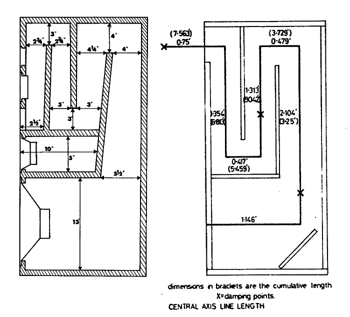

There are actually 2 versions of the Rogers Pro9 TL... the 1st a 4-way published in HiFi Answers (which i have a pdf of) and an "improved" 3-way done for Falcon Electronics.
Neither is reallybig enuff to get the most out of the driver.

Here is your starting point... the Classic TL Revisted. <http://www.t-linespeakers.org/projects/vProjects.html>
It is very much aimed directly at the Radford/IMF mold. Uses the Seas 25F-EW* if you aren't just bunging the World Design 2-way Kit into it (i wouldn't)
<http://wduk.worldomain.net/acatalog/wd25ahfw1a.html>
<http://wduk.worldomain.net/forum/showthread.php?p=37643#post37643>
*(looks like the have gone & discontinued that one now... my guess at replacement is the CA25RE5 <http://www.seas.no/images/stories/vintage/pdfdataheet/h0250_ca25re4.pdf>, but there are 3 candidates, i'm checking with Scott to see which one best fits)
Personally I'd treat the woofer, and then -- depending on budget -- use a modified Fostex FE127e or FX120 (or if you have a BIG budget, F120A) as mid or mid-tweeter, and maybe a tweeter on top of that. And i'd biamp to reduce the XO complexity.
You can of course use whatever you want on the top, but given that tweeters these days are much better than the ones available in the day, a 2-way on top (as opposed to the 3-way used in most IMFs) would be the way to go. The easy way to do it would be to go looking for an already well sorted mini-monitor project, and put that on the top -- with the woofer underneath you'd want to pick one that by itself is bass deficient, but superb in the mid/top.
XOs i'd push down to 200-250 (nominal baffle step on these is going to be ~250 Hz) and use a mid that gets the HF XO up to at least 5k. Done right this should outperform any IMF currently still alive, but retain those things the IMF does so well.
If 1 10 isn't sufficient bottom (it was for IMF, but not some of the Radfords), you can double the cross-section of the line, and mount 2 woofers (i'd make the cabinet a bit wider to push the XO frequency down and mount the woofers on the side push-push).
dave

I am in the final stages of construction of a replica hi-fi answers transmission line circa early 70s.I have made a couple of variations to the original design.Instead of the KEF t27 tweeter i am using the celestion HF1300 but still use the B139,B127 and Coles STC4001G super tweeter.For a crossover i am using cambridge R50.Speaker box consists of 35MM MDF and long haired wool fibres, total weight per box about 60Kg.Also the front was divided into two sections comprising base/mid range and tweeter/super tweeter the reason for this was that if i decide to change any speaker i will not have to make a complete front again and have to go through all the cutting out and rebating process again.

Bad idea. The spacing of 2 is way too far apart at those frequencies to avoid combing. In the Ditton this causes a muddled HF (the HF1300s don't get anywhere near the midrange)
You'd be streets ahead to just replace the tweeters with a single modern tweeter -- even a modest modern tweeter can handily outperforn the tweeters of the day.
