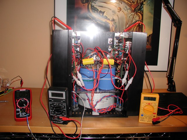

I have the exact same speakers - Maggie MGIIIa - and love them. I have had many friends offer much more than what they go for on Agon (~$600 - $800) after hearing them. The wife even likes them - she said they have an Eames look to them. I guess a nice Eames Loungechair would look slick in front of maggies, but an original would be well over $3000. I'd rather spend it on audio stuff...
I currently have them driven by a Pinkmouse Krell Clone KSA-50 using Stuart's Chassis in his pic (the bigger of the three - many thanks Stuart!).
Anyway, the chassis has four monster sinks bolted together to drop, what I calculate, 235 watts per channel (Re - .65 ohm, +/-39VDC rails, 1 amp/device bias, 3 pairs of 2SA1943, 2SC5200). Tranny is a 1250VA and total of four 56,000uf power supply caps.
With these parameters, I am calculating around 72wpc @4ohms. The heat sinks get warm, but even in the summer months in my basement in Utah only really got to 45C - 48C (115F - 120F), and two of the heatsinks do not have output devices bolted onto them - but they do conduct from the adjoining hot sinks...
I always thought the more power the better, but these sound just as powerful at 72 wpc than my UCD400, which is 400 wpc @4 ohm. It could be the over sized tranny and PS cap that make it feel much more powerful.
