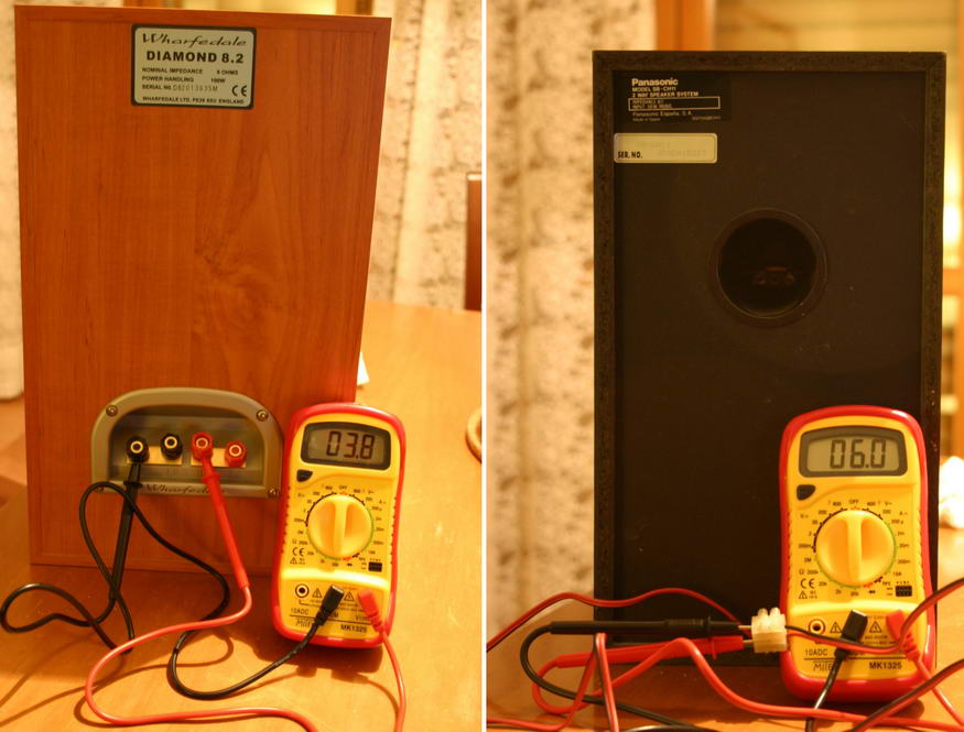

Dear all,
I tryed to measure the impedence of my Diamonds 8.2 loudspeakers using a multimeter and I measured 3.8 ohm on both the loudspeakers (even if they should be 6 ohm).
My question is: is it normal having 3.8 ohm if the label of the loudspeakers says 6 ohm? Is there a way to check if the loudspeakes is working correctly or if it has some problems?
In my opinion, it's very strange to have 3.8 ohm when the loudspeakers should be 6 ohm. In addition, I have other 6 ohm loudspeakers (Panasonic) and, as you can see in the attached images, I measured 6 ohm exactly (in fact, using the Panasonic loudspeakers I don't have any protection problems).
Please, have a look to the attached image. Wharfedale is on the left, Panasonic on the right.
I'm looking forward to reading your reply
Regards
When you measure with an ohm meter you are measuring the
DC resistance. In speaker terms this is called re. The re for a speaker is almost always a lot lower than the rated impedience for example for example using an 8 ohm JBL 2123H. This 8ohm driver will measure 4.2ohms when you use an ohm meter because this is the DC resistance. The 8ohm rating is a nominal AC impedience, the combination of this DC resistance and the inductance of the voice coil this varries a lot with the frequency.

"which is the reason why the ampli go to protection mode?" - the amp can't handle the low speaker impedance, you've proved that comprehensively
"it seems a problem related to the both Wharfedale loudspeakers" - no, it's an amp problem
Either change the amp, have it serviced (in post 3 you say the problem is only in one channel?), or use higher impedance speakers.
What amp is it?
