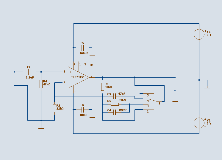

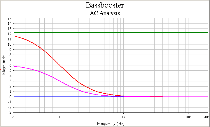

Bass Boost, with 4 booster options
Bass Booster
to be used to attach AFTER the phono RIAA.
You have a rotary switch ( use 4 postions of one 6 pole )
- Pos 5 = Flat +12dB gain, Green curve
- Pos 4 = High Bass boost, Red Curve
- Pos 3 = Low Bass boost, Purple curve
- Pos 2 = Flat 0dB, Blue curve
My own fresh custom designed schematic, comes in next post.
Bass Booster

if you need more than +12 dB bass boost
of course I can try do circuit for this, too
