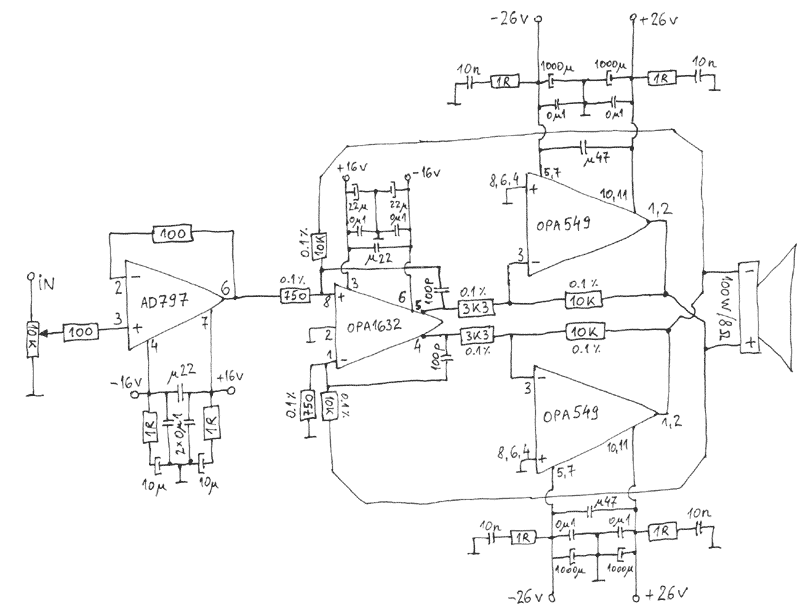

Hi Folks i guess this is an duble post but maybe someone in the Pass Labs forum can help me ..

So what can I make of this ?, i have been thinking of a 5CH amp but i cant find any circuts that i can use my parts in.

Nelson Pass said:Sounds like a nice +/-30v power supply. You can build a hot single-ended
Class a amplifier with that and those N channel devices.

juma said:Hi valo,
you can use those OPA549 in something like this - great bass (and not only):

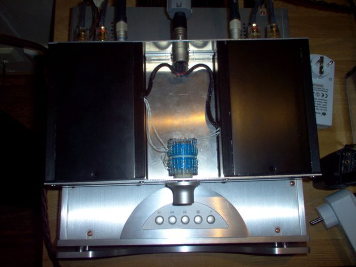

I have never tested opa549 as an audio amp, but i have made alot of opa541 "gainclones" and i like the sound
my last 541 amp did look like this..
