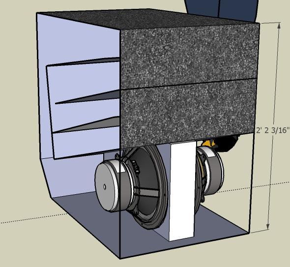

Samuel:
How about this configuration...
craigwalsh, your configuration looks very promising. I installed Hornresp on my PC only last night. I need to learn how to use the program. So I'll try and make some sense of what you have posted.

craigwalsh said:
Samuel:
That is a variation of a TH that I built. The only problem I see is the woofers are not configured in push-pull. This means that the non-linear suspension components will not get canceled. However, due to Sd being 2X I would say excursion should be greatly reduced anyway. I'm just saying if you are going to the trouble to build a double woofer TH you might as well go all the way and cancel non-linear distortion while you are at it. As an added benefit, I find that the chamber volume can be useful to flatten the response sometimes.
My double TH --> http://www.diyaudio.com/forums/showthread.php?postid=1627597#post1627597
Rgs, JLH
From my perspective, this is pretty similar to the LabSub in that it's feeding a small volume throat, with roughly a 3 or 4 to 1 compression ratio. But, using push-pull might help to reduce distortion. The problem is in fitting that into a small TH. I still need to work on modeling this to find the right drivers.

CraigW, I was thinking about that too. I figured the box would get too big. For a moderately loud band that type of arrangement might work but I'd separate the two drivers from each other at least in the first stage. My thinking is: instead of having two drivers pounding away at each other directly, isolating the first stage or two and combining the two at a later point in the horn might take destructive pressure off both drivers. I'm thinking that high pressure at the driver and first stages will prevent damage.
Think like headers on a car, the idea is to time the exaust ports such that they are all about the same length resulting in smooth flow down the exaust pipe. I could be wrong.
While it's a pain to carry more boxes, it's safer for rental work.
If a driver fails out of 4 you disconnect it in seconds and keep going (Captain, weeve only gut thrree qwarters impulse but I think she'll hold).
With double cabs, if one driver fails in show, the whole cab is down. (Damnit Jim ,I'm an engineer not a Magician!).
A funny thing happens to horn loaded speakers as they age, the cones explode. The same pressures that help the box get louder also rip the cones apart if they get wet or dry rot. Too much compression is a bad thing.

Actually, if wired in parallel, the dual driver box will still perform if one driver dies. But, then it will be way out of alignment! I agree with your sentiment. The other advantage, at least with typical bass horns, is that you get constructive coupling at the mouth area. I'm not sure if that works with TH's though.

JLH:
Yes, your TH looks very nice. I bet it must sound pretty good! I'm trying to get this one into a line length of somewhere between 3 and 4m to get reasonable extension to the mid-30's. As a bass player, I'd like to get some of my 5 string's B string fundamental (about 31 Hz). But, I'd also like high output and a relatively small box size. I know, this is too much to ask. One of those 3 criteria must be thrown out.
