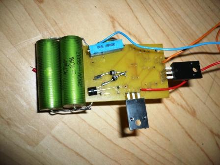

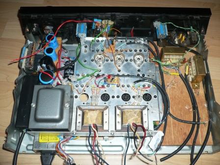

And the innards:
- Brass sleeved trafos are the Dave Slagle OPTs for the BDT (nearly as big as the original Rogers Cadet III OPTs (from which this whole chassis is extracted)
- The black box to the left of the PS trafo is a 12V SMPS for the CCS supply to the BDT tube heaters.
- One 250V voltage Reg (ala John S) is seen on perf board stuck to the inside of the front panel. The other 130V VR is to be mounted yet. Other little perf boards are

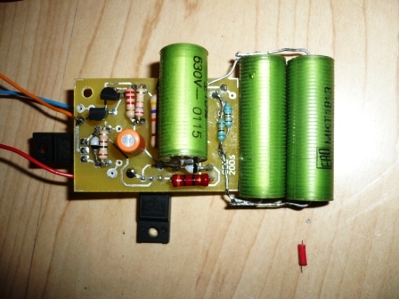

- one CCS for both BDT tubes (at the front of the case)
- two CCS boards for the diff input to the Baby Huey
Part of my slowness with this build was trying to fit it all into the Rogers Cadet case - an impossible task which I finally gave up on when the Slagle OPTs arrived (much bigger than I anticipated)

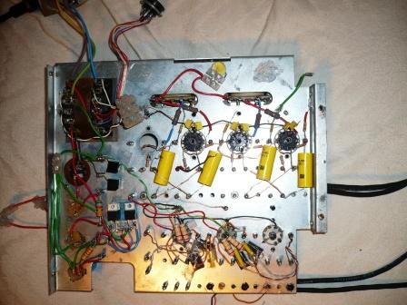

Underside of chassis - in a disconnected state. I have lost one tube socket of the four in the Baby Huey section (broke too many pins & had to pull it). Also this section is in flux so ignore the wiring.
The part nearest the viewer is the front of the chassis & I've used two of the 3 tube sockets for the BDT preamp
