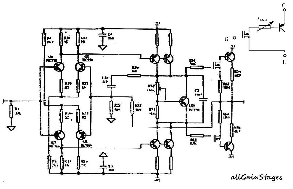

looks like it will work well
maybe even be very good
.. depends on your used transistors and current levels
2 resistors serve no good purpose:
those two at most far right = from POWER Transistors collectors.
The only thinkable purpose, that they may do,
is to reduce Max Output current = some protection.
Other wise these 2 resistorswill only make output stage
work more BAD
Lineup regars
