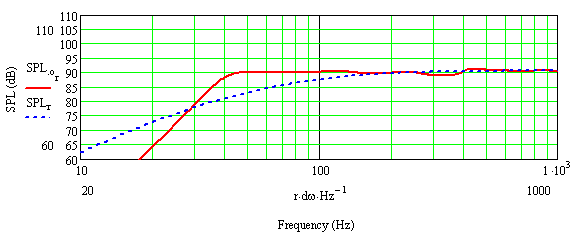

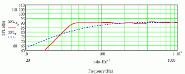

OK, box for the CO8V, & assuming the claimed parameters are accurate (cough), here's an MLTL to chew over.
48in x 12.5in x 5.25in (internal HxWxD). Zdriver 17in, Zvent 44in, Vent 3in diameter x 2in long. Line top, back & one side-wall with 1in acoustic fiberglass or stuff 0.45lbs ft^3 from the top 30in down. It will also go straight into the Chang or Half-Chang cabinets.
