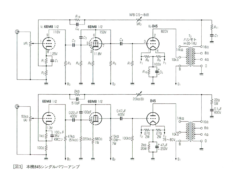

Found this online and was wondering if it was a good design. The B1 is 860v, B2 410v and B3 is 176v. The PSU is really complicated so I used this as an opportunity to practice my PSUD II skills. The amp itself is simple enough so I thought it might be worth looking at.
http://www.tube-amps.net/images/How_Hashimoto_Sounds/845_Signal_Pass_Schematic.jpg
I would think that the purpose of using an 845 would be to get an absurdly powerful SE amplifier.
Running B+ at 860V would be throwing away a lot of potential power. Personally, I'd go for more like 1000V if I were to build an 845. You can make a lot of power at that voltage, especially if you can drive the grid positive.
Why use an 845 unless your goal is to shake the walls? If that's not your goal, then a smaller tube would be better/cheaper/safer.

I sure wouldn't waste an 845 on a design using the mediocre 6BM8 as a driver, and with global feedback to boot. Properly designed SE amplifiers don't require global feedback at all.
Do you really need the power? Designing and building an 845 amplifier that sounds anywhere as good as many of the smaller dht based amplifiers is a serious enterprise and I doubt this design will get you anywhere close.

Do you mean in terms of driving an 845 or just overall? A 6BM8 is good for a few watts SE so it should have enough 'oopmh'.
I mean linearity and overall sound quality... The 6BM8 is great for small cheap SE amps, but given the cost of building a good vs. mediocre 845 SE amplifier it's not a good choice. Just my opinion which is worth about :2c: YMMV..
Don't like it. In the first place, 800Vdc isn't enough for an 845. These puppies like lotsavolts. I'm doing an 845 SET design with the Vpp= 1100Vdc. That'll really make 'em rock.
I also don't like the driver. 845s like to pull grid current even before Vgk actually goes positive. It's long been a problem with this type. To take care of any grid current demand from that, or the high rising transient that'll exceed the grid bias, I like a MOSFET source follower. DC coupled, it can also help set the Q-Point plate current. With a low distortion front end, the 845 will perform a good deal better.

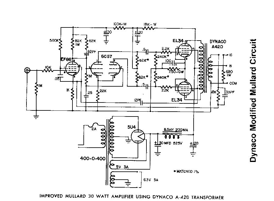

Or
This one. The only issue I'm having is that every schematic I find has a thread here where someone I respect tears it down, including this one, and the next one. I kinda wish I would have found a schematic that made everybody say "wow thats great!" But when that happens on Diyaudio is the day I...well its so weird I don't know :)
I was also looking at the Williamson, but then when I researched it seemed like most felt the available schematics needed modification (read a thread where SY when into this) even though I'm learning, I guess I'm just lazy in wanting a schematic thats ready to go. At least I can cobble together PSU's and source my own parts now and know what most those parts are for, mostly :)

astouffer said:
Build something from a stock schematic at first to get experience and then modify if necessary. You're right about never finding a schematic that everyone would agree on. The two you just posted are fine performers. Whats important is how the amp sounds to you.
I'll buy that for a dollar.
You payed for it, you built it, and if you don't like the way it sounds when it's done mod it.

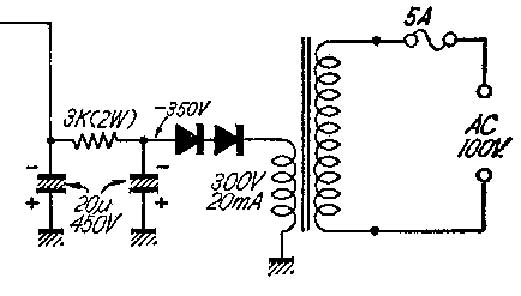

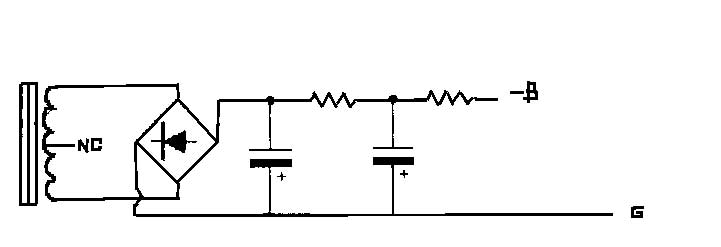

Ok, let me se if I got this straight.
How about something like this. For example one 6D22S damper diode reversed, one leg of the transformer to ground.
Question 1, I assume I can work out the Transformer/resistor/cap values as if it was a positive half-wave rectifier using PSUD II.
Question 2, if the winding had a center tap I would just leave it unconnected.
The other implementations had both legs of the transformer going to the anodes of a full-wave rectifier, the 5v heater going "nowhere" ie not the usual b+ rail. And the Negative supply comming off the center tap. The assumption from question one would still apply. What low current rectifier would you use? I assume that the 5u4 would be an overkill.

My thoughts would match Yves pretty much exactly, but I would put even more emphasis on the cathode bypass cap - there is no cap like well, no cap. It is impossible to build completely transparent sounding caps in the value required to do this chore.
I also strongly recommend against using tube rectification for bias supplies - if the rectifier fails for any reason you will loose the output tube and possibly the output transformer and your HV supply as well.
Tube rectifiers are great for their slow warm up (depending on type chosen) and their soft rectification characteristics, however mundane a ss rectifier may appear to be in this application its simplicity and ruggedness make it the best choice. I use tube rectifiers in all of my designs except in the bias supplies..
Not a bad idea to interlock the HV supply to the bias supply - no bias means no HV applied to the output tube. I use a simple circuit to sense bias is present and use this to energize a relay which either switches the primary of the HV transformer or the CT if the transformer is used for other purposes.
